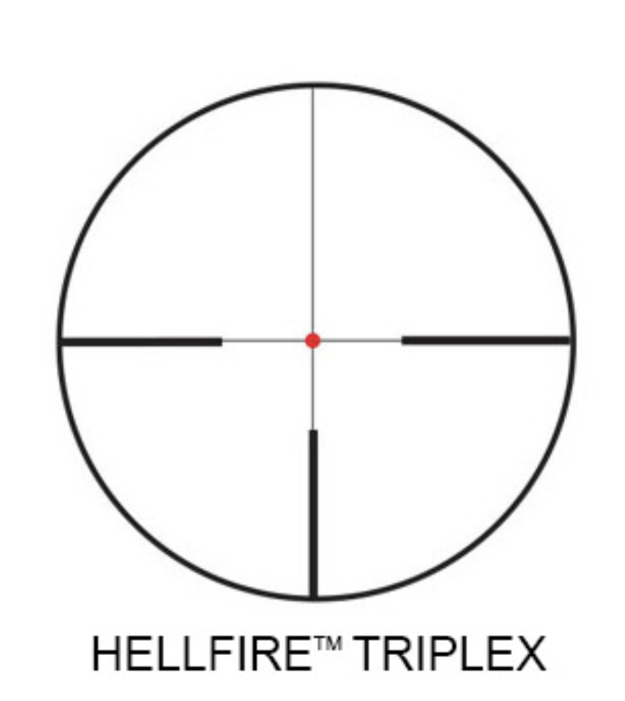

I've been looking really hard at the Meopta Optika6 2.5-15x44 scope that cameraland has on the clearance page. It's a SFP scope, and it looks ideal for a hunting optic with the clean reticle and the red dot center. My hang-up at the moment is that I don't have a rifle in mind for this optic, so I was curious if any optics experts could weigh in on what calibers might match the reticle. Specifically, with the given dimensions of the reticle, what round would most closely line up with the subtensions out to around 500 yards? Or is this question asking too much without testing it out on a specific rifle? I'm trying to justify purchasing this scope since Doug has such a good price on it, and if somebody has actual experience or happens to have ballistic data handy that lines up with this reticle, that would be great. Thanks!

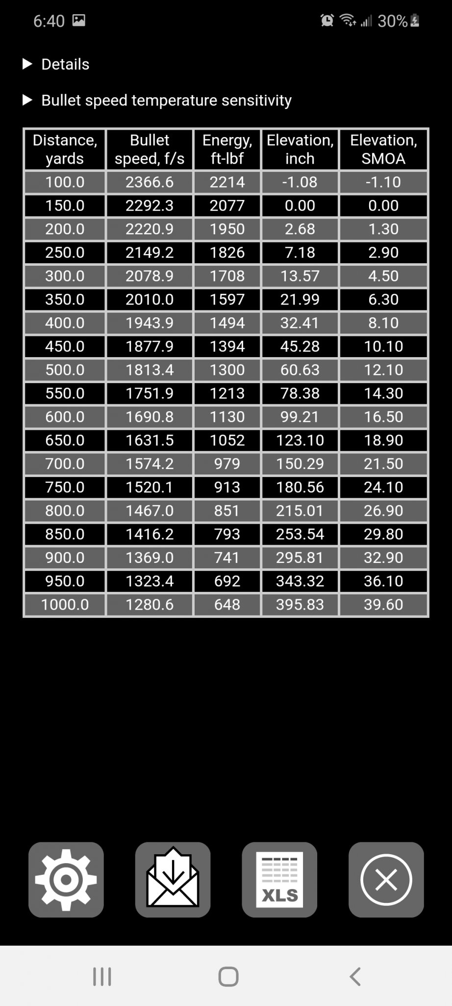

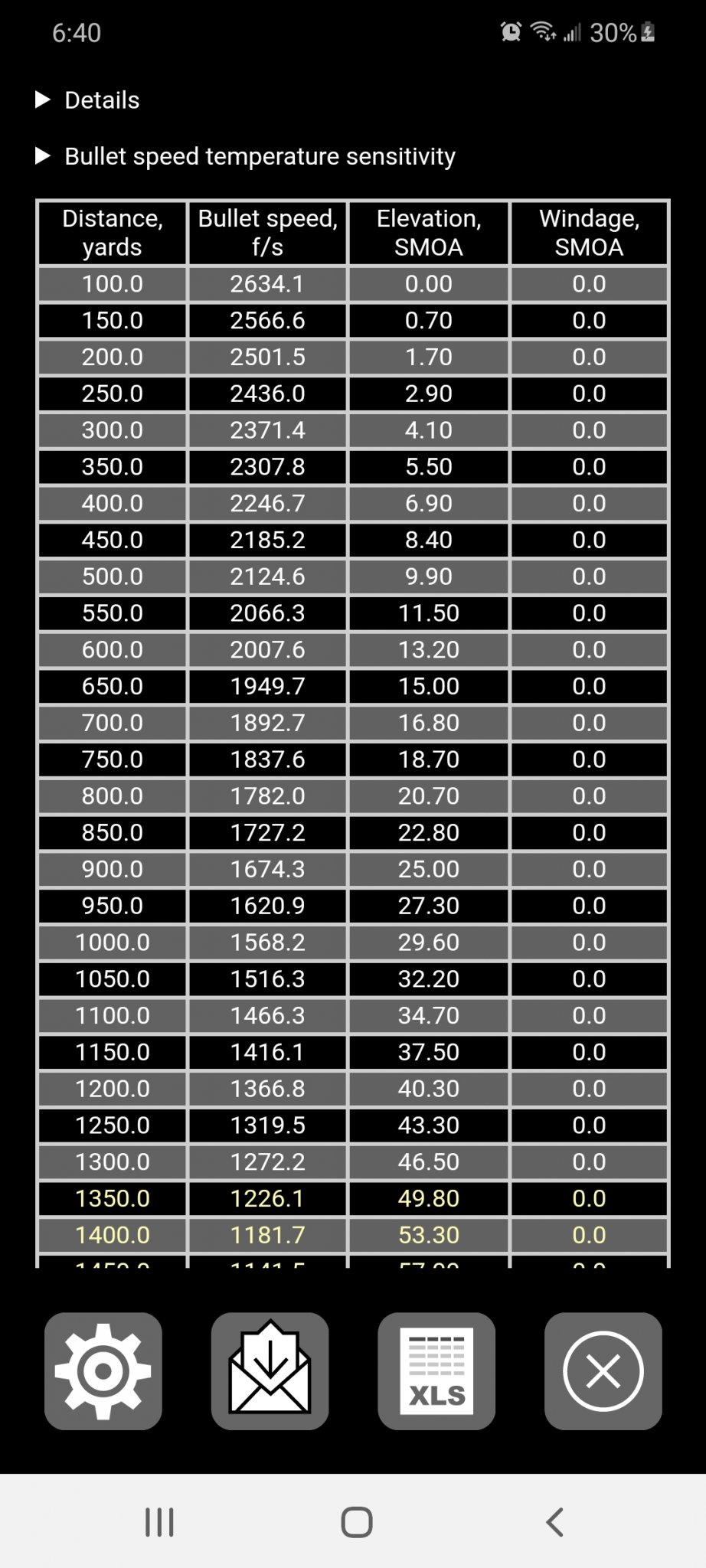

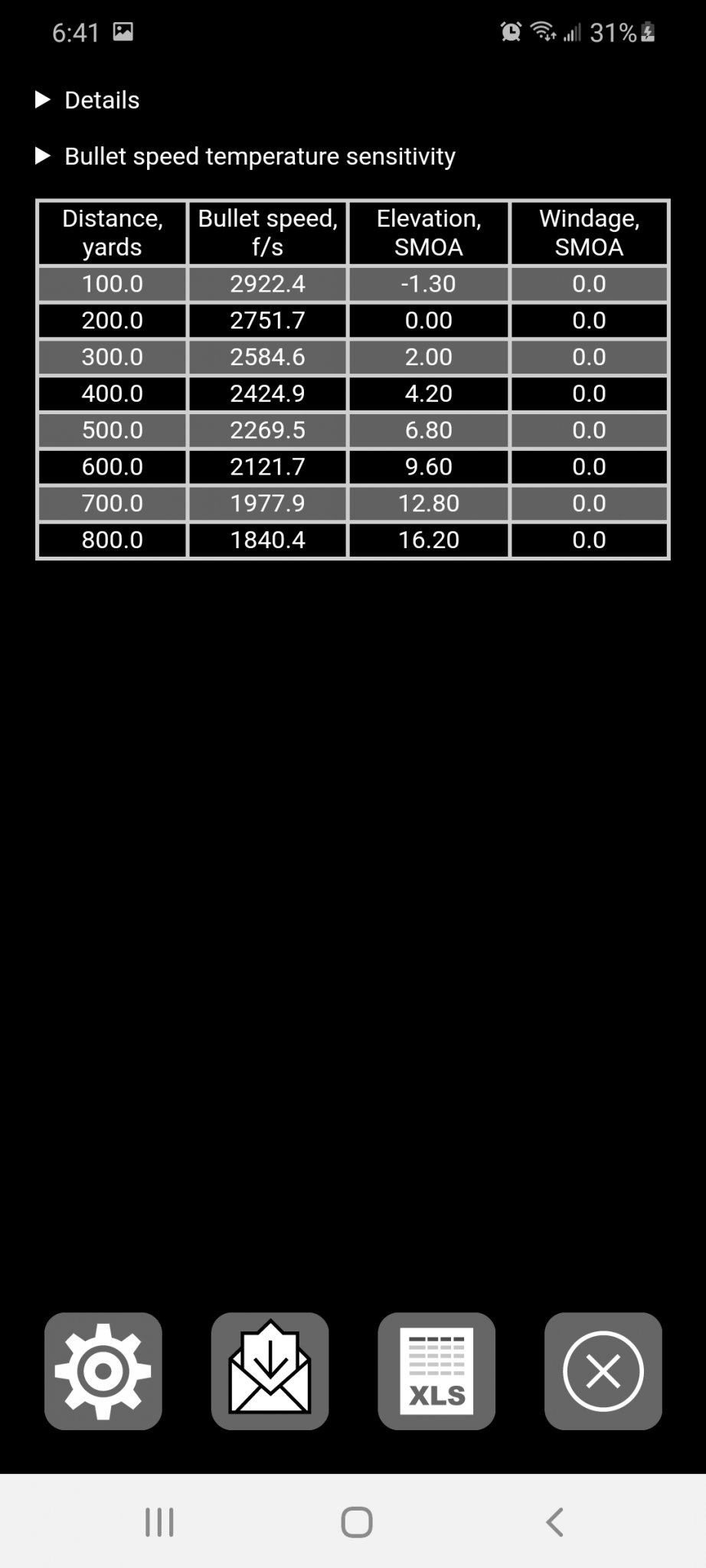

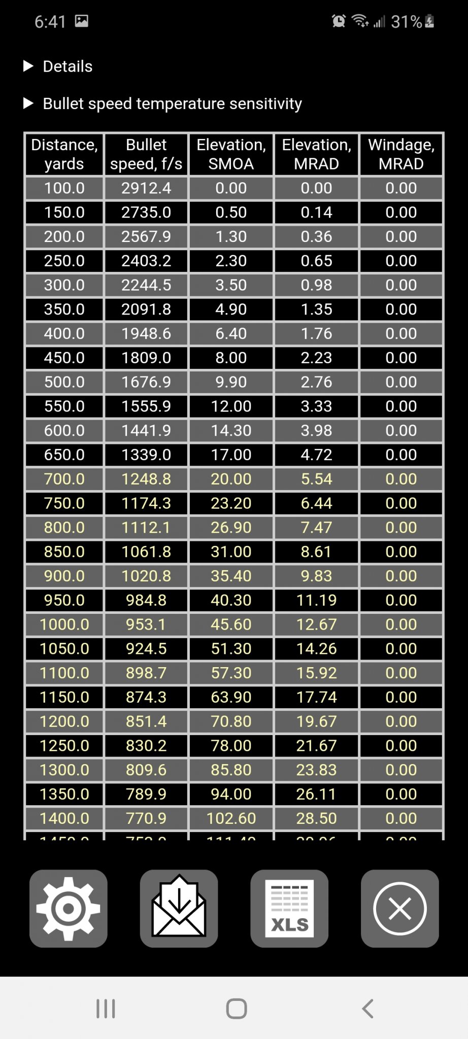

Here are most of mine from strelok.
6.5 cm, 143 eldx
308 win, 178 eldx

The bottom of the circle should be at about 2.5 moa, too. They say its designed for a 223, my chart above is with a 16 inch barrel and pretty minimal load development, so you could probably dial it in better to line up.

Thanks for the tables! The 6.5 CM data looked to follow pretty close to the reticle holdovers. Really appreciate you taking the time to post that.

I am not saying SFP BDC reticles can’t be effective I had a Nikon Monarch with a SFP BDC reticle that I took many deer with. For me I think the perfect hunting reticle is something like Sig’s Hellfire TripleX in a SFP scope with MIL or MOA adjustable turrets. No clutter, don’t have to worry about what magnification you are on, can be seen pretty good on low or high power, single red dot for illumination. Range your animal, dial your elevation and or wind, place dot where you want bullet to go.
