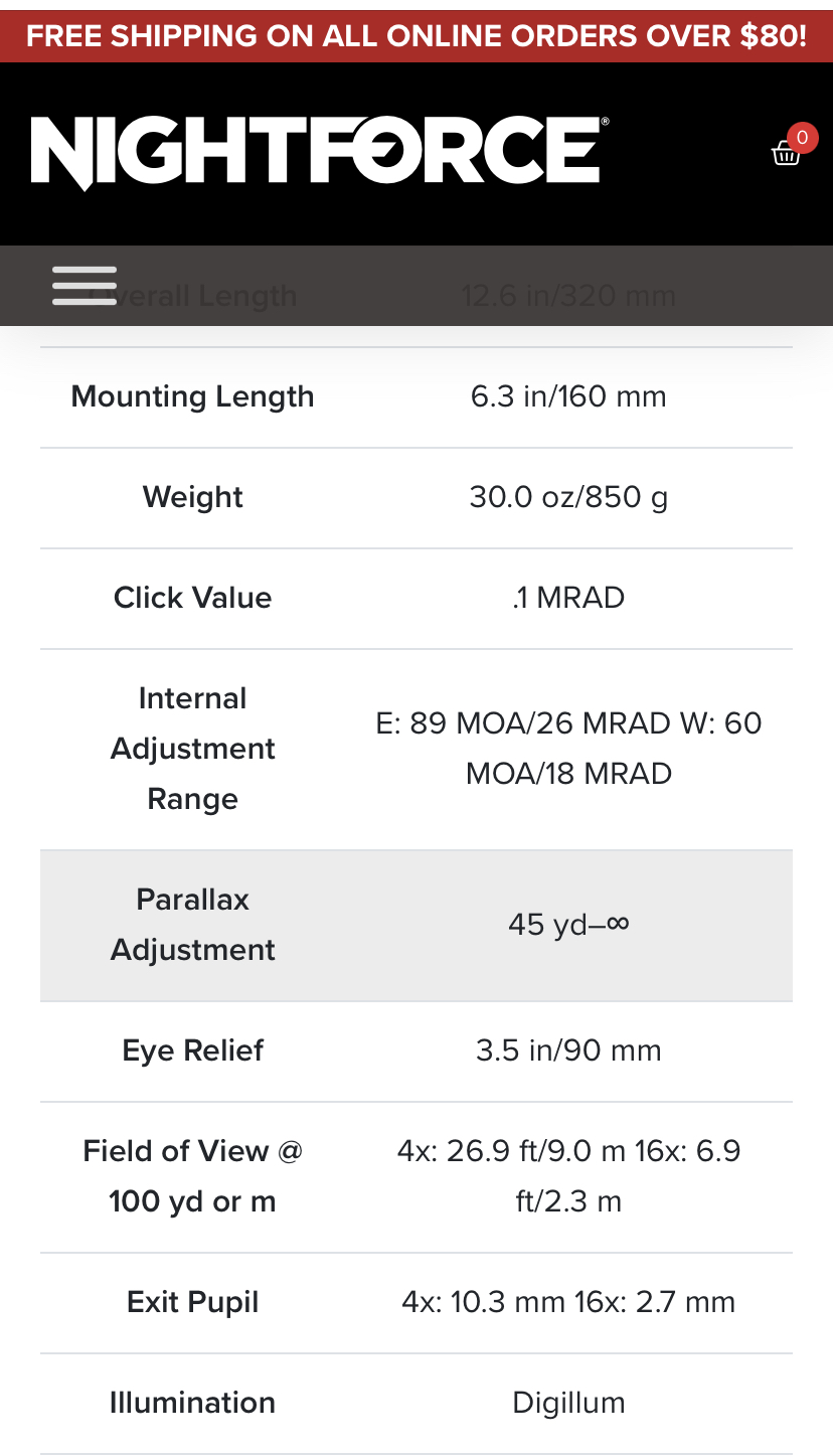

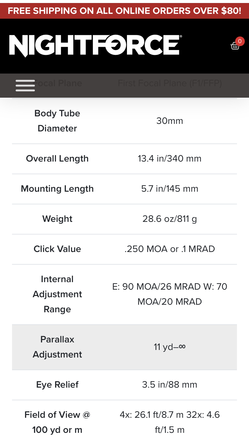

When looking for scopes and how close you can clear up an image, check the specs for the parralax adjustment range. The ATACR you have listed only has a minimum parralax range of 45 yards.
The Nightforce NX8 4-32x has a minimum parralax of 11 yards so that might be a better bet for what you're doing.

Burris XTR3, NX8, Athlon Eres 3-18x50 all focus to less than 30yards.
The latter two focuses down to 10yards.
I have browsed half of the Internet reading through NX8 reviews, and I must say I'm not confident spending that much money to a scope with such a wide base of not happy customers. Naturally it's easier to bash than to praise, but still, compared to many other scopes in the same price range, NX8 seems to receive a lot of.. not hate but.. disappointment?
Otherwise that 2.5-20 would be perfect with its super close parallax.. it's just that I have no option to try before I buy..

There are few scopes I can get my hands on for pretty OK prices, like Nightforce ATACR 4-16 F1 and Steiner M5Xi 3-15x50. Both would cost just under $2500. Maybe I just have to let go of my "trainer rifle" idea, and buy some less than stellar crap for the rimfire.
But before I give up, one more question:
Nightforce SHV 4-14x50 F1 has parallax rating of down to 25 yards. Anyone tried this one, would it work any closer.. ?

I have a Nightforce NX8 4-32 Mil-XT on my air rifle and I really like it. The parallax adjustments are forgiving so it’s easy to focus in on targets closer than 100 yards quickly. I bought the rifle setup to shoot in my yard since I only have 6 acres and neighbors which makes shooting centerfire and rimfire too risky for me. I can get out 100+ yards with it and I have been impressed with the turrets thus far. Not the clearest glass and it’s definitely a step down from the 7-35 ATACR but well above my Vortex Strike Eagle.

I'm aware of the opinions about the NX8, especially the 2.5-20. Still, I own two 2.5-20s, but no 4-32s yet. The depth of field is smaller with the NX8s. I haven't had this hold me back, to my knowledge. My summary on the NX8s - and the reason I own these - is that they do lots of things well. My own limitations certainly hold me back more than the scopes do in the areas where they are less than perfect.
The ATACR 4-16 has a very forgiving optical presentation that makes it superior in glass performance. This is why it's my favorite scope and on a gun that I want to be most flexible in use.
Overall size between the 2.5-20 and 4-16 is so similar that it shouldn't be considered unless you want to put the 2.5-20 on a long action gun. Mounting length is more generous with the 4-16 (as well as the 4-32).
