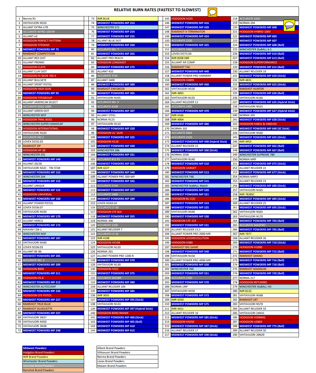

    Started this thread to spread Information and share data/information on Midwest Powders. So what Midwest Powder are you using what caliber and what are your results.
    Has anyone compared a particular Midwest Powder with is "similar to" type, how close was it?

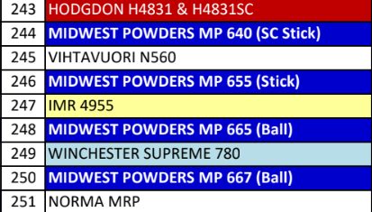

    Bought an 8 Lb jug of MP636 that was advertised as being similar to N555 in february. Played around with mostly in 22GT but also a bit with .270 Win. About 100-125fps slower than N555 with a 35 gr charge and 88 ELDM in 22gt.
    Did some testing against H4831SC and H1000 and its about 40% of the way from H831SC to H1000 looking at velocities. This sent me on a wild goose chase trying to figure out what powder was being rebranded here until I took a much closer look and found a small amount of ball/flattened ball powder in it as well and reaized it was likely a mix. Looks to be primarily a mix of some VV/RL powder with a bit of some ADI yellow powder kernels.
    I'm curious how other approach load development with these midwest powders when there is a somewhat significant different in advertised comparable powder and actual results. Not thrilled its a bit off but it seems consistent with good accuracy. Just worried that if I look at it from pure velocity numbers and split the difference between H4831SC and H1000 min loads to start with, I may still be in dangerous territory since velocity isnt always a true indicator of burn rate or pressure.

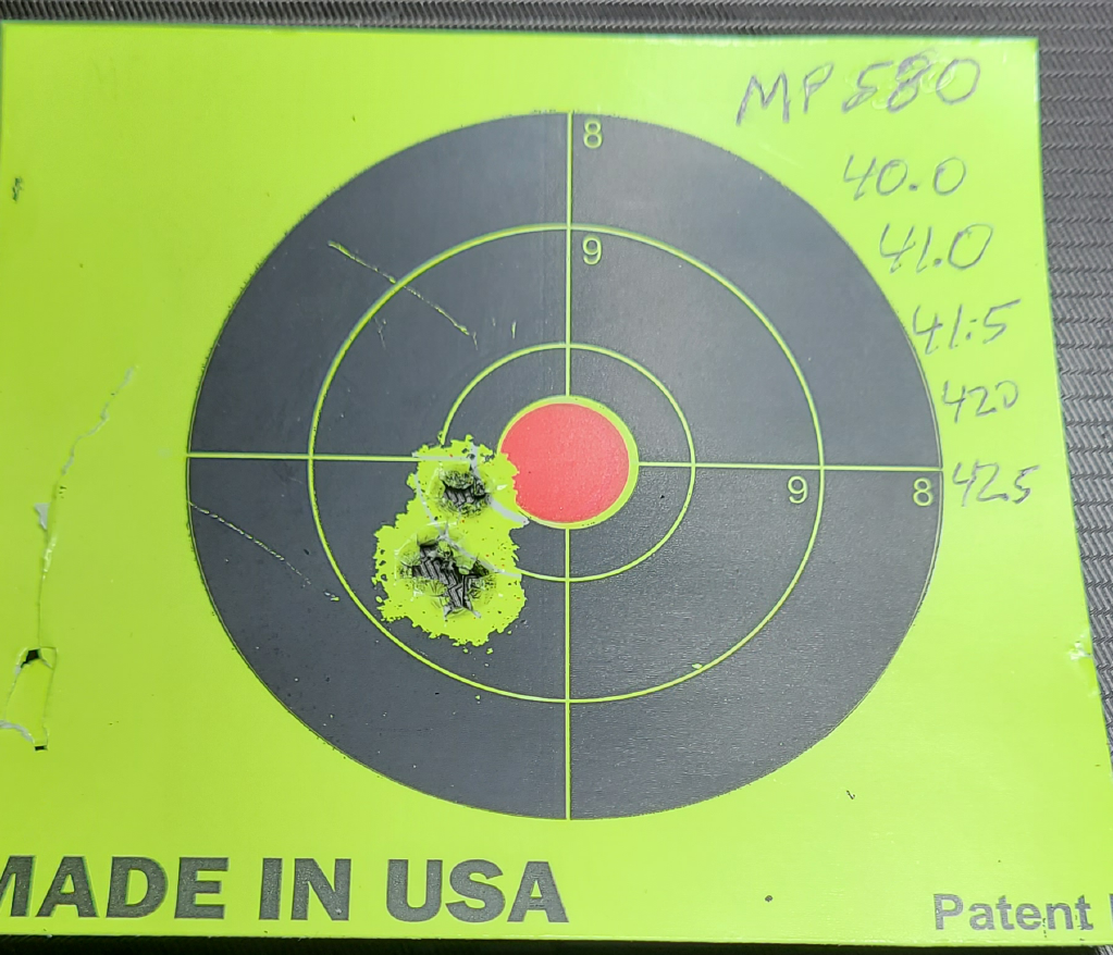

    I loaded 5 rounds of MP580 similar to IMR4451 to get some sort of baseline on where the velocity numbers
    fall. Rifle is a 6.5 creed barrel is a Kreiger with over 2800 rounds through it and although it has slowed down
    it still shoots fantastic.
    Tested 40.0 41.0 41.5 42.0 and 42.5 grains of MP580, 140 ELD, Lapua case and CCI 450.
    All 5 rounds with different charges went into a .401 group with 4 grouping into .195.
    The velocity numbers that my labradar recorded are gone due to some issue with a USB to SD card adapter
    that corrupted the file system on the card but I remember the velocity of the 42.5 charge, it was 2764 FPS and
    no signs of high pressure were encountered. Annoying loosing the data.
