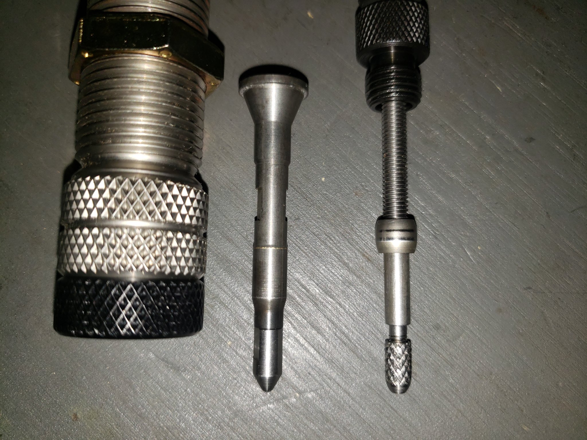

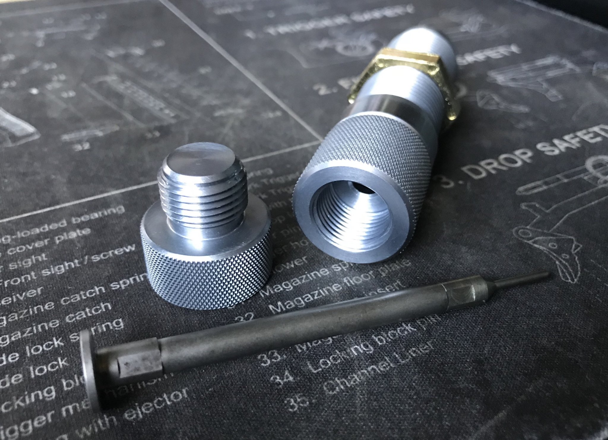

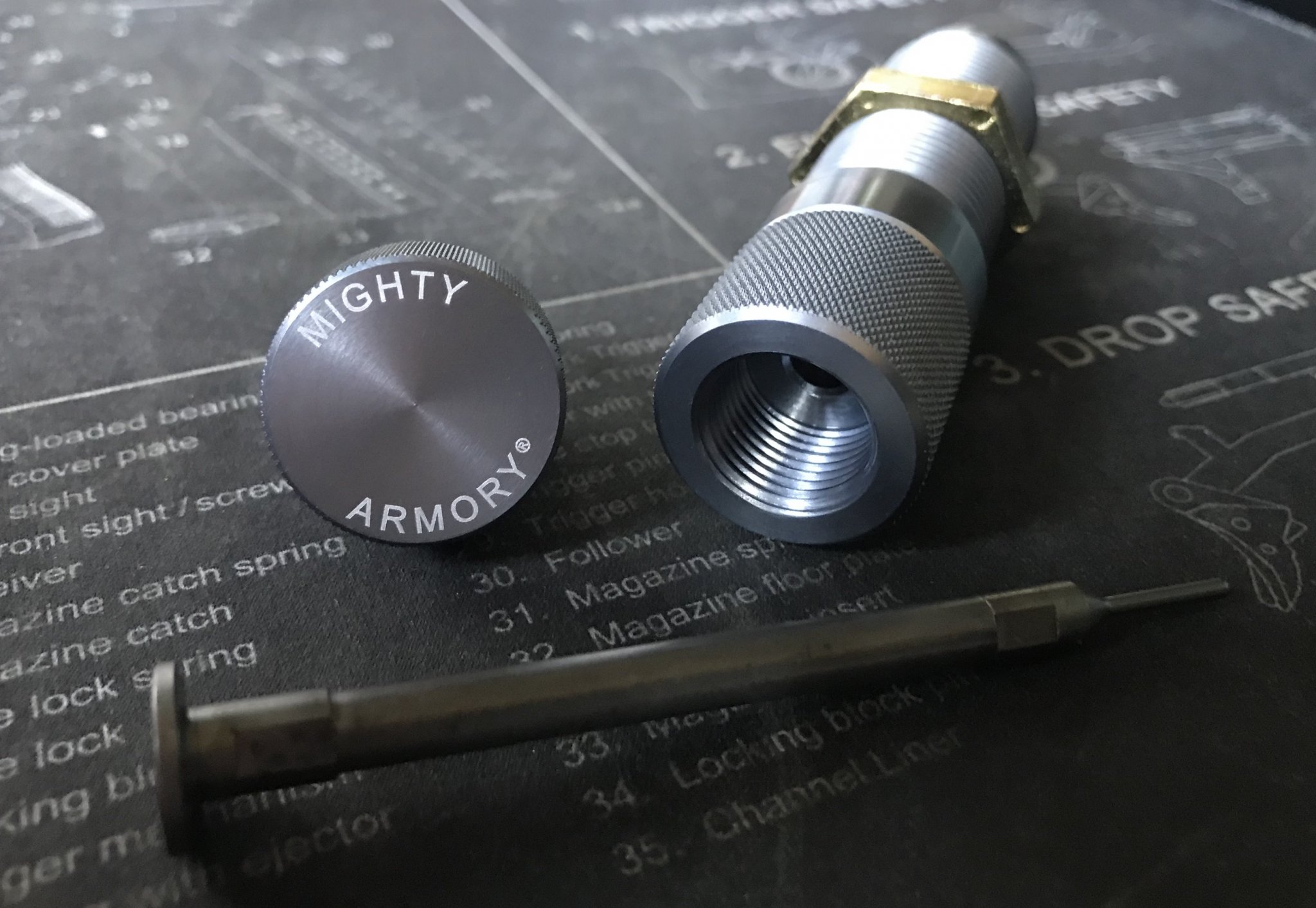

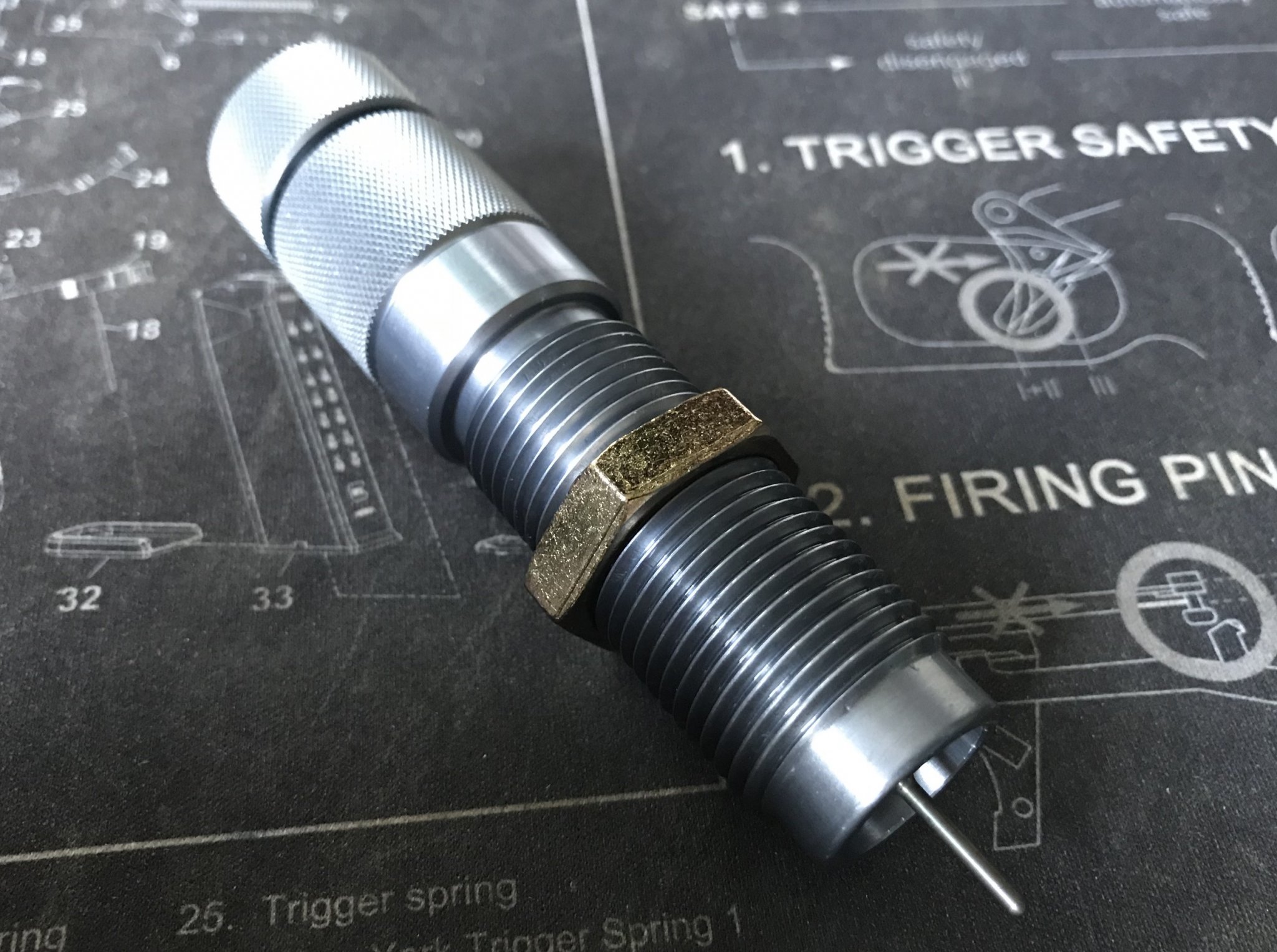

Hey man I have a 6.5CM and .308 FL Mighty Armory sizing dies. Wayne has put in ample time, math, into the engineering of these products. If you ask him he will send you a Lapua SR decapping pin for your die. With the MA FL die there is no need for a expander mandrel. Using the die is like a hot knife in butter. The expander...... it over engineered in the best way

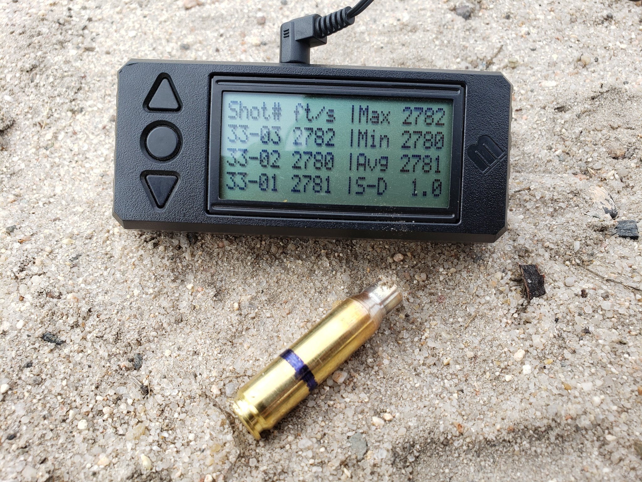

Here are a few photos of the .308 in work
Peterson Cartridge LR
X3 Firing
Yes that is 3 shots. I shot another 10 rounds with minimal increase in numbers
Chargemaster Lite
Once I get the 6.5CM results i will post

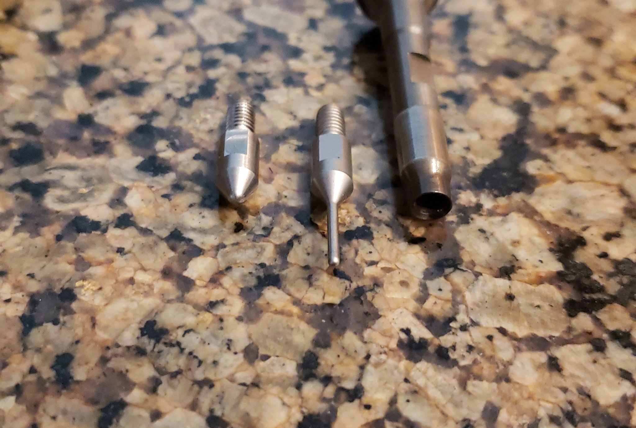

Wayne is a good dude. I've spoken to him many times, I have 6 of his decapping dies.. he's sent me each new pin hes created. I'm using his latest that will not bend, you can punch through brass with them. Some magical knife steel isn't what makes them so strong....its the heat treatment as Wayne explained to me.

Why is that guy pushing a stupid looking decapping die?
Judging by the coupon code, he's getting a kickback.
It looks dumb, and it's super tall, but it works alright. I'm not totally sold, since it did punch a second flash hole in one of my 6BRA cases. I thought it auto centered, but I guess it doesn't work 100%.

I have known Wayne (Mighty Armory) since 2018, back when I was running the ammo processing portion of the local machine gun range's ammo plant. He's a good dude, and knows his stuff. He makes a hell of a product. We ran his dies in autodrive presses all day everyday. I've also personally been using his Magnum 100 decapping die and Lapua version since 2018 as well. Love them! My RCBS decappers collect dust. The MA die is just superior in literally EVERY way. I did use his .223/5.56 die at the ammo plant for a while. VERY early prototype run. Solid product, as well. 👍🏼
