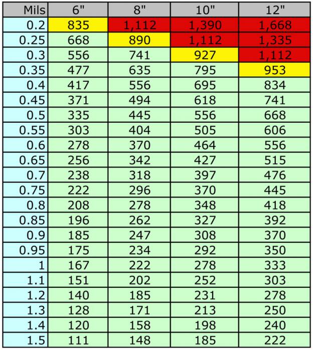

The metric system is decimal, and only one unit of measure for distance is used, the meter. One milliradian is an angle which subtends an arc whose length is 1/1000th of the distance, so using meters and miliradians is VERY easy, fast and intuitive. One mil = 10 cm at 100 m, one click 1 cm at 100 m, etc. And the "fast and dirty" top of head to crotch distance is one meter, so it subtends 10 mils at 100 m, 5 mils at 200, etc.
The US customary system is fractional, and you use inches, feet, and yards (1 yd = 3 feet = 36 in). IF someone used yds and its decimal fractions for all measures, it would be the same as using the meter. But no one measures the size of a head in feet or yards, inches are normally used for smal objects, feet for stuff such as car lenght (or worse, X feet + Y inches), etc., and yards are normally used only for distance. This introduces a calculation constant in every calculation made.
As explained by TiroFijo, if you are "milling" or ranging a target then mils are easier, if you are gonna think it about it.
However there are other ways to skin a cat. Nobody says you have to do the math on the spot, prior proper planning and all, besides how much "mil'ing are you really doing". Its a legacy skill and even in most competitions its one or two stages out of a 20 stage event. You can accomplish the missions without a calculator.
For shooting, what is the difference if you dial
12 MOA for a target at 500 yards
or
3.6 Mils for a target at 500 yards
It's exactly the same thing.
If you want to range, I suggest building a chart which is 10x easier and requires no math. Fast the reticle on the target and then use the chart. No thinking, just reading.
Or use a Laser, if the range is 488 yards, the answer is no different, your dope is your dope, mil or moa, although Mils are much easier to remember as the numbers are much smaller.

To show how wide spread the problem is, I took this to the RimfireCentral forum and 90% of the responses were people that didn't see it as an error.
This is no where near as complicated as you guys are making it. A mil is a miliradian - a measurement unit for angles. A MOA is a minute of angle, another measurement unit for angles. They do precisely the same thing. It's like inches or centimeters. Just pick one and use it.
