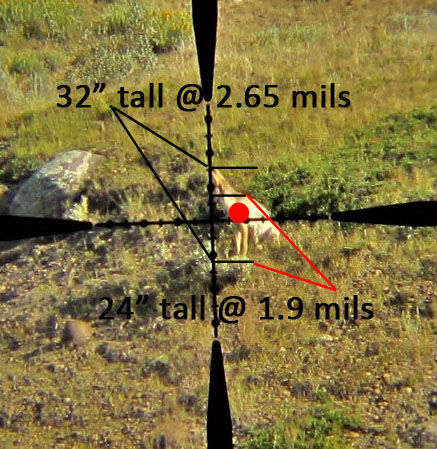

~444 yards.
Average male coyote shoulder height 24" (from google anyway), looks to be 1.5 mils.
In meters:
~400 meters
(60cm shoulder height, x 10)/1.5 = 400M (math is much easier in metric)
Yeah, I’m sort of w you. About 300 yds.
Figure bit less than a yard long and subtending 3 mil.
(1 * 1000)/3 = 333 but I think a yard maybe a bit too long. We do have coyotes in Maryland, reportedly, but I’ve never seen one.
So maybe even 275.
But I might be reading this reticle wrong.
Is each mark (both line and dot) a mil or are the lines .5 mil?
Inches x 27.77 / mils
Haha. Thank you!! Yeah, 27k couldn’t possibly be right!! LOL what I get for lazily writing a post on my phone from the couch.
At least I did remember 27! Haha
I di find it easier to estimate target dimension in yards (or a fraction thereof) and stick to multiplying by 1k so that’s the one I committed to memory in my very small brain! The math is just more simple for me LOL
Thanks again for correcting my obvious error. (y)

Yep. Mil ranging is not precise at all. To do it properly, you need to account for the high and low end possibilities and use dope in the middle.
Not to mention lighting an other such shit building in more error.
I’d consider mil ranging and engaging a sitting coyote as it provides a good bit of vertical. I’d likely not engage it standing/walking based on mil range as you’re now well outside the error.

Here's my work:
I'm taking some liberties with dimensions but it's a natural animal and this gives me a fair spread. The red circle is a .6 mil wide "kill zone", roughly.
32" @ 2.65 mils = 351 yards
I don't know the exact height of course but 32" seemed reasonable.
24" @ 1.9 mils = 335 yards
We can't see the bottom of the paws so I fudged where I predicted they would be behind that shrub.
Averaged together I'm looking at about 343 yards.
Plugged in for my 6.5 Creedmoor slinging factory Hornady 140 ELD-M's at 2695 fps, my dope for 343 yards is 1.4 mils. As long as the actual target distance is between 310 - 370-ish yards there's a high probability I'm within the .6 mil circle.
Using data from a Tikka T3x CTR pushing Hornady 143 ELD-X's at 2495 fps the same 343 yard range would require 1.8 mils and reduces my margin of error to 320-360 yards give or take.
16" AR -15 shooting Hornady 62 gr Spire Points at 2967 fps would be about 1.5 mils of elevation for 343 yards and gives me a margin of error of between 330-370 yards.
All of those hypothetical calculations assume a 100 yard zero.

I'm getting 315 yds doing it in my head without google or calc. Assuming 1st focal plane & half mil sub-tensions on ret.
I have recently seen Coyotes up close so I do have a frame of reference for size @ about 26" ear tip to toe sitting.

The formula I use is this:
(Height of target in yards x 1,000) / height of target in mils
I shoot coyotes all the time. Coyotes here are big. I give him 36 inches from the top of his ears to the ground. He will be that height standing or sitting.
So, it's:
(1 x 1,000) / 2.6
It's 385 yards, rounded. 20 or 21 clicks up on either of my .308 guns and I own him.
