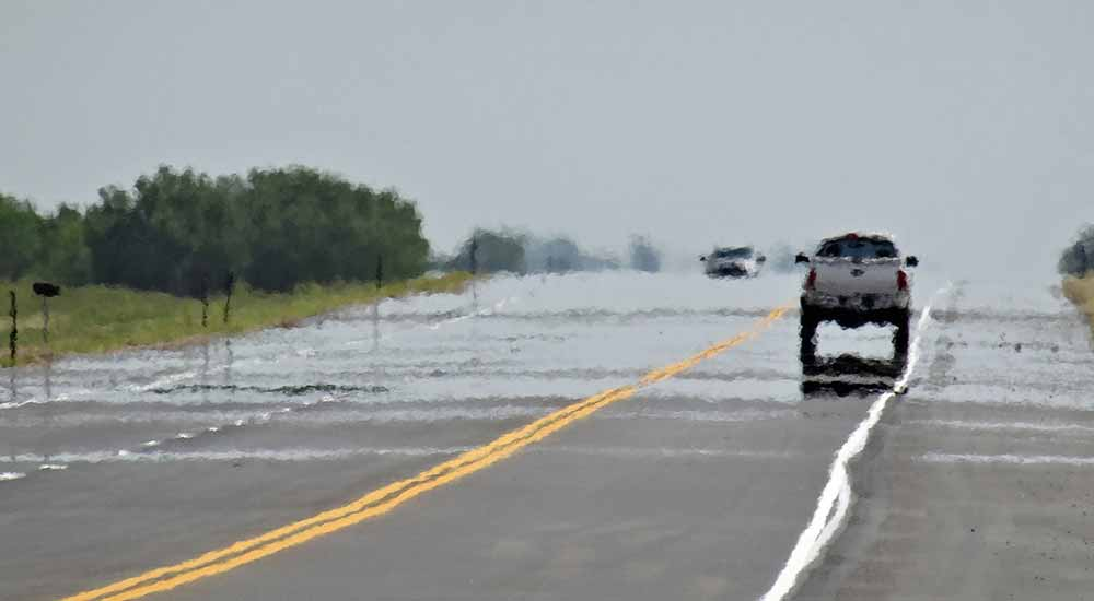

When you look at mirage against a fixed object with straight lines such as a road, or fence line, or the ridge line of a roof, or a target frame, what you see is a pulse just like a heart beat. You are watching the frequency of the waves as they pass by a fixed point. Your are describing it as peaks and valleys, and it could definitely be perceived as that. That is only a small slice of the whole picture.
If you pull your focus back a bit you will see that those waves actually cover the entire field of view and are at a definite angle as they move across the field of view. They can be very hard to see with a rifle scope, but are much more obvious with the use of a spotting scope.
