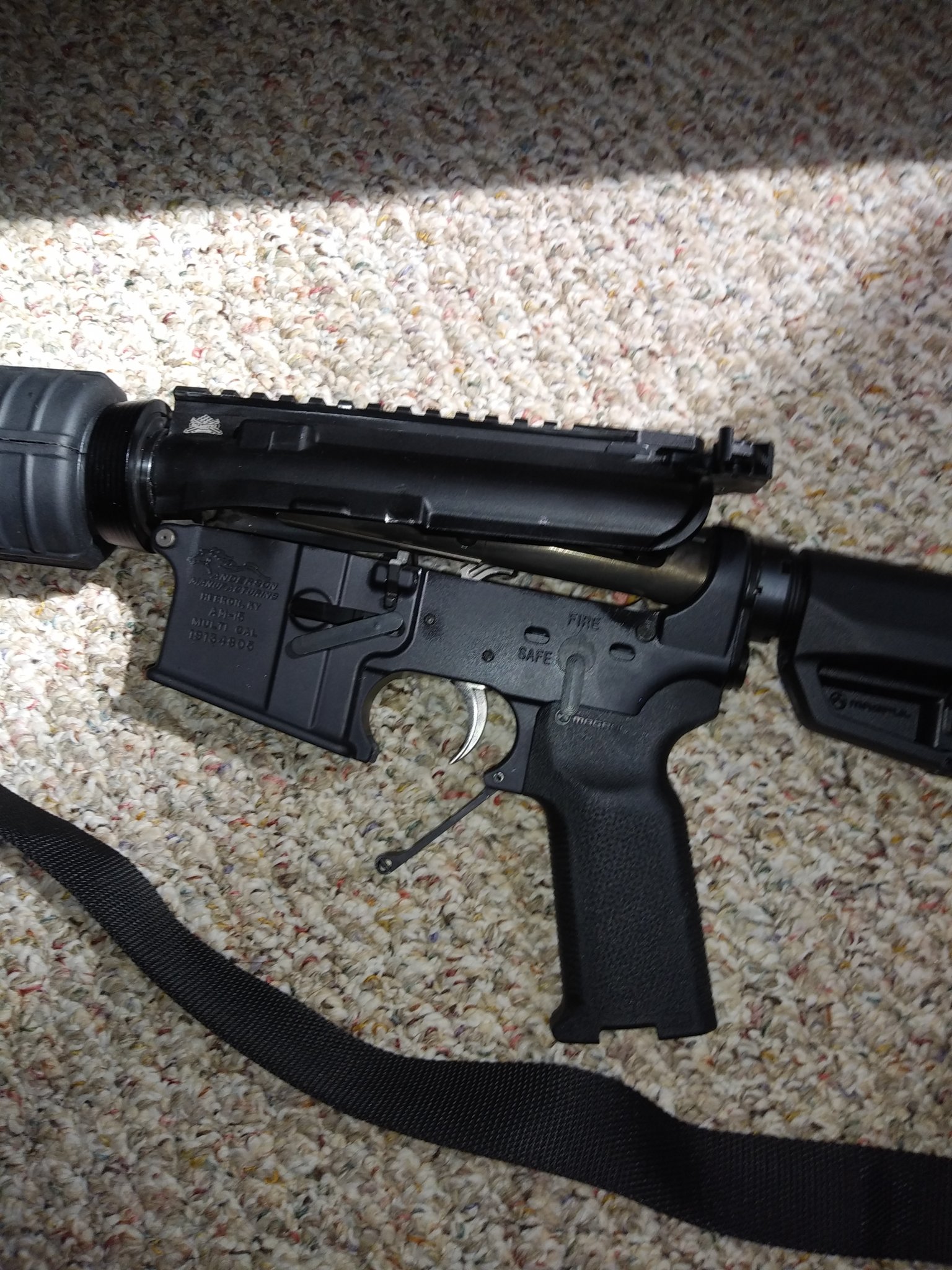

First rifle reload. 25.5g cfe pistol instead of 223. Was lucky i didnt get hurt too bad and it wad my cheap rifle.
  • Wow
Reactions: BLEE and Anb618
Wow.... yeah you are lucky. That could have been really bad. Seems the AR's are able to handle failures better than I would have thought judging by a handful I've seen get blown up.
Yes sir. Sprayed my arms with aluminum and im allergic to it. That was about the worst. Aimpoint went flying about 6 feet onto concrete. The mount broke. When i got a new mount it was only 3 clicks to zero again. The worst part is it filled the case more than i thought was right so i posted about online and people were like its fine. Lol
