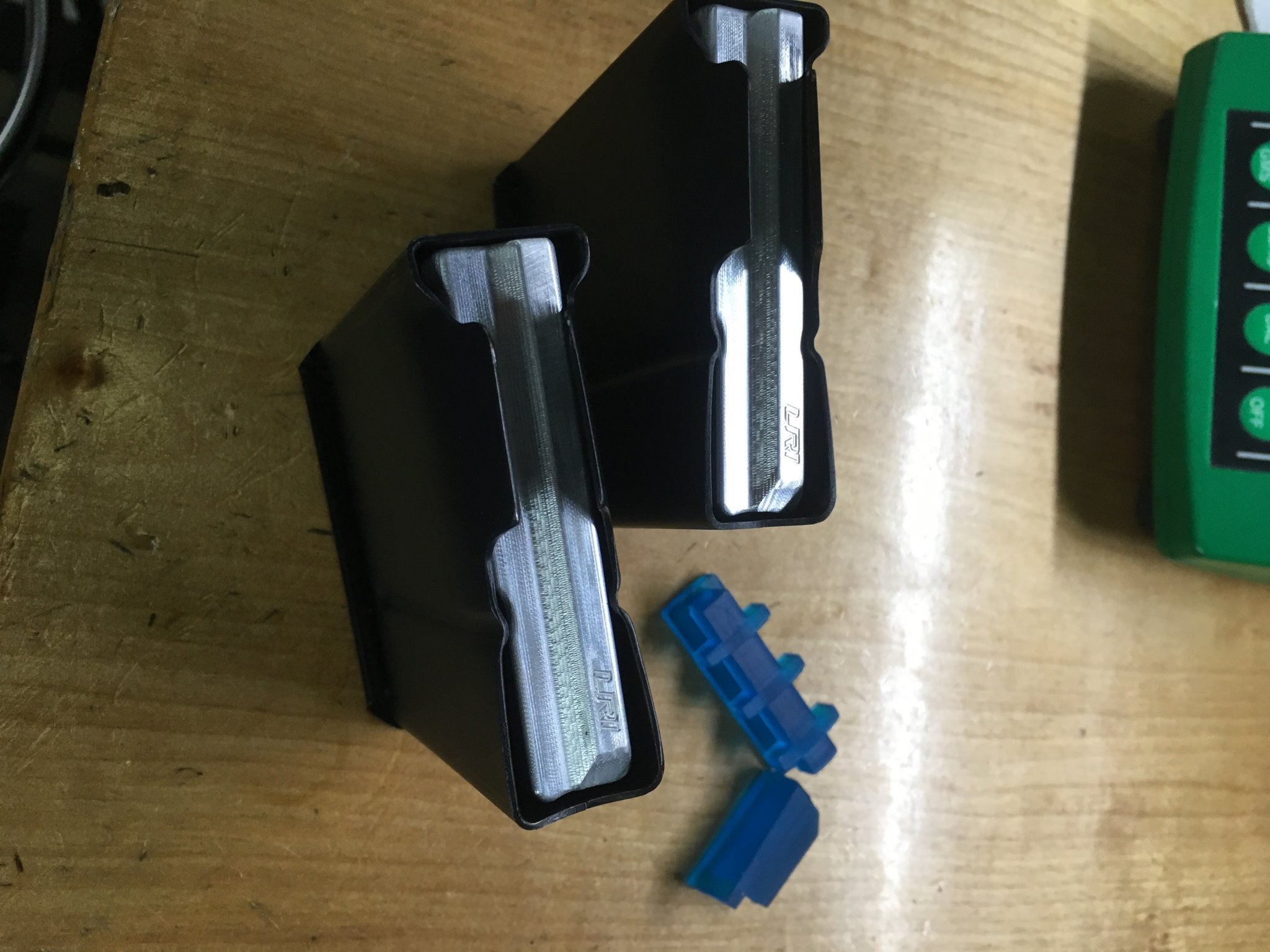

Got my LRI followers today for my ARC mags and these things are for REAL! I had the MK Machining printed ones and they never set right in the mag and one of the tips snapped off on me while I was shooting my 6 Creedmoor. Wasn’t a good thing! I put these fillers in and they look and run like they were meant for this mag. Ran them in my Tempest 6 Creedmoor and my TL2 Dasher no sweatrun like butter. Even dropped one in the dirt shook/ blew it out loaded up 10 more, like butter!
Nice work Chad!!!!
Reactions: LRI
Nice work Chad!!!!
Yup the LRI seat flush above mag.. unlike MK it sticks out..
By the way i got one extra LRI unused follower
Anyone wanna try it.
20 bucks shipped
