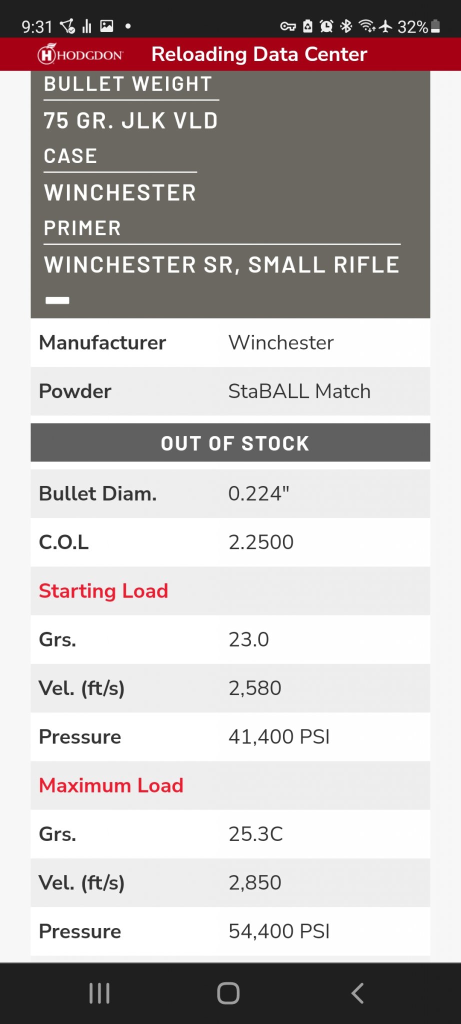

Ok. I am traveling for work but that data is what I remember. I am pretty sure you are looking at data for the 77 gr and not the 75 I was using. I just pulled this from Hodgdon's website right now.
So the online data for Hodgdon was indeed what I posted in that other thread. I double checked it repeatedly at the time because I was shocked at the velocity.
I also tested over online listed max as the Hodgdon data listed was only to .223 pressures so that leaves a bit of a margin until 5.56 pressures.
Seeing as how my brass/primers looked just fine, I will keep running at the book max.
If I remember correctly, I am also running an H3 buffer in that gun to slow unlocking as WOA runs their ports kinda big on the 18" rifle gas.
