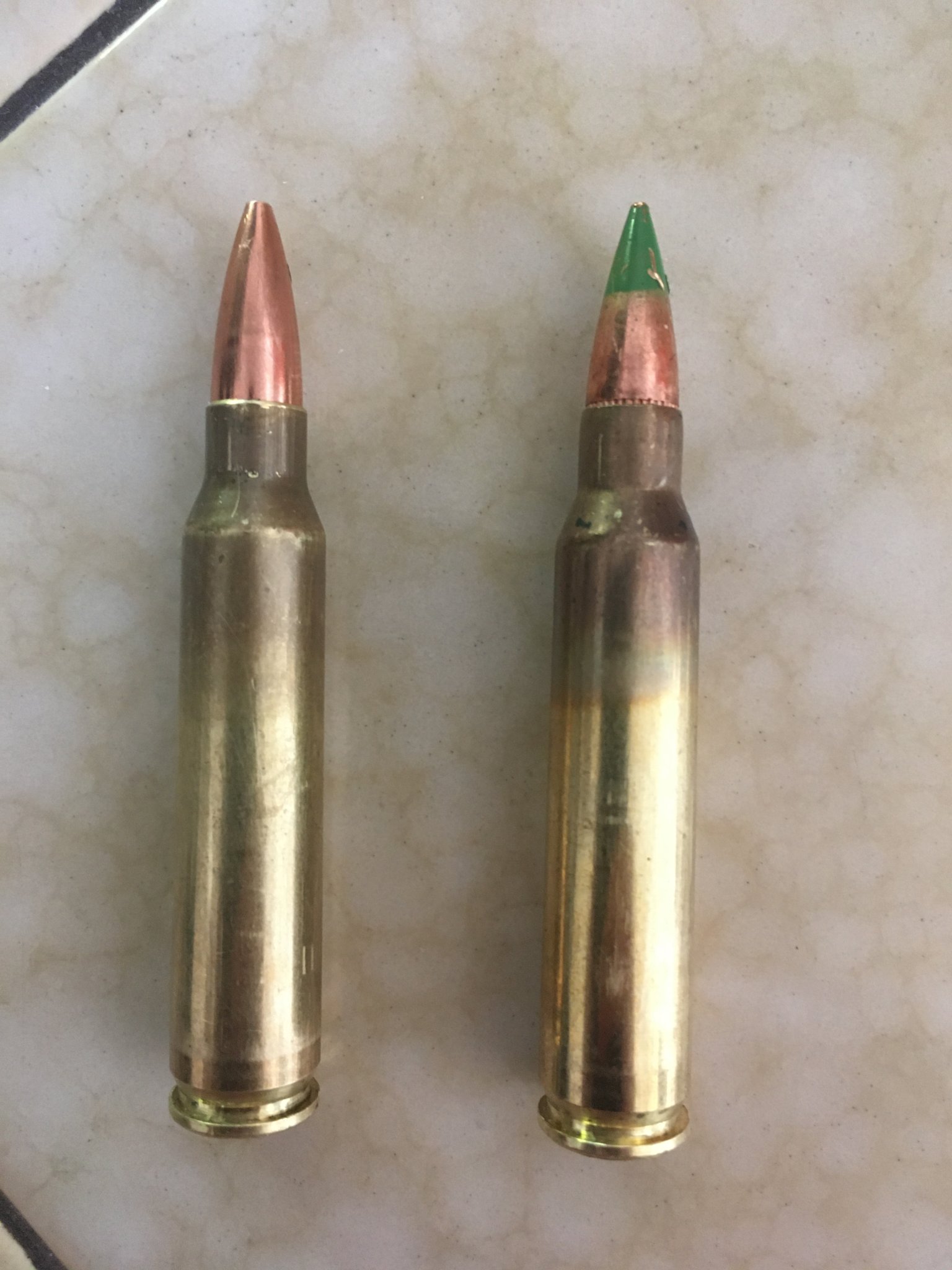

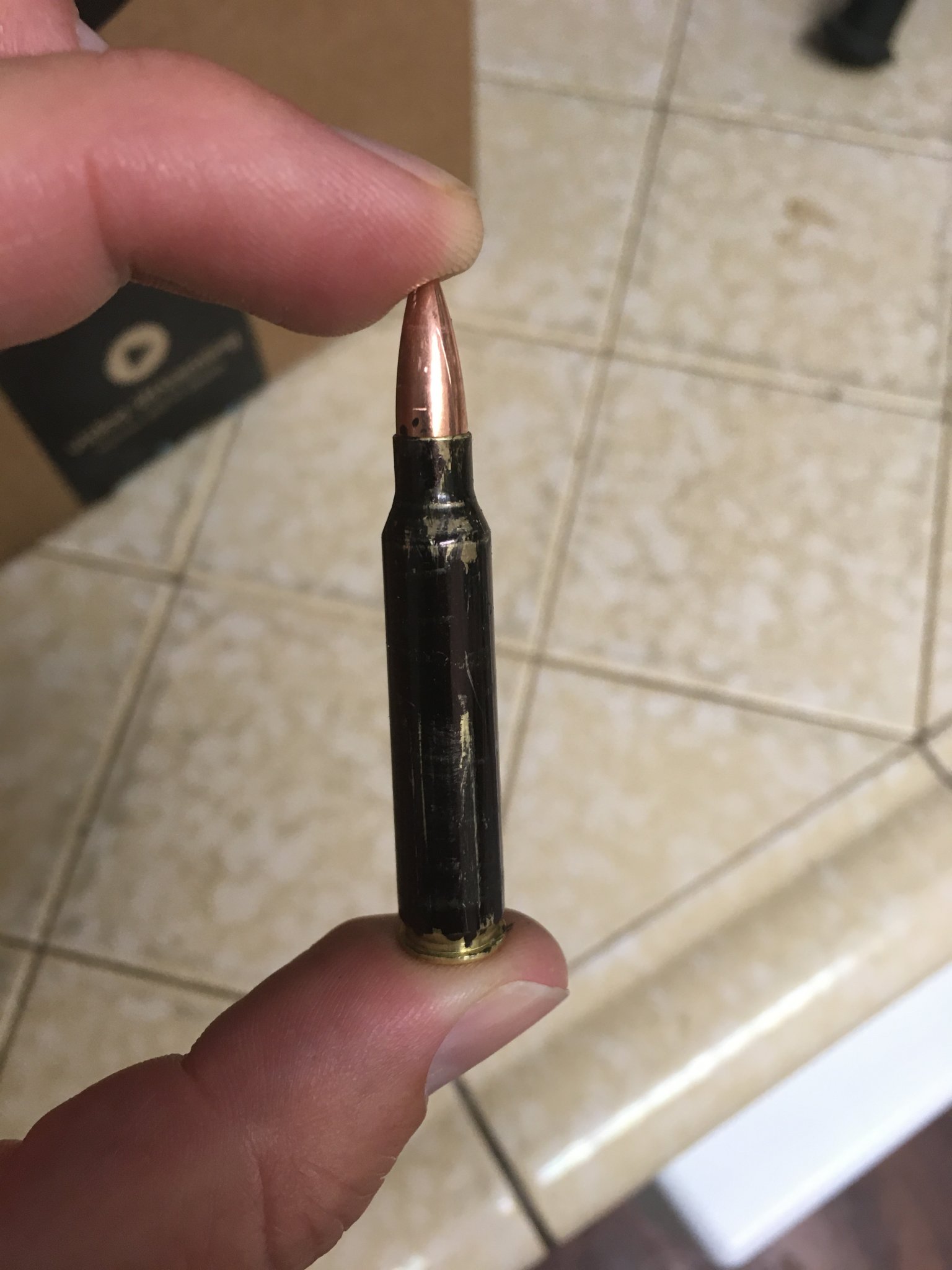

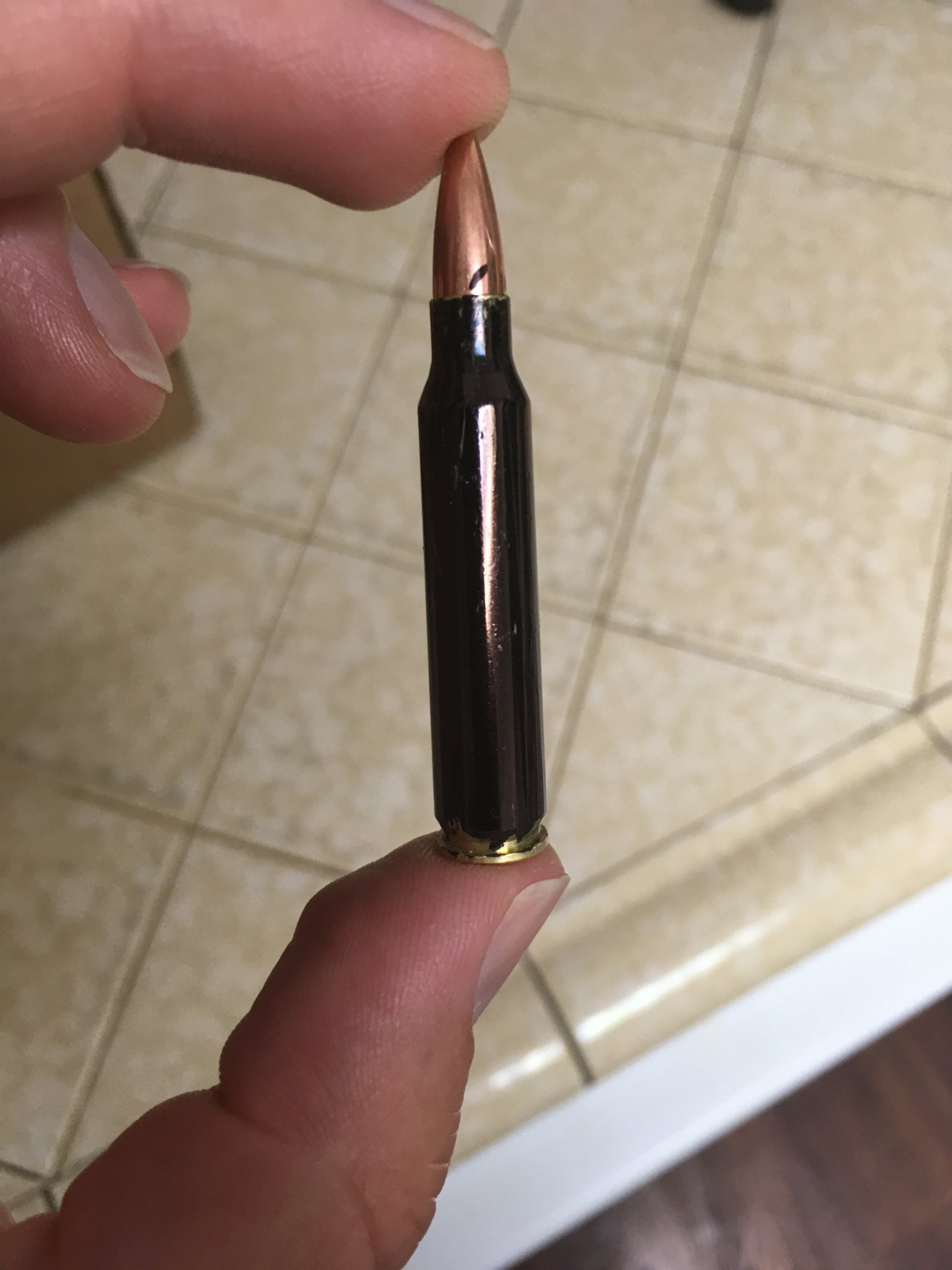

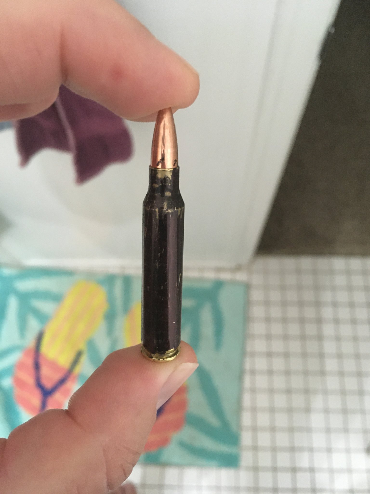

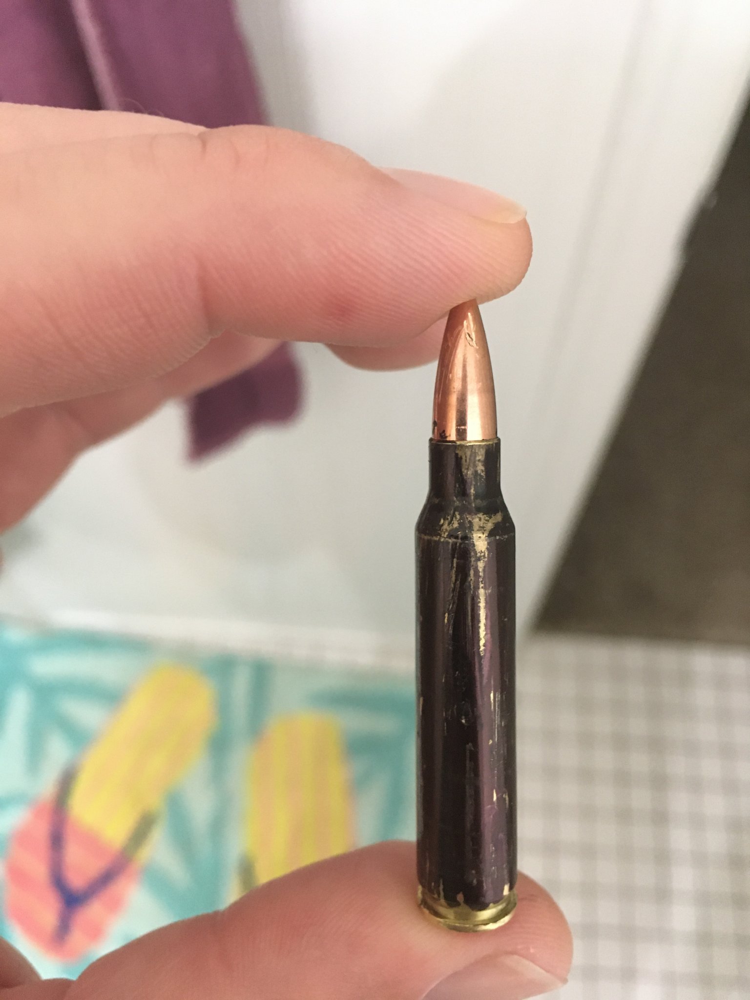

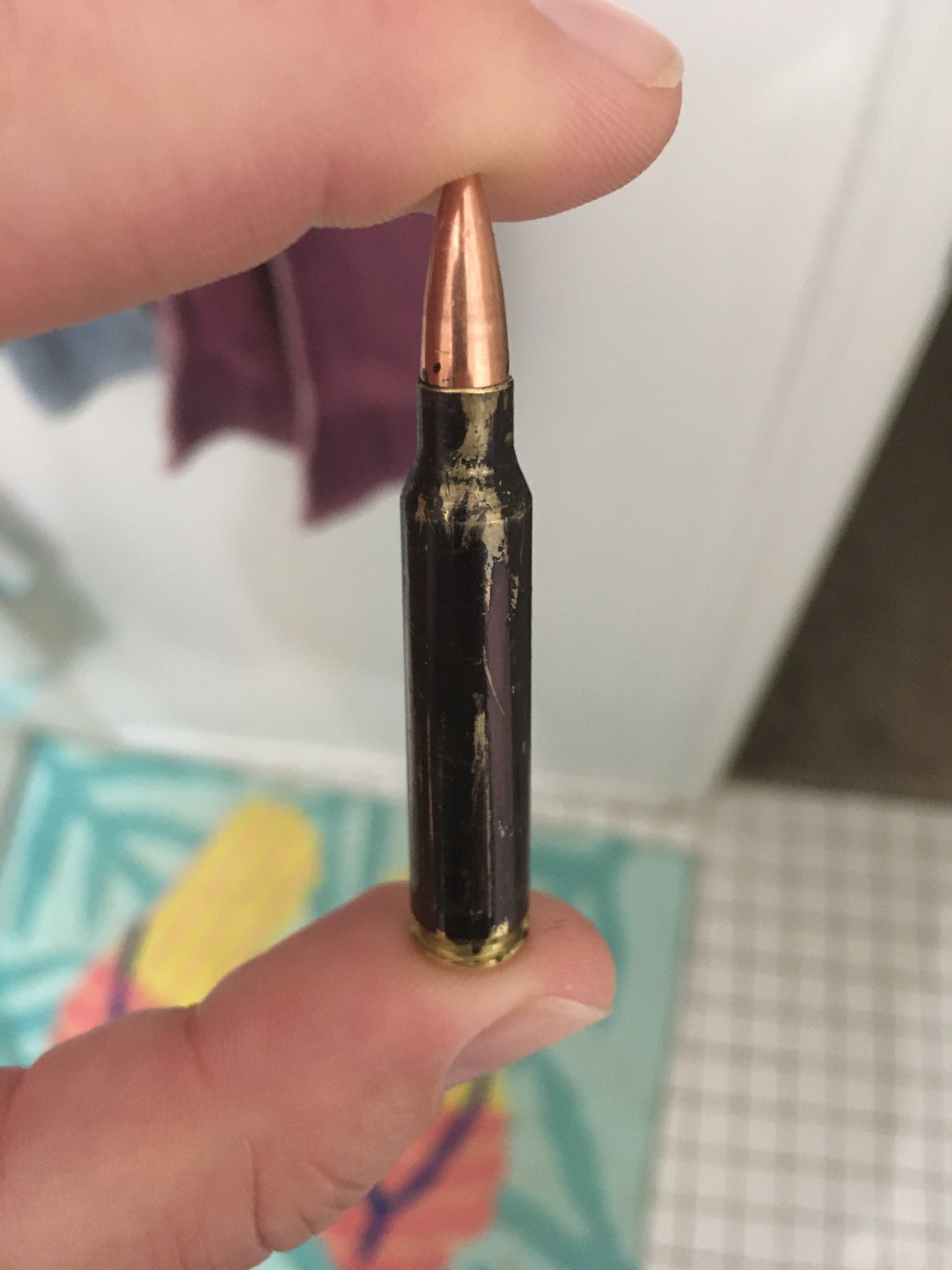

Mk12 won’t feed and lock my hand loads. I have Douglas barrel, standard mil bolt carrier with a jp bolt. Hand loads are 77gr smk loaded into surplus standard mil brass. OAL is 2.25. Measured the case and everything seems to be within standards. Same rounds operate fine through my buddy’s rifle with a Daniel defense barrel. I know the tolerances on my barrel should be tighter. Bolt locks if rounds are manually loaded individually but will not lock if a mag is used. Also if loaded manually they are hard to eject manually. I’ve tried brand new p mags as well as the standard garbage ones. Also swapped the bolt carrier already. Must be something in my hand loads that I’m not seeing. Using RCBS small base two die set with Lee single stage press. Appreciate the help.

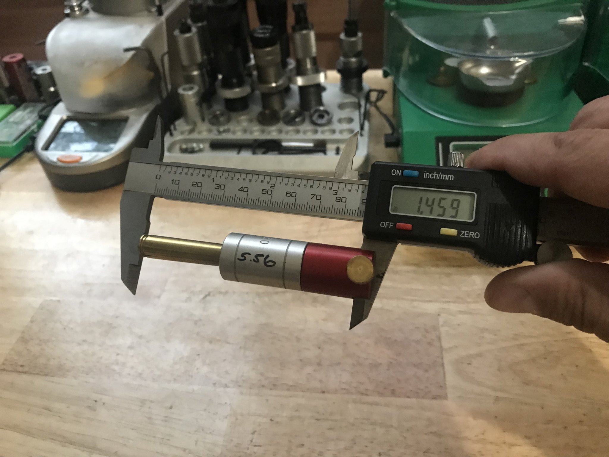

Micrometer (assuming it’s a 1” micrometer) is useful for measuring case head expansion just above the extractor groove to determine if your at or beyond safe pressure thresholds. Measure the case before and after firing.
Also purchase a Hornady headspace gauge tool with the set of bushings and watch a couple vids on YouTube to learn how to use them.

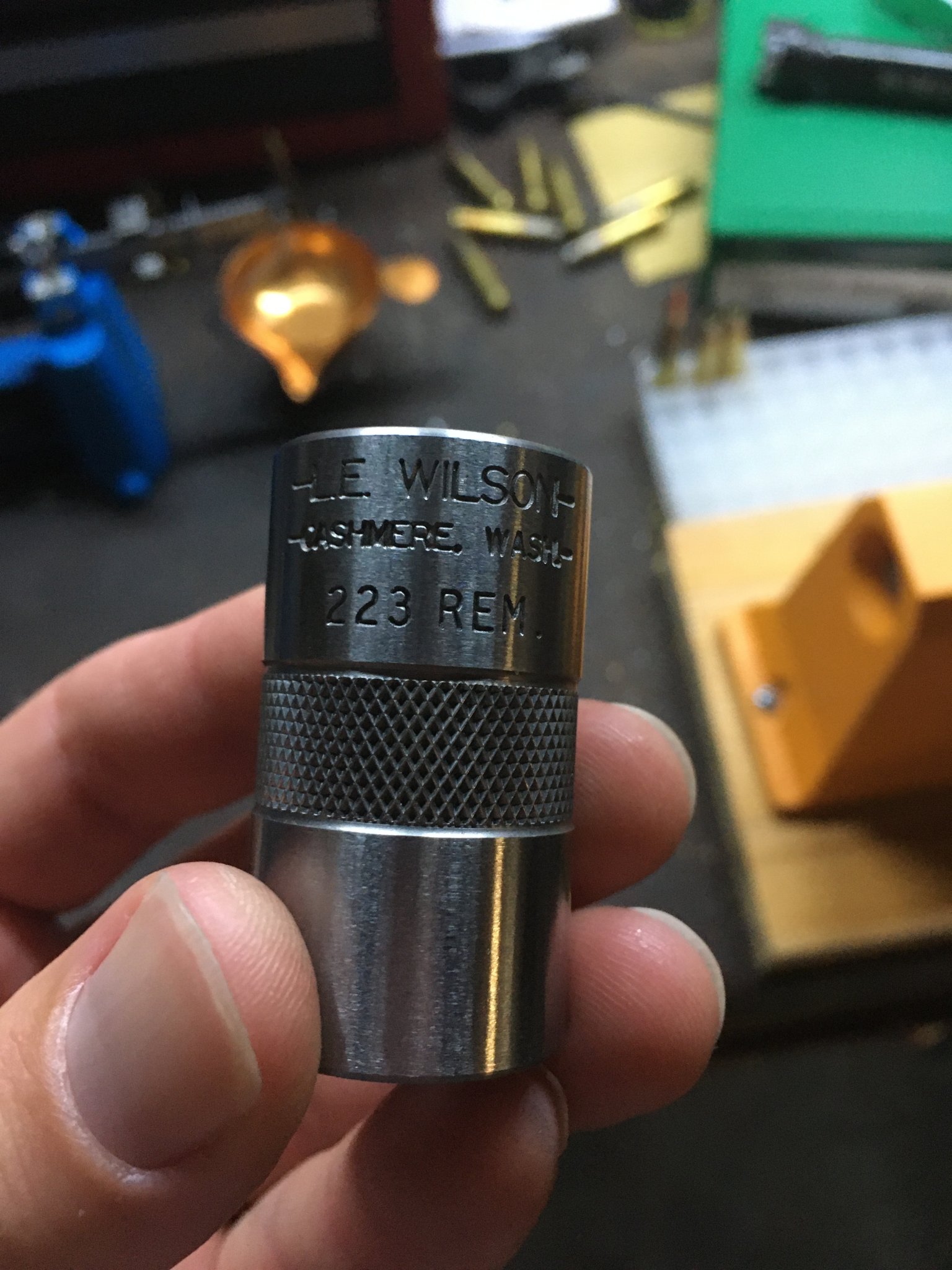

Ok. I’ll go ahead and order one of those. Factory loads work fine. Just mine. They group great just won’t load and it’s frustrating.
Oh boy. I’m going to regret this. How do you find the datum point? Pretty new to reloading (obviously at this point). Only measurement tools I have are a micrometer
I assume you have calipers as well since you provided a COAL measurement.
Place the open mouth of the 9mm case over the 5.56 case neck against the shoulder. Get the bases of both cases as flat as possible against the jaws of your calipers, it can take some fiddling with but you'll get the feel for it.
Note the measurement. Compare the difference between fired and sized brass. At minimum the sized piece should be .002" smaller, but some semi-auto chambers want closer to .004-.005" to be happy.
You will need bushing A330. Without that tool we won’t know if the sizing die is set up correctly.
Here is how it’s used

I also have a Mk12 (mod 1 / mod H) and set my bump to 1.457 as fired brass measures 1.461-1.462. Barrel is also a Douglas 1/7 SPR contract barrel from PRI.
For comparison, my carbine’s fired brass measure 1.465-1.466 on average.
the piece of brass in the pic hasn’t been sized as of yet.

You can use a 9mm case instead as a comparator. To get a base to shoulder to measurement. Then you will have to surmise if it is sticking at the shoulder or the body. You could color one with a sharpie and see where it s sticking. You will either need to bump the shoulder more, or possibly you will need a small base die.
my sized brass starts going into the spent 9mm.
You can try resizing the 9mm brass and see if that shrinks it down enough for you. If not just wait for your comparator to arrive.
Yes and yes
Take a couple of your KNOWN BAD rounds and hold them up to the light. Looking at the silhouette profile of the case, look just below the point of the shoulder. Can you see a slight bulge at or just below that point of the shoulder? If so, that's your problem and the rounds are being over-crimped causing the shoulder to collapse.
ETA: you can use a straightedge against the case to help determine if it is bulged.

What I would do is get a magic marker or equivalent and paint a piece of the brass with it then try to chamber it.
When you pull it out it will show you the contact points and help diagnose the problem.

In lieu of a comparator to see how much you are bumping shoulder...
Size a piece of fired brass as sizer die is currently set up, remove all lube, lock BCG back, drop case in chamber, ease bolt forward and use forward assist (FA) to get extractor to snap over rim, put bolt fully into battery.
IF you are unable to get bolt to go fully into battery or really have to apply a lot of force to get bolt fully into battery, case isn't sized enough.
IF bolt will go fully into battery but will not extract easily, case isn't sized enough.
IF bolt will go fully into battery and case extracts easily, you have case sized enough and problem is elsewhere.
Once you have a case that allows for bolt to be fully in battery, extracts easily, now make a dummy round by seating a bullet. DO NOT crimp, only seat bullet. Verify dummy round will chamber using same ease bolt forward until contacts dummy round and finish getting bolt fully into battery with the FA. Provided dummy round extracts easily, now crimp bullet and repeat chambering and extracting the dummy round.

Please retake the photos of the markered round. The second one is telling us something but the first one has so much glare I can't see it very well. Take it where there isn't some crazy reflection on there.
What kind of die are you using?
First thing I would take the die out and clean it well. Secondly I think you haven't set your sizing die up correctly. Based on the second picture look at where the contact points are. At least one major point is right on the shoulder of the case, which tells me you are not sizing the case enough, which tells me that your die is not screwed down enough.
Screw your F/L die in another 1/12th of a turn, not too much. F/L size a couple of cases. Make a dummy round with no powder or primer and seat a bullet. See if that now chambers and extracts easily.
It probably will.
Agreed.
Maybe need a little bit more than 1/12th maybe, but let him experiment and see.
Definitely a sizing issue brought on from the die not being set up correctly.
If you just go ahead and screw the sizer down until it contacts the shell holder and load a couple rounds with it just to see if they'll chamber you can save a lot of time troubleshooting the sizing issue. Be sure and crimp exactly as before, only changing one thing at a time for troubleshooting. With your RCBS small base die set this will insure that you have sized the test rounds "enough." If they chamber properly then that's your issue. You can then back the die off -if you want to- until you get the setting you're happy with.
If you still have trouble then load a couple rounds without the crimp. And I HIGHLY recommend that if you crimp, do it in a seperate operation with a Lee factory crimp or a taper crimp die. With your roll crimp, each round has to be exactly the same length and the same neck thickness or some rounds will be over-crimped and some maybe not at all. The factory crimp and taper crimp won't damage the round when over-crimped.
When I load bulk ammo I set the die to contact the shell holder and cam over because I don't know which gun will be firing that ammo and it absolutely MUST fit and function above all else. IMO just "bumping the shoulder" is not for MY USE. I understand everybody else on here are shooting for the 'nth degree of accuracy but as you have experienced if the ammo won't function it's useless.
Three different sides

We have success!!!! Picked up this Wilson gauge at the shop today. There was the tiniest of differences between my rounds and factory rounds but I guess it was enough. Cycles flawlessly now. Truly appreciate the help everyone. Thank you for being patient too. Most forums can get snotty. Thank you again 🤙
