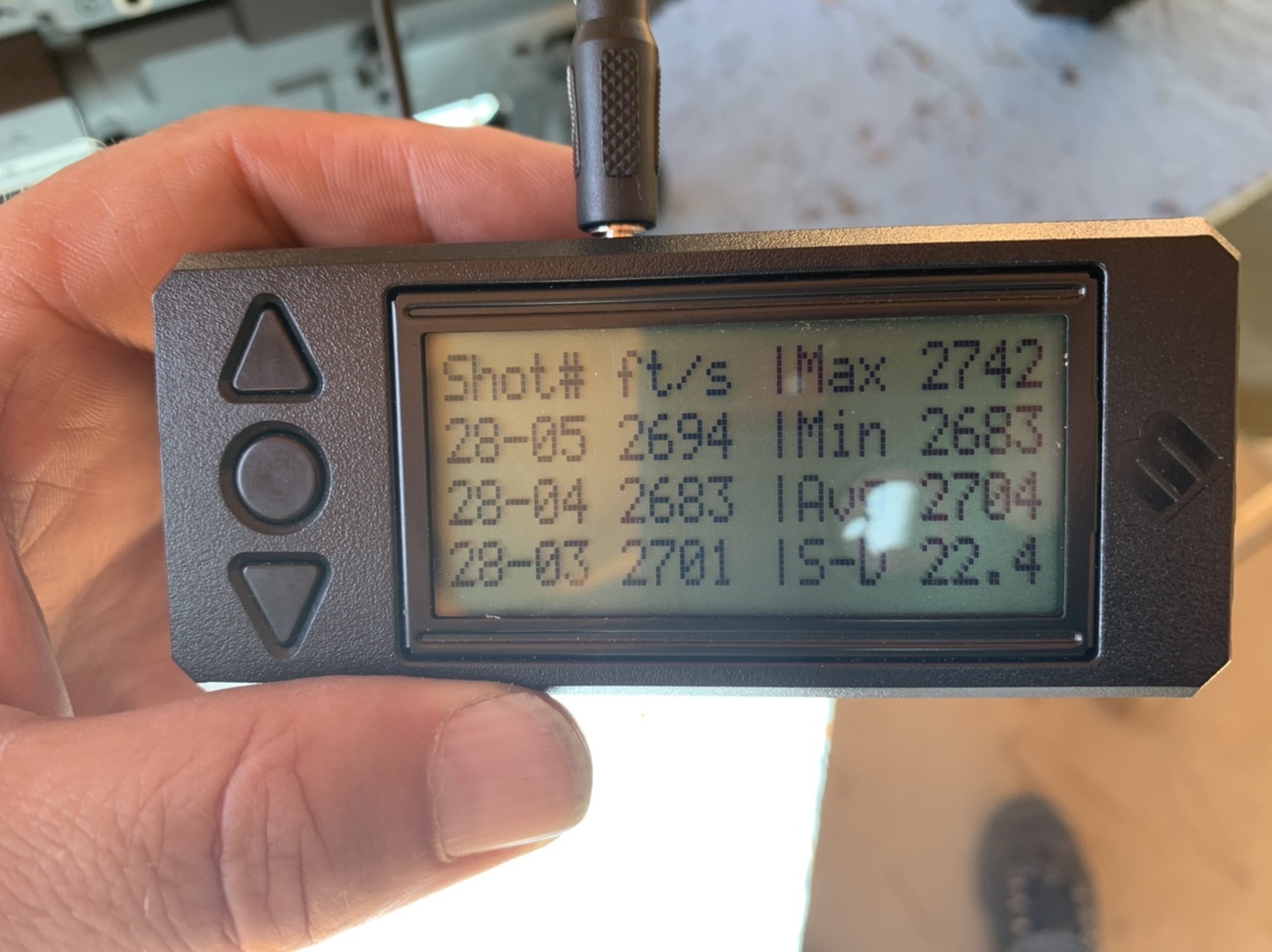

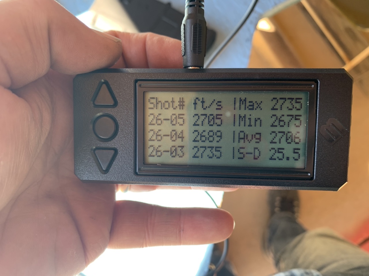

Here are two recent 5 shot strings on the magneto speed for the 77gr Razorcore.

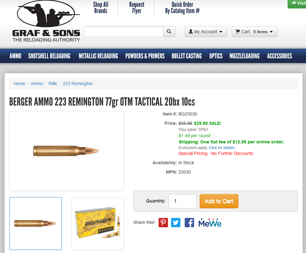

What’s the accuracy , sd, Es like ? 1.50 is still steep for 223.
Why it’s the same price as match 6cm is sickitating

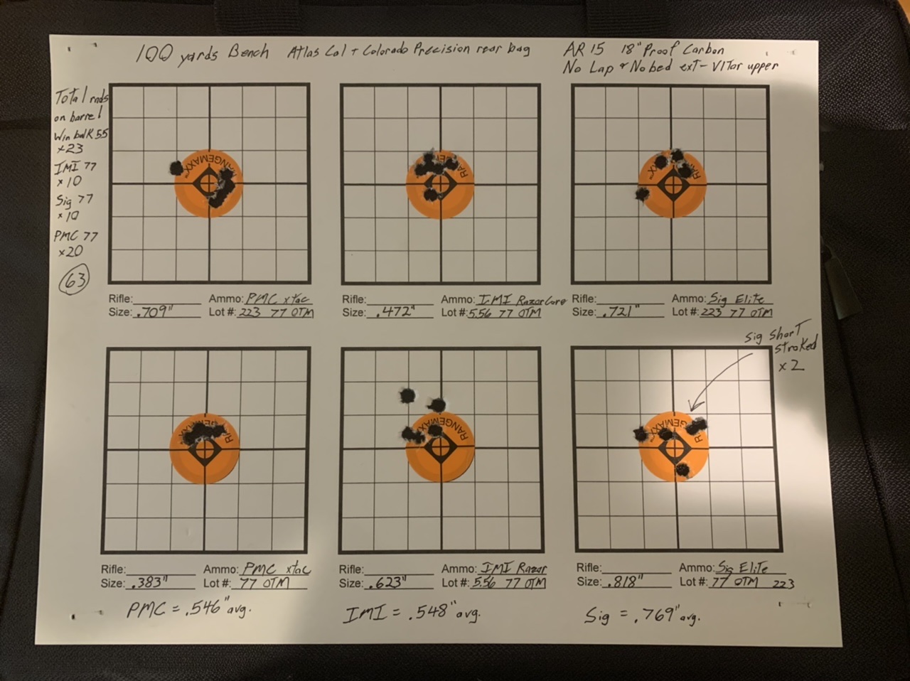

ADI and Australian outback ammo both used to have 77 gr SMK match ammo.
I can only find it in 69 SMK now.
But, it's good stuff.
Have also had very good luck with PMC X-tac match with the 77gr SMK.
Obviously no problems with IMI razorcore here.

I just tried 23.3 of XBR with cci #41's on several different brass varieties & had no blown primers.
From an 18" proof with 77 smk
All same load of 23.3 & seated 1.858 bto
Sig brass = 2705
Win brass = 2740
IMI brass = 2768
PMC brass = 2763
