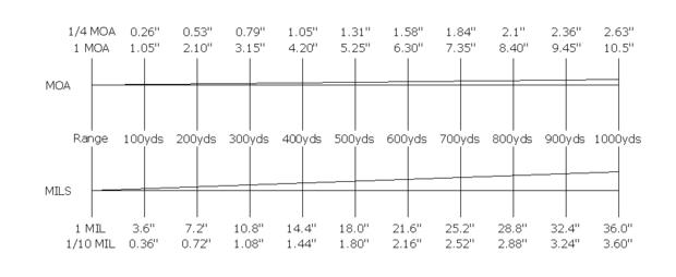

There's nothing metric about Mils.
Mils work with inches. You don't have to learn parsecs, either.
The only real difficulty of MOA is whether your 1/4 MOA adjustment is 0.25" or 0.26175" @ 100 yards. Once you know and the reticle coincides with your adjustment, the other PITA is conversion to mils if your buddy/spotter is running mils.
Technically though, 0.26175<0.36... so you would have inherently more precise division in a 1/4 MOA system. Precise enough to matter? Nope.
They accomplish the same task, I like mil mil mainly because I like 10ths over quarters or halves. Base 10 has merit for my shooting, and my buddy can read back mil corrections from his spotting scope.

While the mil system is not really based on the metric system......1 mil =10cm @100 yards or .1 mil = 1cm @100 yards so I can see a relation to the metric system.
That is not quite correct: When using MILS with Metrics; 1 MIL = 10 CM @ 100 Meters (3.93701") and each 0.1 MIL = 1 CM @ 100 Meters (0.39701"). When speaking in Inches and YDS. 1 MIL = 3.6" @ 100 YDS and each 0.1 MIL = 0.36" @100 YDS.
1 meter = 39.93701" and of course 1 yd is 36.0" so 1 MIL will cover 1/10th of a meter @ 100 meters, or 1/10th of a yd @100 yds. Just remember 1 MIL is exactly 1/10th of any unit of measurement.
Thank you for the correction, I was thinking in yards instead of the metric meters at the time of the post :eek:

I saw this on another site and wanted to know how accurate it is.
