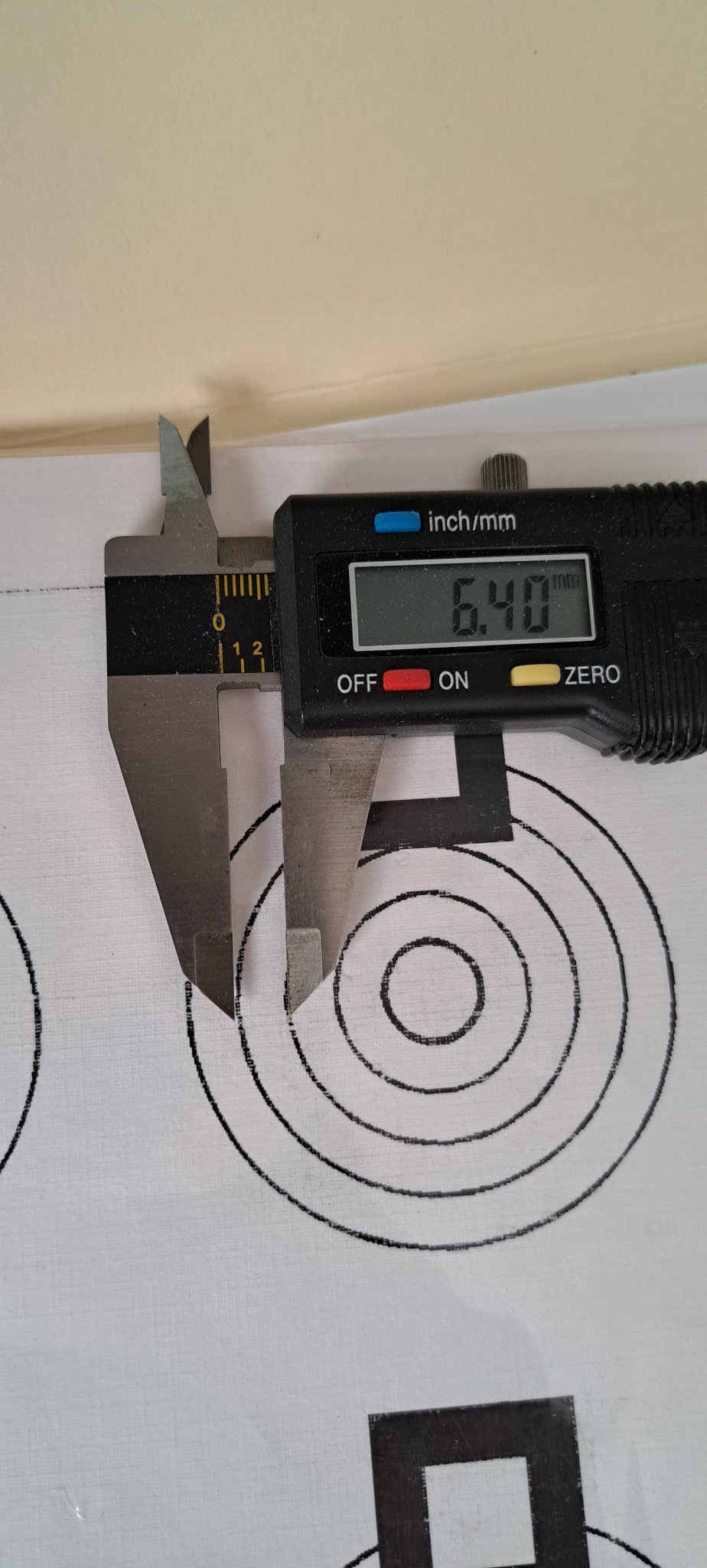

The lines on my BR targets are 1/4" apart. That gives me a reference for my 1/4" turrets.

Pics of the targets I use.
For the Imperialists.
For those who have Met Rick.
Reactions: Taylorbok
