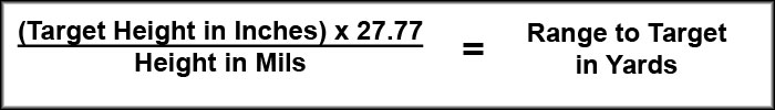

My only concern is ranging with the reticle. If i measure something in inches and then use a mil reticle to range it i have to convert to a metric mesurement correct?
he's trolling the shit out of you. and you took the baitLOL holy shit you don't know what you don't know. Leave this conversation to those of us who actually have used our rifles in the field.
The other way is target in inches/subtention x 100 - 5% = distance. I've used this method for years upon years an have never missed do to my range call. The easiest is IPHY target size/subtention x 100 = distance.Let's try that for an MOA reticle: Size in inches ÷ Size in MOA x 95.5 = Range (yards)

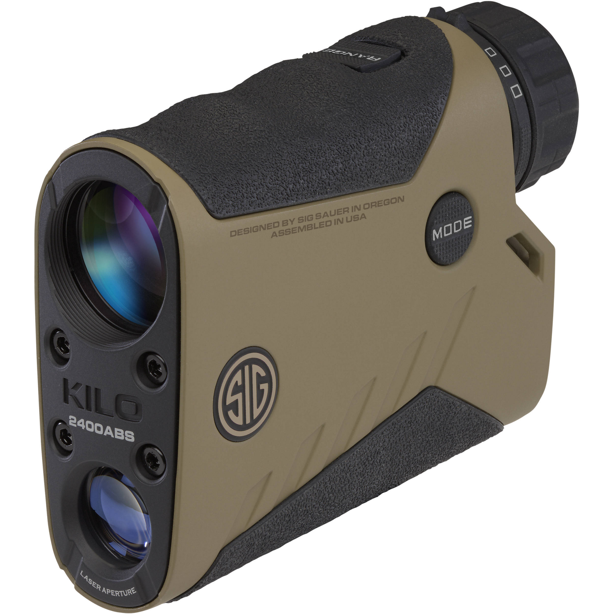

Hmm ok then. So do most of you just use a laser?
There are shoots were it's all UKD, but you can use a LRF if you think (A) it will give you the correct reading, or (B) you think you can out smart the MD who set up the targets an firing points. Those type of MD'ers post here,... an one lives in a very small place south of Opelika/Auburn Alabama an is known by jhuskey here, other names follow him if/when you are invited to one of his shoots.
Not everything is as it seems on the net where tacticool is the order of the day, there are many types of shoots that are invite only.
Correct, as most people don't practice it enough or understand lighting, angle, target colors, ect. The biggest mistake most make is to verify the ret they are using in the first place, an not just one subtention either.Reticle ranging is a legacy skill for many reasons that make it not very accurate at times.
