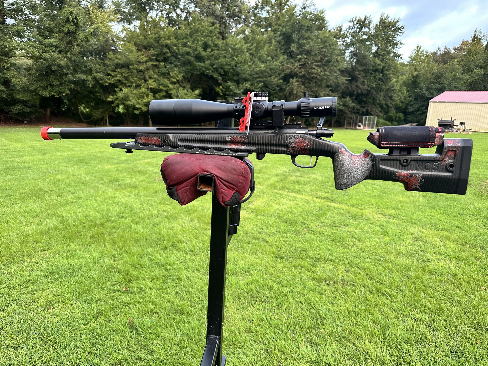

    I received my RimX action back from @jelrod1 yesterday. I had enough time after work and life to get it all mounted up, cleaned and barricade zero checked. I had to order a new scope base from Zermatt as the 30 I have is too much. I need 20moa. I have 20 in the scope mount and 20 in the base will get it 1 mil from bottomed out.
    With Lapua Long Range and my lot tested Midas it is 1 hole at 50y for a barricade drill. Johnathan has over 500 rounds down the tube and I had enough time to put 60 on it last night. More testing to come in the next few weeks.
    Build specks
    Zermatt RimX Action
    Mullerworks 13T by Paul Tolvastad
    Gen 1 EC Tuner
    MCR ModX Conversion to bolt nose
    Area419 20 MOA 1 piece mount
    Manners PRS1T Stock
    Mcload Precision Manners Stabilator Pro Rail Plate

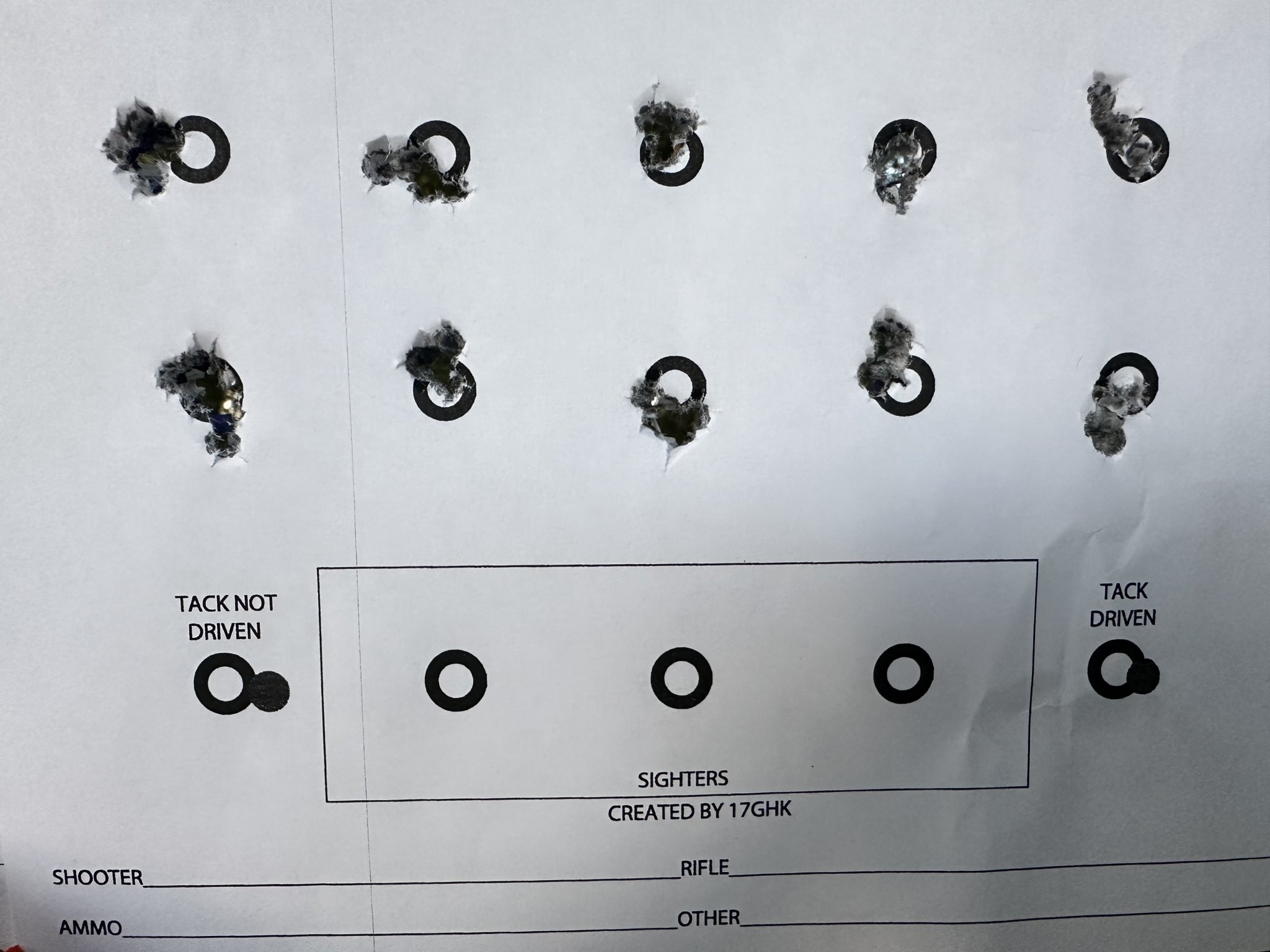

    These are 10 5 round groups at 50y I shot last night while getting it zeroed with my other Gen3 Razor. New 20moa scope mount should be here Monday and I'll get the Match Pro ED re installed. Plans to carry it to 350y this Sunday.
    Barrel was freshly cleaned when I started the shot string. I only deleted the first one and should have done the first 5 or 10. This is lapua Midas+ and a Mullerworks 13T.
