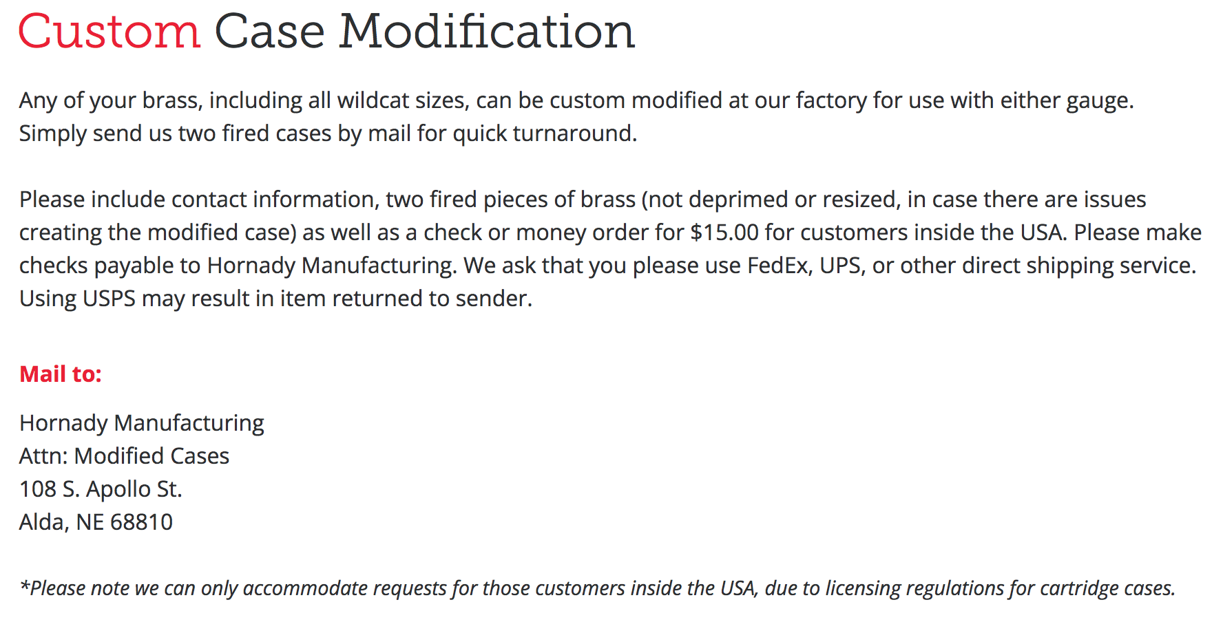

Time after time, people are congregating around this idea they need to use the Hornady OAL tool and then struggle to find a modified case.
Why is nobody using the Sinclair overall length tool?
It’s a one time purchase and will work with any caliber out there.
Stupid question alert ... How does this Sinclair tool replace a modified case that tells you distance to the lands? This measures chamber size to tell you how long your case should be ... not bullet seating depth. What am I missing here?
So how many delrin action guides do you own?
"The tool consists of a Delrin™ bolt guide, a measuring rod and two stops that have two different diameters of equal length"
Sinclair used to make about 12 different ones for different actions, several of them are no longer available.
Sinclair makes two length tools; Sinclair Chamber Length Gauge and Sinclair Bullet Seating Depth Tool.
Wheeler lands method. Don’t know why anyone would fuck around with all these gadgets when it is an absolute indicator. Never mind that you give five different people these tools and you will get five different sets of measurements.
I am asking sincerely here, if you are not jamming a set amount, or touching the lands on every shot, why is the absolute number that important?
Reactions: LR1845
The Sinclair tool is pretty similar to the Hornady OAL tool except instead of using modified cases, you just use you're own fireformed case. No alterations are needed. You can still load the case afterwards. They both work in nearly the same way; one required you to either buy the modified case, or modify your own, the other you just use a fired piece of brass.
