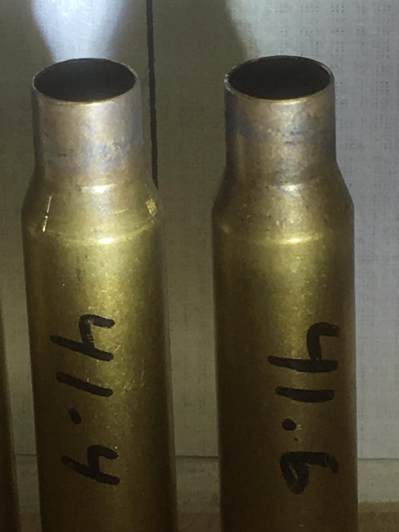

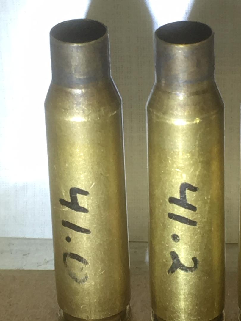

At what point did powder burn become efficient? Here we see that between 41.0 grains and 41.2 grains that the powder residue became significantly less and moved from the shoulder, to just above the shoulder / neck junction. This is indicative of reaching the optimal pressure for a clean powder burn.
7050082
Here are the next two cartridges in line. You will notice that they too exhibit less residue, and the ring has moved up from the neck / shoulder junction.
7050084

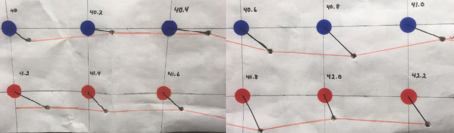

Tried to get them in one pic together for ease of viewing
Looking at this further, you could even break the flat spot from 41 to 41.6 down further into 2 distinct parts. The reason I draw a straight line from the POA to POI is because it makes it easier to immediately see even slight differences.
41 grains and 41.2 grains have the same vertical as 41.4 and 41.6, but have a slightly different horizontal. You see that the lines are longer for the first two.
Yeah but that could easily just be small sample variation. With the limited data its tough to say whats what so who knows.
I agree, this single shot method definitely has potential for identifying areas of interest very quickly and efficiently, but I don't think it has the ability to pin down a specific load. I do however think that it provideds more information for the same number of rounds than the Audette ladder, and is easier to read than the OCW.
Though to be fair, if people were able to map the group centers of the OCW in the same way and ignore group size, then you would get even more information, especially if you were using a lab radar at the same time. People just can't seem to look past group size when doing the OCW.
It is all the other clues (Powder burn, base expansion..etc) that really pin this load down to a finer point.

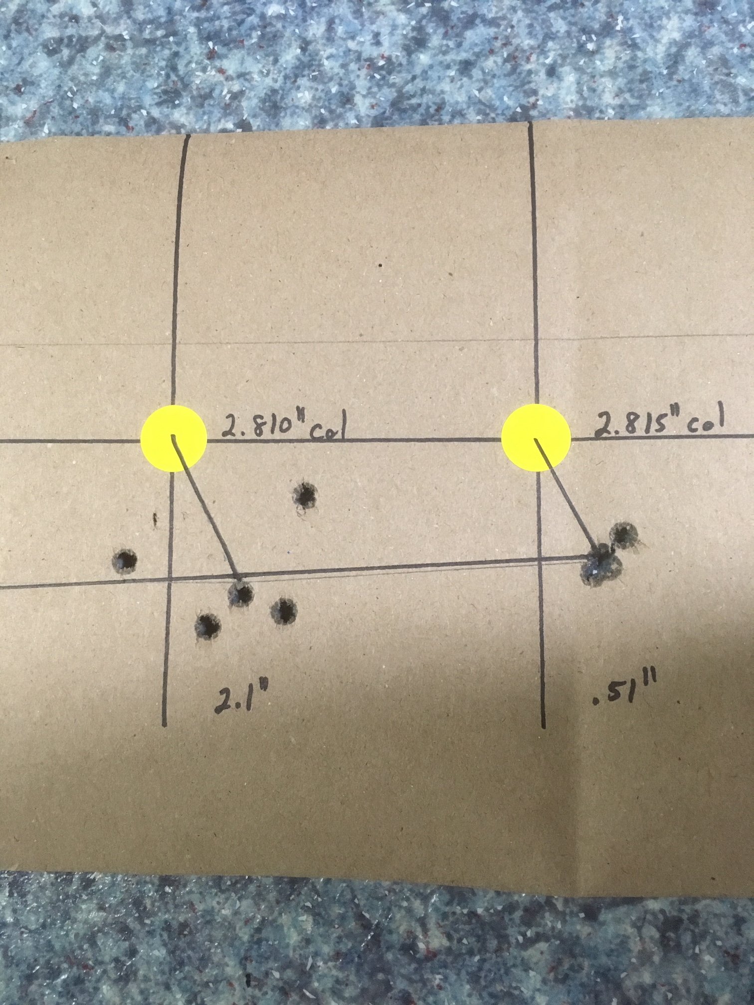

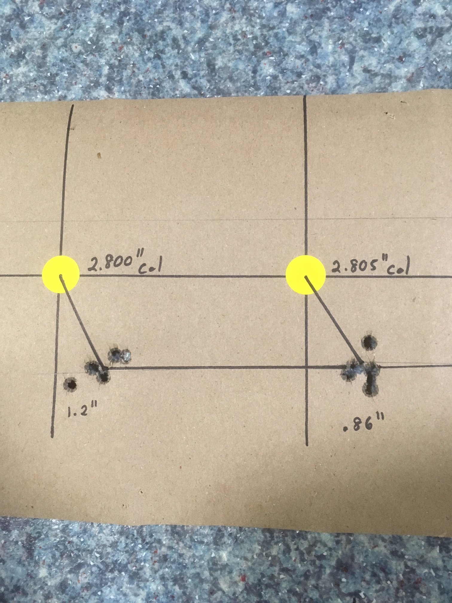

Seating depth test, 41.4 grains IMR 4895, annealed cases 2.800", 2.805", 2.810", 2.815"
This is a perfect example why group size and shape means absolutely nothing during and OCW test.
Interesting observation: Notice how the group center rises as the bullet is seated further out, but the center stays clocked at virtually the same angle from POA.
This is a perfect example why group size means absolutely nothing during and OCW test.

Thank you. Next is to shoot 20 shots of the load at 200 yds (4 groups of 5 shots) at the same point of aim. This will be the true accuracy potential of the load (in my hands anyway). When the weather gets better, I'll do the same at 500 yds on paper.

the 2.810 oal group is why im never able to trust anything done off 1 shot...assuming those shots were executed correctly, they could completely throw off any pattern if you happen to start testing with that
for the last 3-4 yrs ive ran all my load work up off 100 yd ocw, then i chrono...ive never had a problem getting single digit SDs and 20-30 ES for 10 round strings using only sized/trimmed hornady brass...no other prep and throwing powders with 2 different chargemasters
ive switched to lapua and a better scale and those numbers cut in half, i could cut the hornady numbers as well with more brass prep and sorting but it isnt worth my time to me
i have seen some bullets just flat out not shoot in a barrel regardless of the load...my current 6.5 twist 223 would not shoot 88 eld's...i tried 3 different powders and multiple seating depths from .005-.050" off...random fliers were bad...even though when i chrono'd, numbers were great...it would shoot about 70% of them inside 1/2moa, the others were out up to 1" or so in any direction...even doing charge work ups i saw some spots that looked ok, but when i went back to shoot and verify, no bueno
same barrel will hammer with 77otm, 80 vld, and 80.5 fullbores...i couldnt hold the 88s inside 1moa consistently, the worst anything else shot during workup was 3/4ish and held nice tight clusters like im used to seeing
I agree, I have historically used OCW also. Mapping the actual mathematical center of groups in an OCW would show the same wave pattern and be more reliable to boot. It would just take 3 times the amount of shots.
However, even with single shots, broad trends are easy to see across a 0.6 or 0.8 grain spread when increments are 0.2 grains apart. For instance, in the original testing sequence the 41.8 might be lower than average or 42.0 might be higher than average. But look at the "clocking" of the angle from POA to POI....there are definite groupings that are the same. Going by the established trend, I would say that 42.0 is probably higher than average.
As far as the "clocking" I was talking about, you can see here:
40 is by itself,
40.2 & 40.4 are the same,
40.6 & 40.8 are the same,
41 & 41.2 are the same,
41.4 & 41.6 are the same,
41.8, 42, 42.2 are the same.
This is really the first time I'm paying attention to this "clocking" for lack of a better term. I think it may be a missing bit of information that gets ignored.
7050083
But if not taken in isolation and put together along with all the other clues I've mentioned, I think this can really point to a fairly small area of interest very quickly. But I don't think it is a replacement for a full out OCW.

What OAL did you settle on? Something between 2.800 and 2.805 for more tolerance or did you pick 2.815 because it's the tightest group?
That is a great question. I would normally say that I would pick the 2.815" COL because I'm using micrometer adjusted Forster seating dies and they have no problem seating consistently.
However, the RDF's are infamous for being inconsistent in their base to ogive measurements, so we shall see how it works out.
I want to say I’ve tried the jump first, but it was years ago and I didn’t really see much improvement with the charge I had picked...everything was really similar and within my personal error...it would be interesting to do it again tho

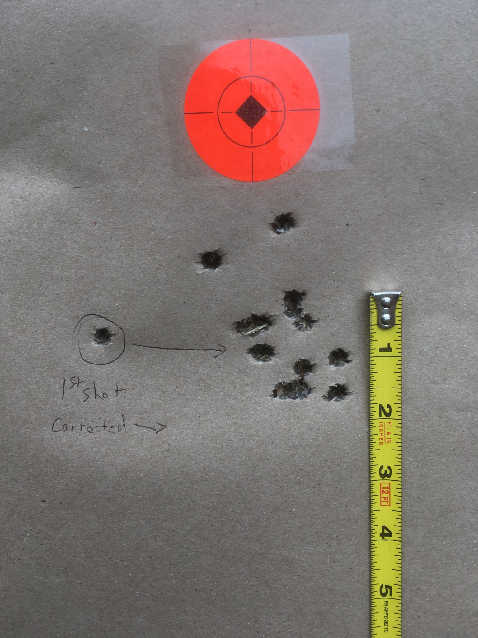

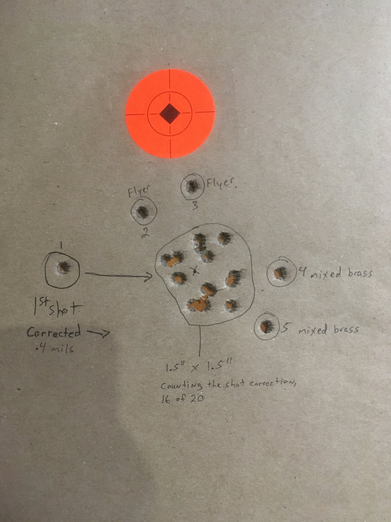

I did the 20 shot group today, but I did it in 2 steps. The first 15 shots were all the same LC 11 headstamp and identically prepped, to include annealing. 2.815"COL
The last 5 were mixed headstamp LC brass of identical weight as the other pieces and also annealed the same as the others.
Here is the first 15: @200 yards
The 2 shots up top are honest flyers. They felt and looked the same as the others when I broke the trigger. I made a 0.4 mil correction to the right after the first shot, so that first shot should be counted as part of the group.
Here are all 20: @200 yards, 2.815"COL
The last 5 shots were made with LC brass that was otherwise identically weighed, prepped and annealed, but was of a different date. The shots labeled "4" and "5" are a result of that last five. The remaining three of the last five are in the group.
Shots labeled 2 and 3 were honest fliers, but not the 2nd and 3rd shots taken. I should have labeled the shots with letters instead of numbers.
So I think the load developement process went exceedingly well. There weren't any weird results to cloud the outcome. The load is a good one, probably as good as I'm gonna get out of this combination.
Despite a couple of flyers, the body of the group is sub-minute for 13 of the first 15 shots. Even with the mixed brass at the end, the load printed 16 of 20 shots in a sub-minute circular group with no stringing.
This is why I proof a load with 20 shots at 200 yards. If my first 3 or 5 shots had been in the very middle of the group somewhere, I could have come on here a bragged about my 1/4 minute 308. If my first 3 or 5 had included some of those fliers, I would have abandoned the load. This test shows me that the load is a good one, but the bullets probably aren't as consistent as I would like.....big difference!
