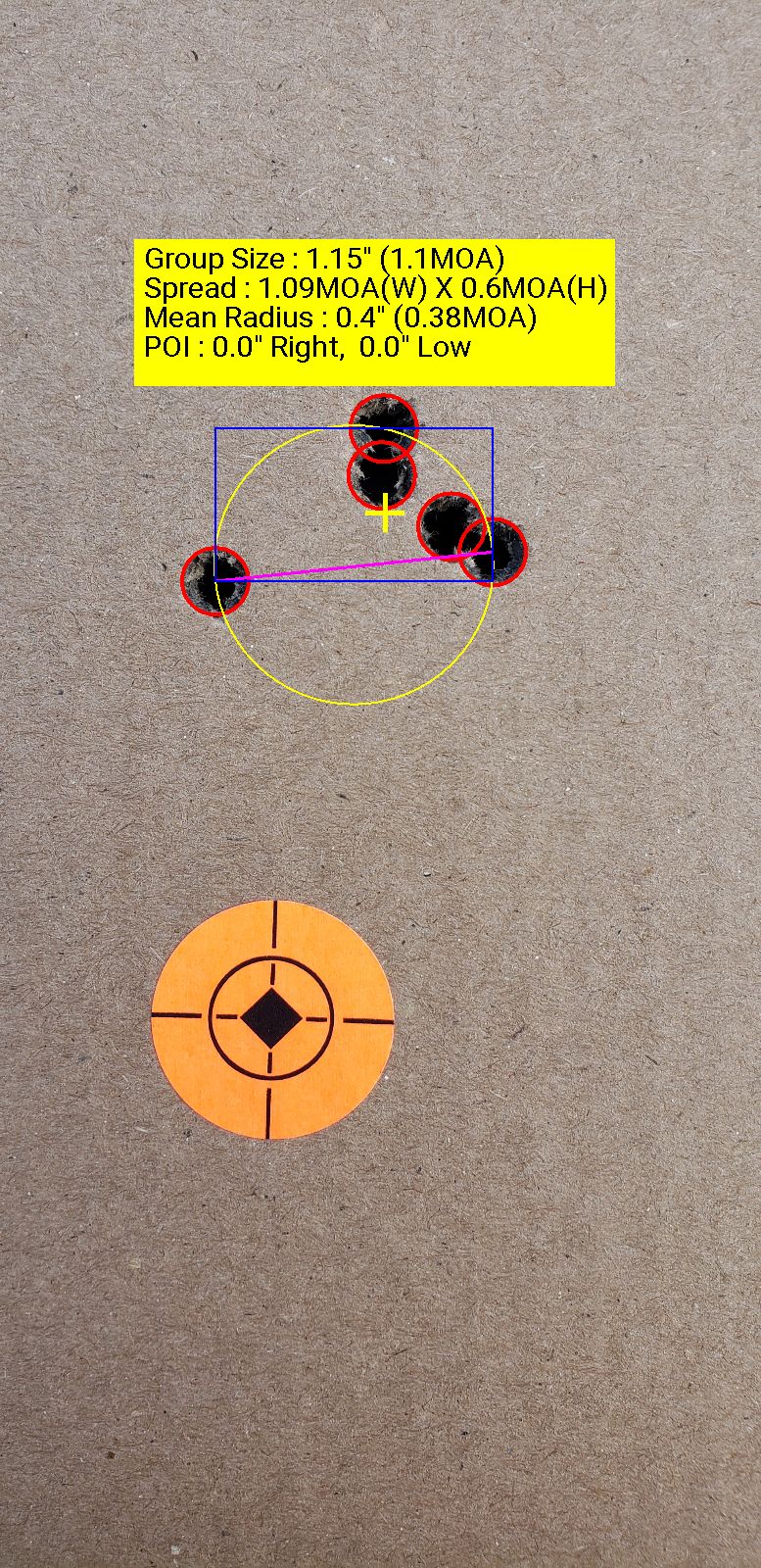

First time post, long time lurker. Ran a search and couldn't find anything that "popped" out for my issue.
A buddy and I are trapped in commifornia and cannot escape the requirements to use lead free projectiles. We are both savy handloaders and load for precision on a myrid of calibers. My go to hunting rifle is a 270 winchester and he is currently running the 6.5 cm.
The issue we are having is we cannot get his 6.5 cm to run the monolithic bullets and get any sort of accuracy. My ole deer rifle is getting just about 3/4 moa using the Barnes 129 LRX (fine for my hunting accuracy). His CM cannot even come close to 1 moa.
Currently we've ran close to if not over 400 rounds of different monolithic bullets and cannot get them to group. We've ran ladder tests and found nodes, we've changed seating depths. Varied the powder types. We are currently kinda stuck and about to change bullets again.
The bullets we've tried for the 6.5 are:
Barnes 127 LRX
Hornady 120 gmx
Hornady 140 GMX (horrible by the way)
We know it's not the rifle or the setup as we can throw factory 143gr eld ammo through it ant it prints a 5 shot group at about 1/3 - 1/2 moa.
If you have any experience running a monolithic hunting bullet or have an idea what to try please help.
(pic is the very best we have and cannot get it to repeatedly shoot that accurately.)

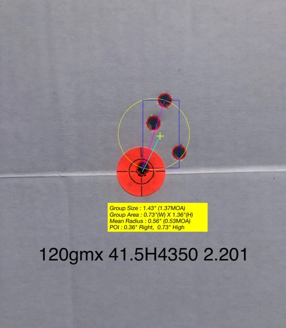

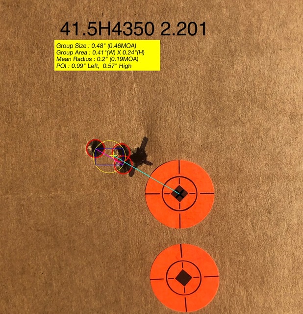

UPDATE.... So it’s been almost a YEAR since this was posted and I am still have issues. I have tried everything posted above 10 times over and still can barely get 1.25 moa out of this rifle with monos. I have switched to the Lehigh 130gr Controlled Chaos bullets as of now they give me the most consistency at 1.25moa and the occasional moa group. For a hunting rifle this will do though I would like more. I am pushing this with 41.5gr of H4350 @2830 fps. I still haven’t tried the Hammer Hunters but those are on the list whenever I can get some.
