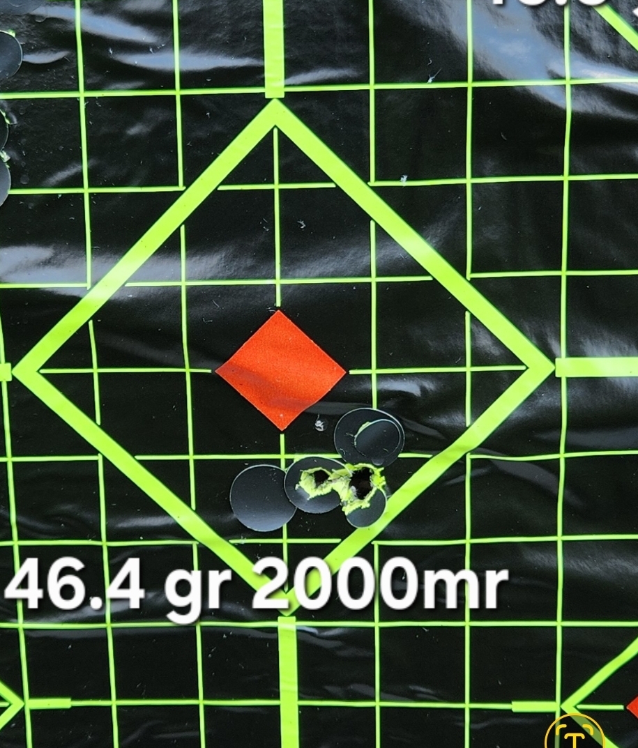

#1- Averaged 2605fps and .30" 5 shot group (No pressure Signs)
#2- Averaged 2614fps and .65" 5 shot group (No Pressure Signs)
#3- Averaged 2627fps and .88" 5 shot group (Very faint ejector mark)
#4- Averaged 2635fps and .55" 5 shot group (Again faint ejector mark, easy bolt lift)
#5- Averaged 2644fps and .23" 5 shot group (Ejector mark and at the very top of the bolt lift it was mildly sticky at the very top)

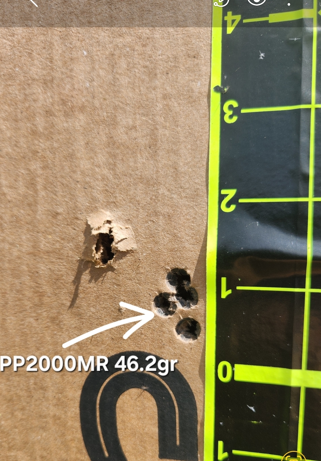

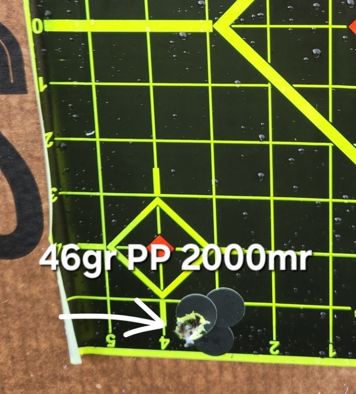

Power Pro 2000mr was a little lacking in the velocity dept.
My max load of 46.6 grains topped out at 2635 but should have been faster. My thought is that I am not getting complete powder burn. I found some partially burnt kernals in the barrel
The 46 grain load was absurdly accurate and had an average velocity of 2615.

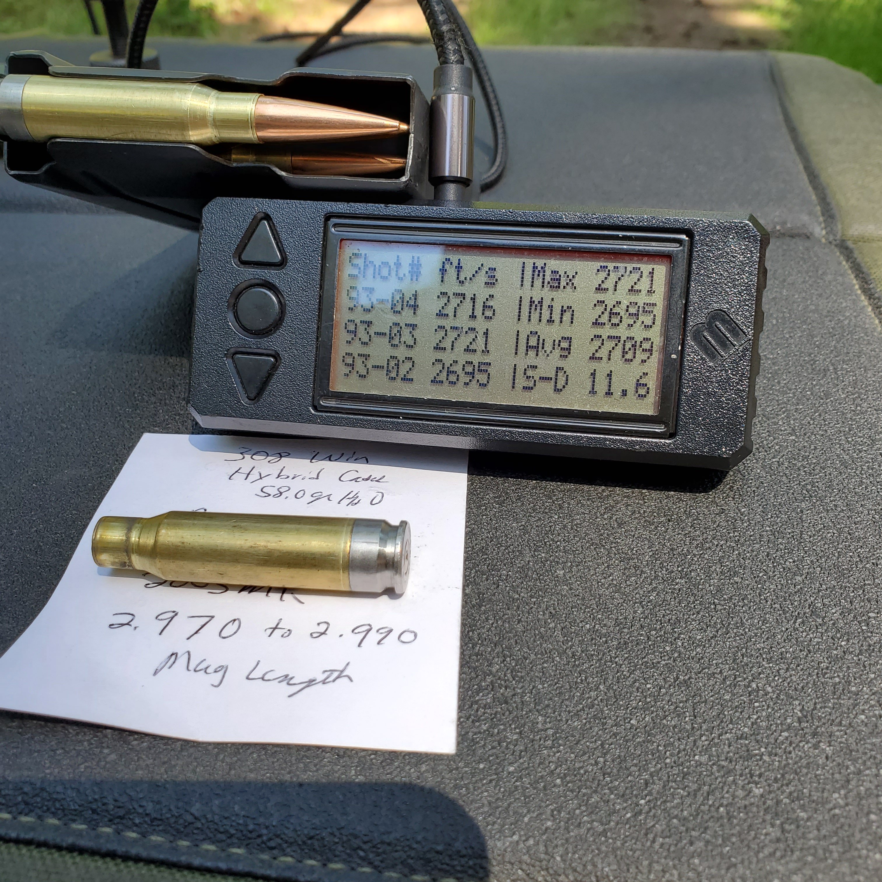

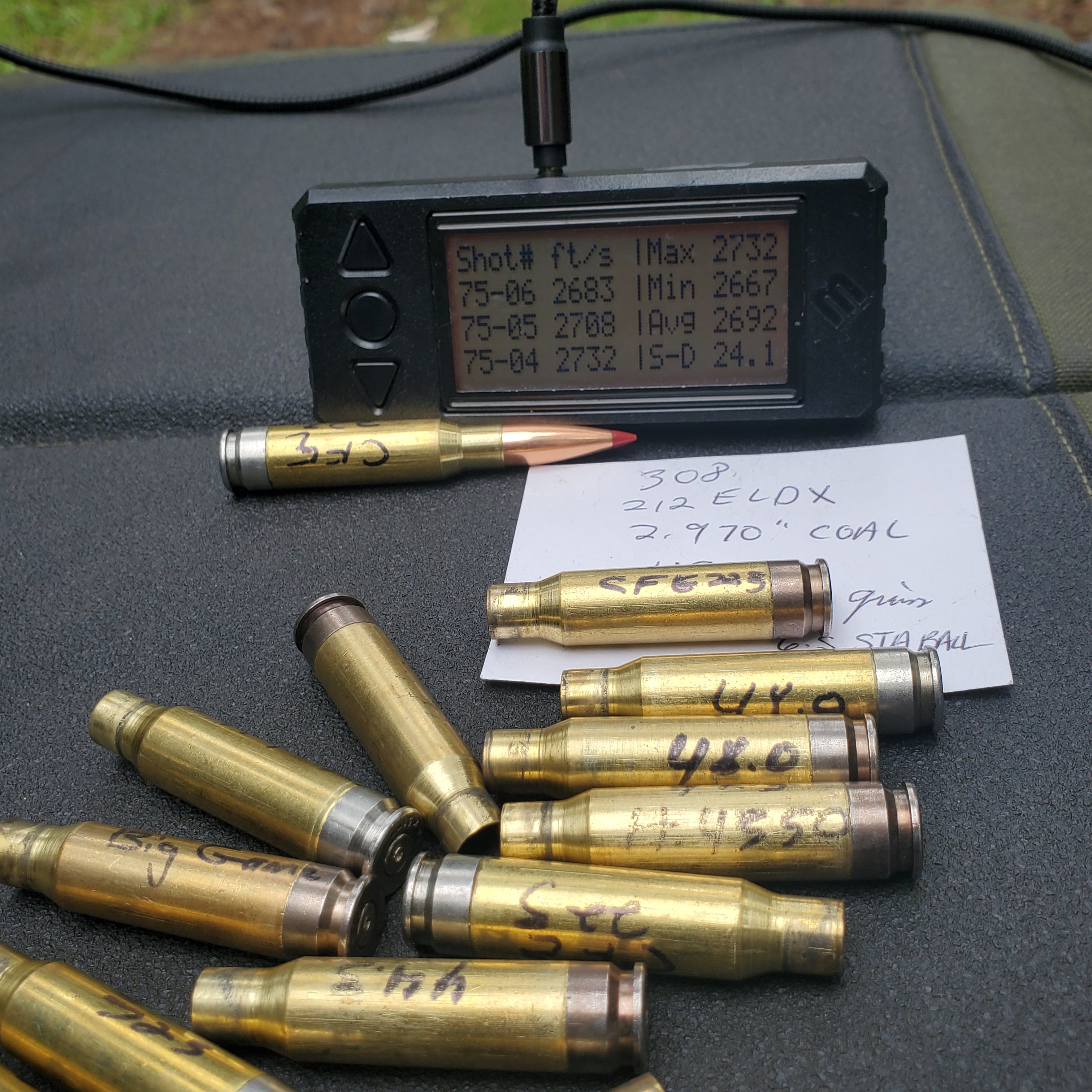

Here's the 22" 308 with SA MDT mag length 2.970" 212 gr eldx at 2700 fps in load development, and 200 SMK in the mag 2700 fps, and 230 Atips at 2600 fps 9 twist 22" ...but with hybrid cases.

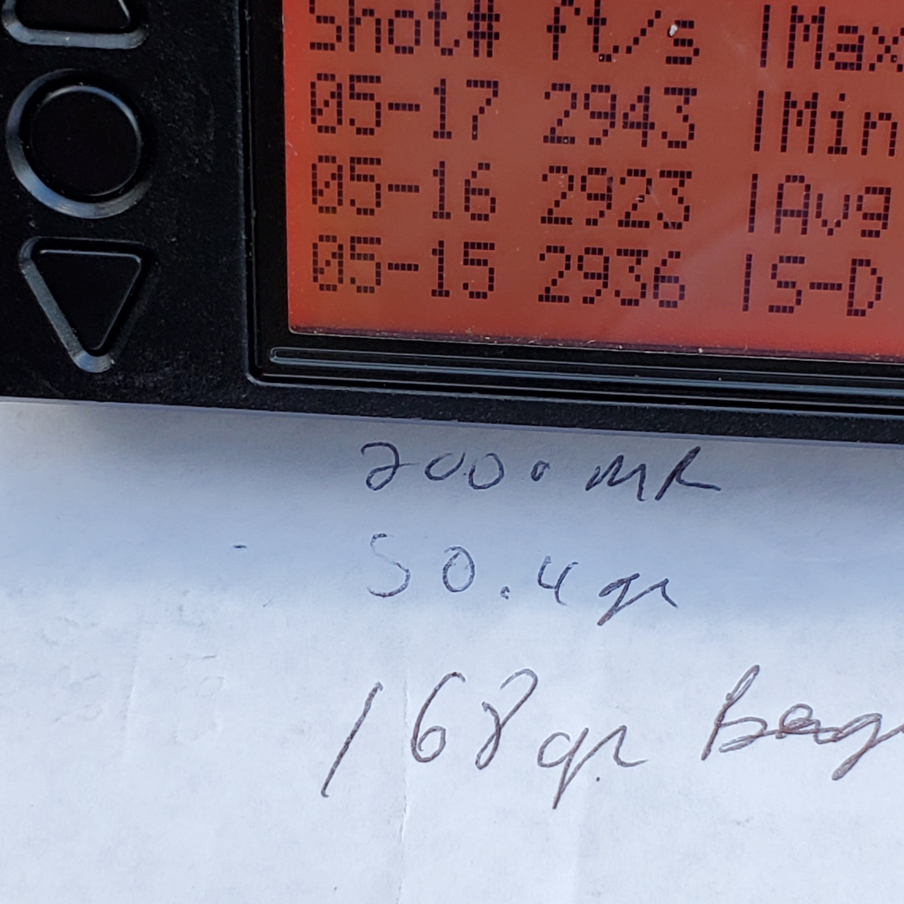

Agreed on the barrel length for sure. Must admit though....I really enjoy this rifle. I have another action that may end up with a longer barrel on it.

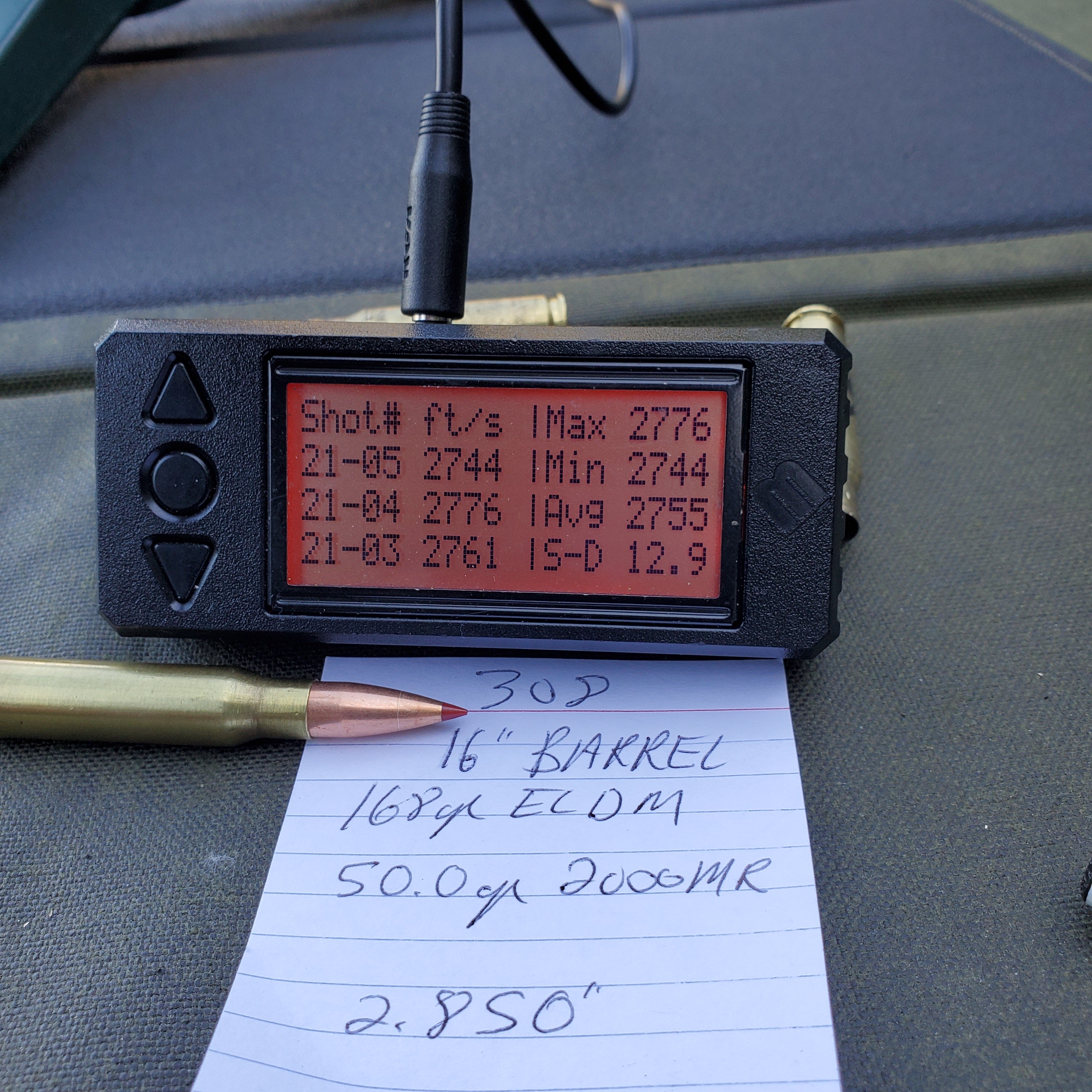

You may get 3000 ft-lb with these loads I use in a 16" 6 lb AR 10... if your 20" can pick up around 100 fps in 4 more inches of barrel.
Set your rifle up for sucess MDT detachable mag without center plate will feed 2.990" cartridges...2.860" is losing performance are the short barrels.
I lost over 40 fps per second using Small Rifle Primers in Lapua Palma brass over their standard LR primer brass...depending on the powder ya lose velocity with SR primers especially when using 50 grains of powder...ya have to add more powder with SR primer to get the same velocity, and S/D s are much better with heavy loads... SR primers are OK in warm weather and target loads with easier to ignite powders.
So I do not use SR primers in high performance loads.

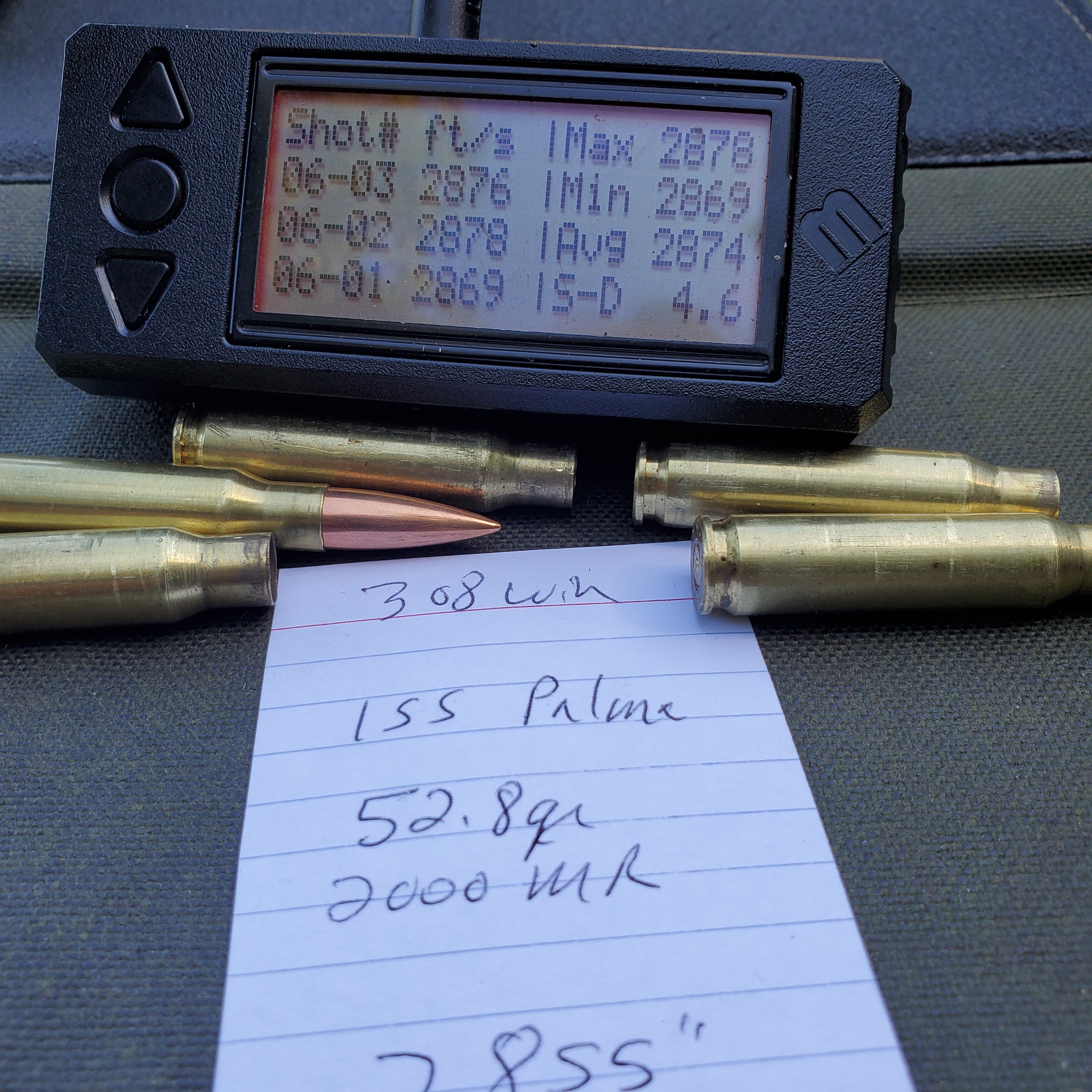

Here are some lighter bullet loads that worked in my 16" AR 10 with 2.855" cartridges. With 4" of extra barrel you'll might reach 3000 ft-lbs.

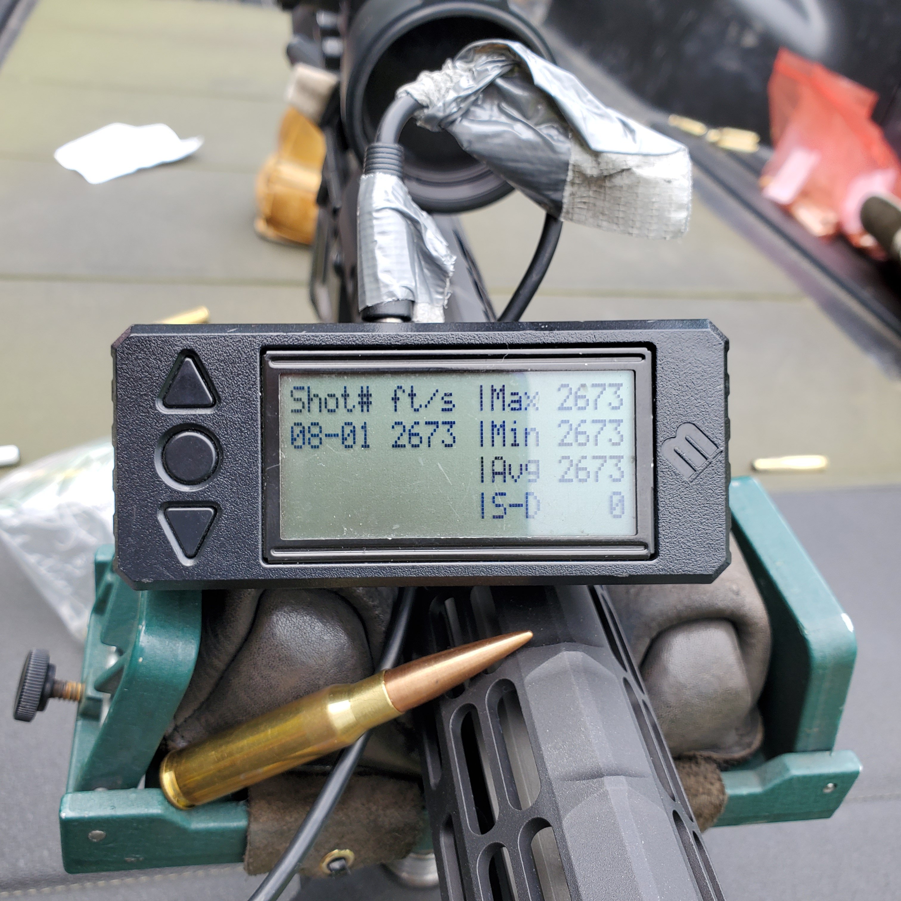

Another example AR 10 200 gr SMK .715 g1 BC 2673 fps out of 18" AR 10 single load.
Its how you set up a 308 that gets 3200 to 3400 ft-lbs in 22" or 3600 to 3800 ft-lbs in a 30" long action...and more.
My 22" was built for $600, I chambered the new Rem Varmint contour 5R 9 twist barrel for heavy bullets 200 to 230 gr and a bunch of used parts...inleted for detachable mag , MDT detachable mag for 2.990" and muzzle brake...just "normal everyday 308 builds", that most gunsmiths do, you're missing out on a lot of extra performance.
I've built 8 308s from 16" to 30" and twists from 12 to 8 twist, light barrels to heavy palma...even hybrid cases...lots of experimentation with the 308.
Work up... use at your own risk.

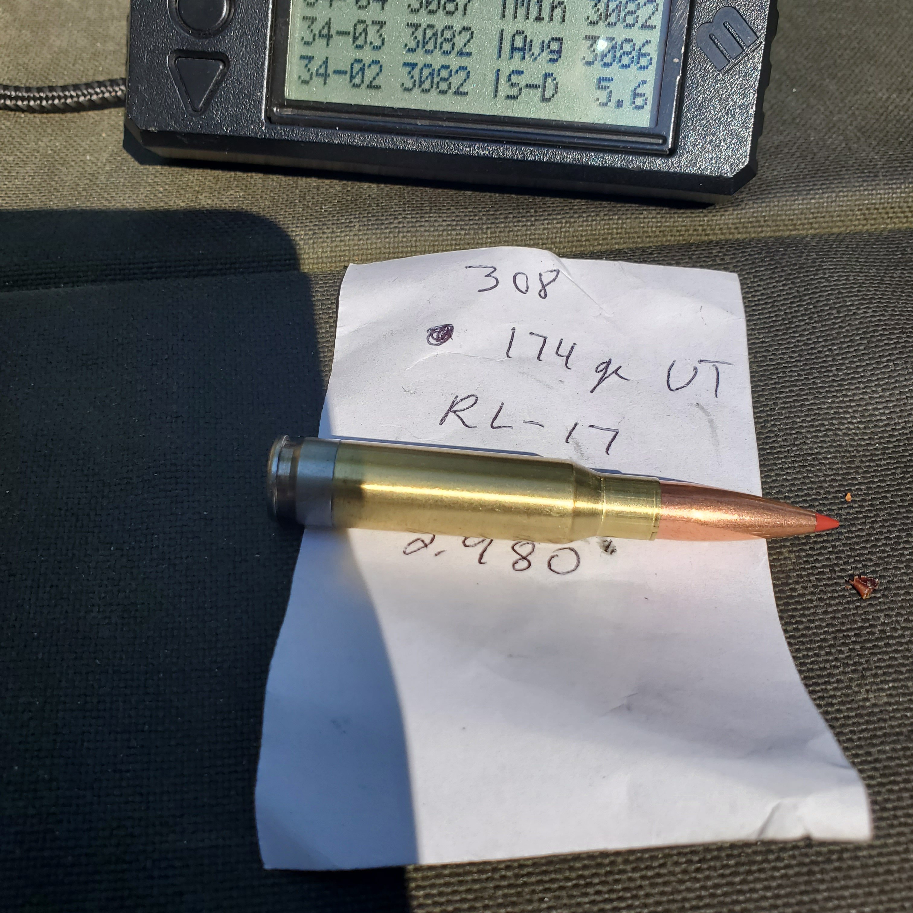

I purchased 500 174 elvt to test...but was running 177 at 3045 fps in 22" barrel and hybrid cases.
RL 17 was the powder.

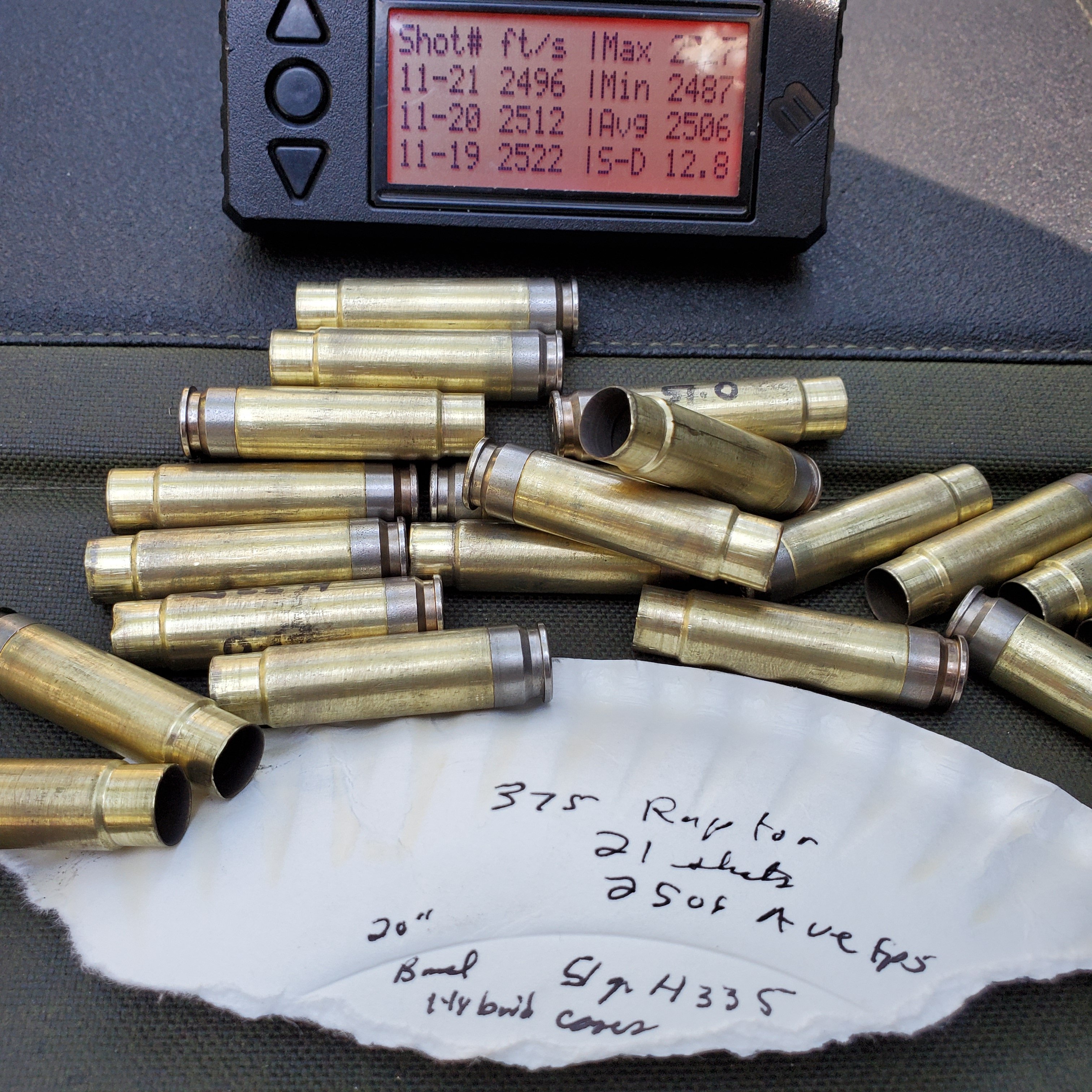

I'm working on 375 Raptor and 350 gr SMK which should arrive tomorrow. And 700 gr AP for the 510 whisper which arrived today.
The 174 gr should be over 3100 in the 30" 308 and hybrid csses.

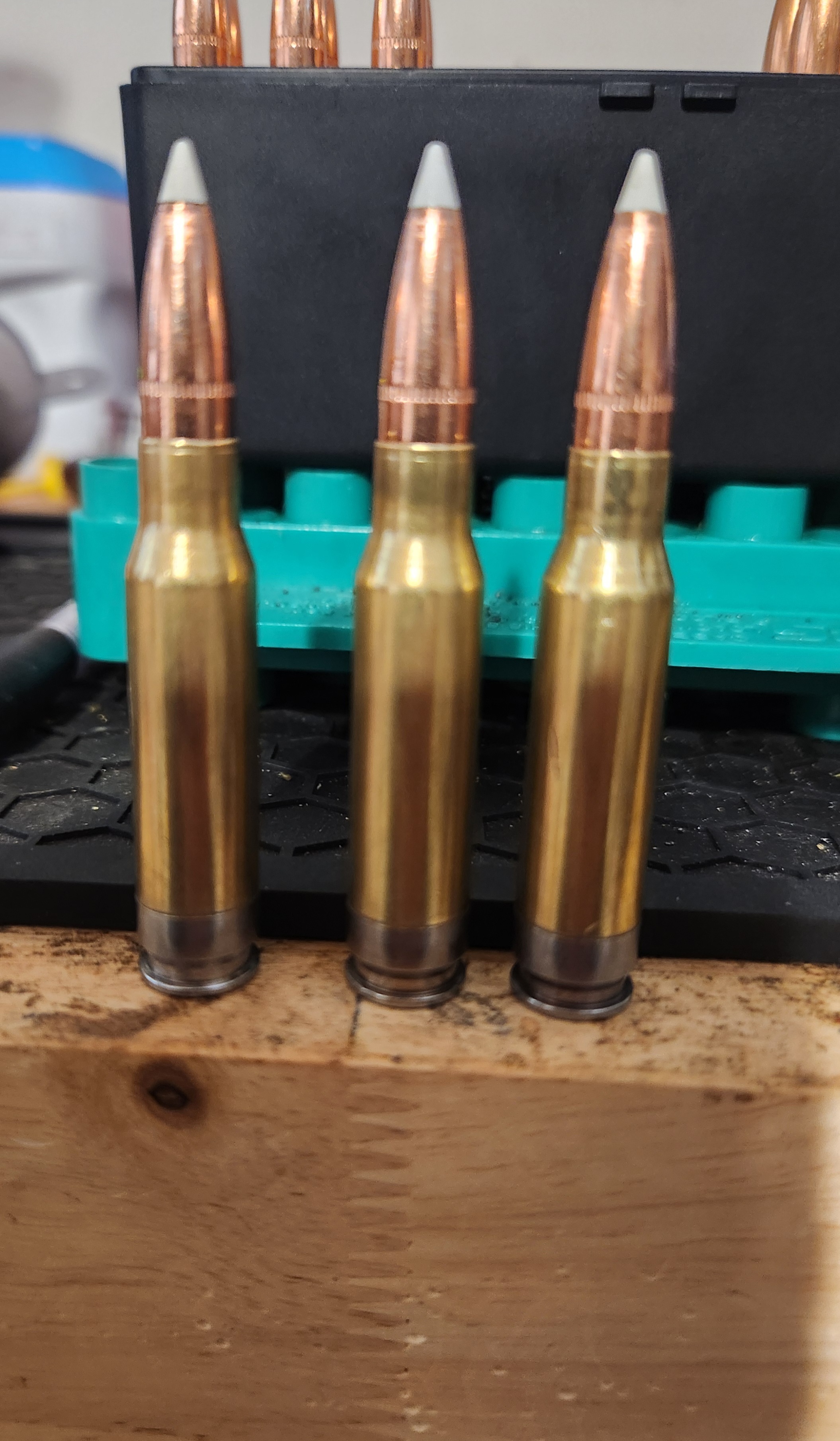

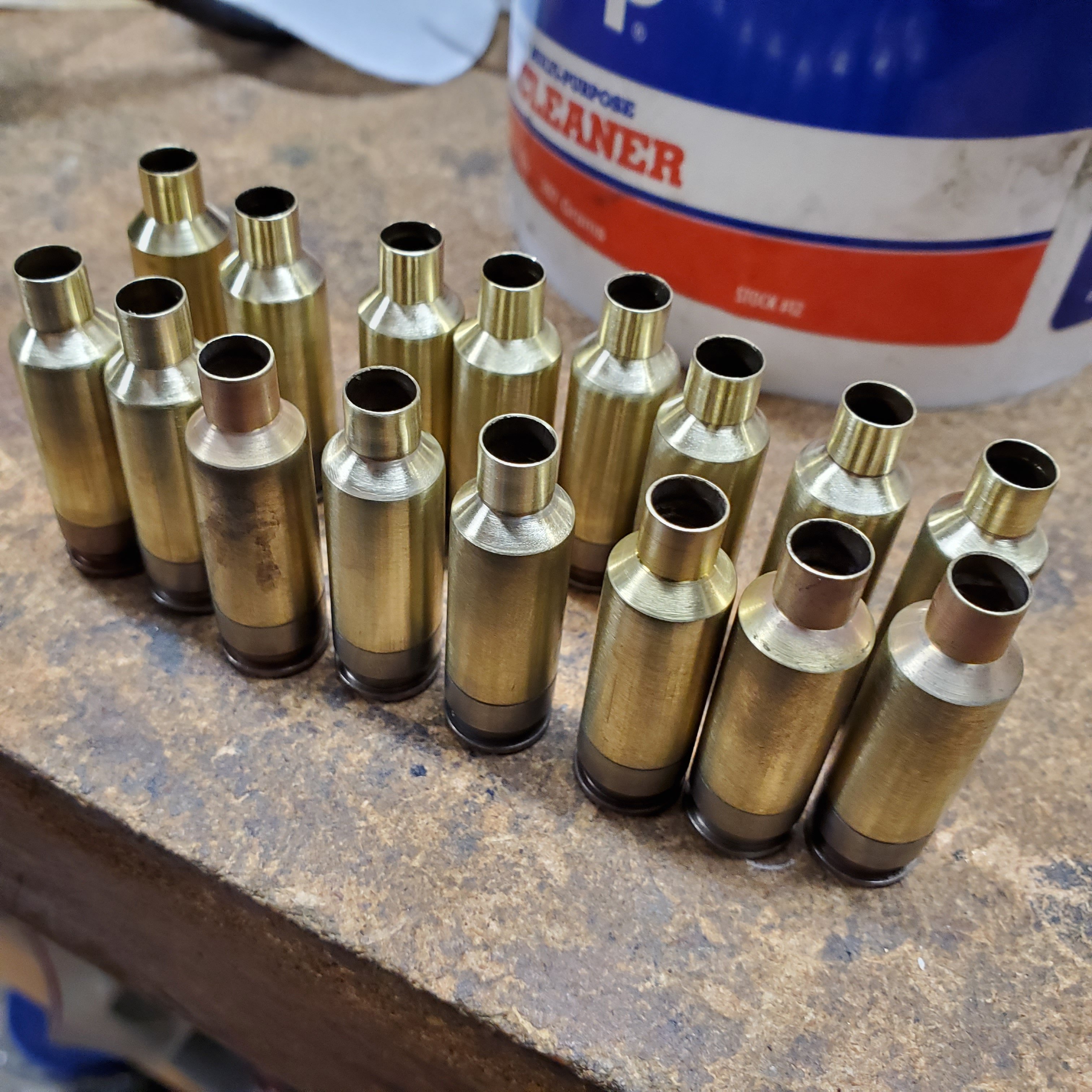

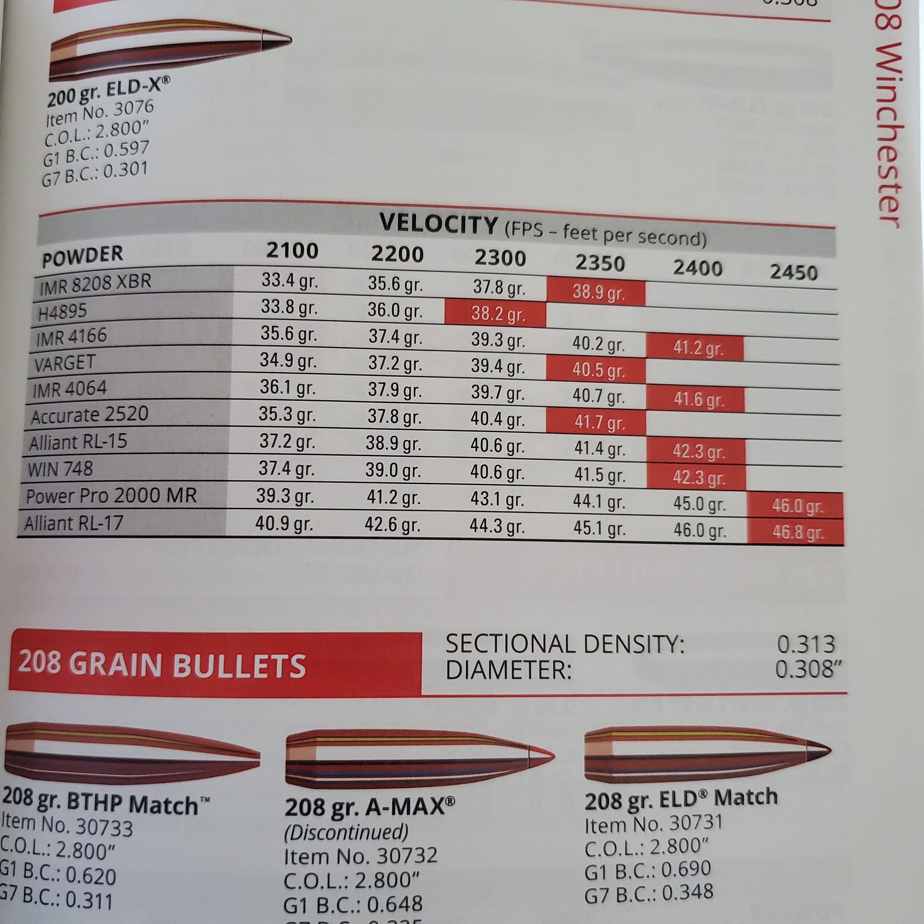

200 grs is a fairly heavy bullet for 308 and RL 17 is listed there...here's their data for the 200 gr.
I run the 200 gr SMK .715 G1 BC over 2700 fps in a 22" 9 twist Rem Varmint contour barrel in 308 at my mag length with RL 17.
Utilizing modified hybrid cases.
Dangerous...Do Not try these loads in any brass case.
These hybrid cases are made from 6.8x51 hybrid military cases, formed, neck turned, and annealed.
If you reload you can do the same with a little extra work...and ya don't have to run full power loads.
Also run the 230 Atip in the 22" barrel at 2600 fps with RL 17 and hybrid cases.

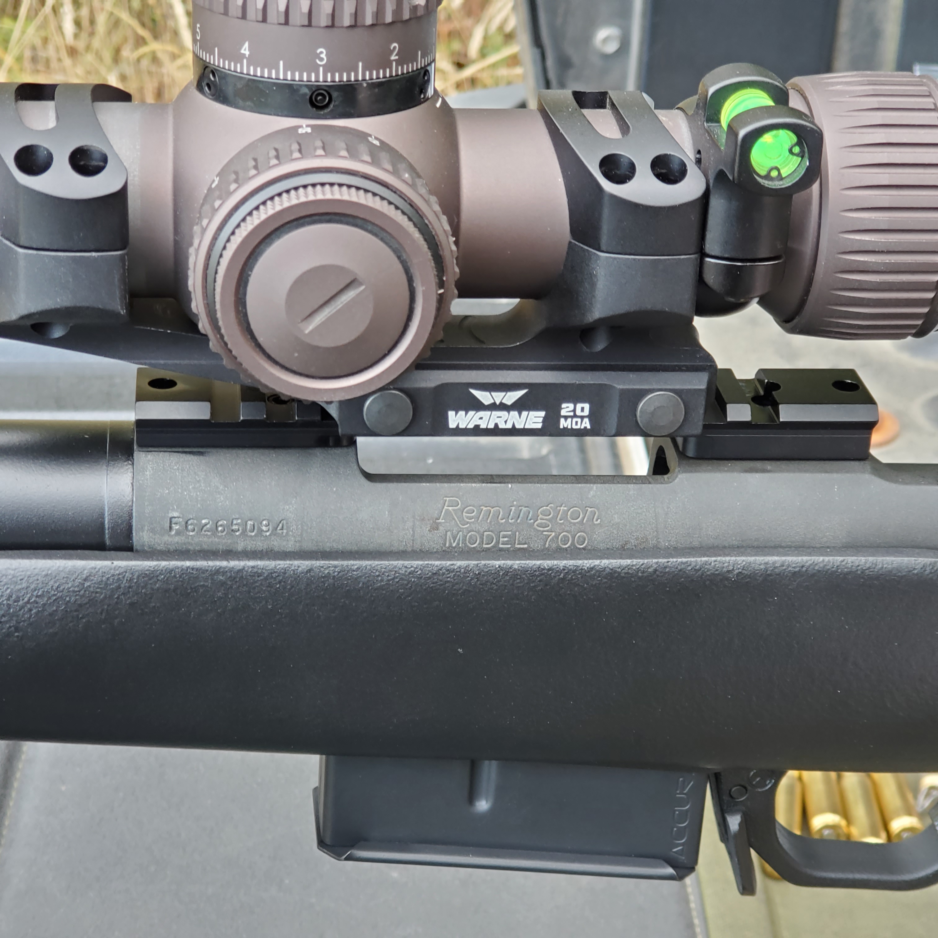

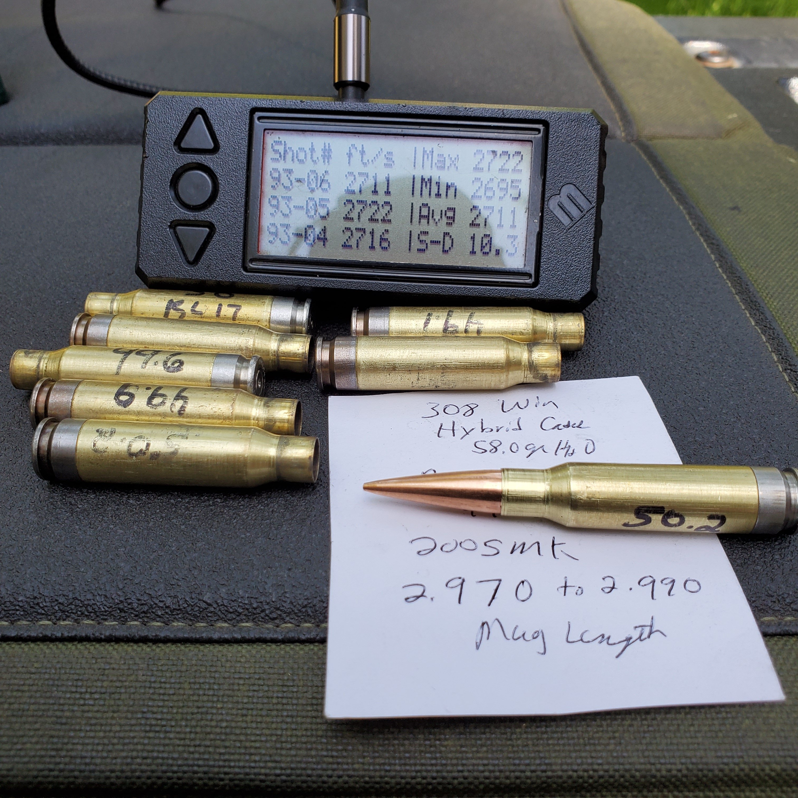

Here's the 22" 9 twist 308 Win light "walking around rifle", shooting 200 gr SMK at mag length....using RL 17 and hybrid cases.
This 200 gr bullet is loaded out longer to over 2900 fps in the long action 30" heavy palma 8 twist 308.

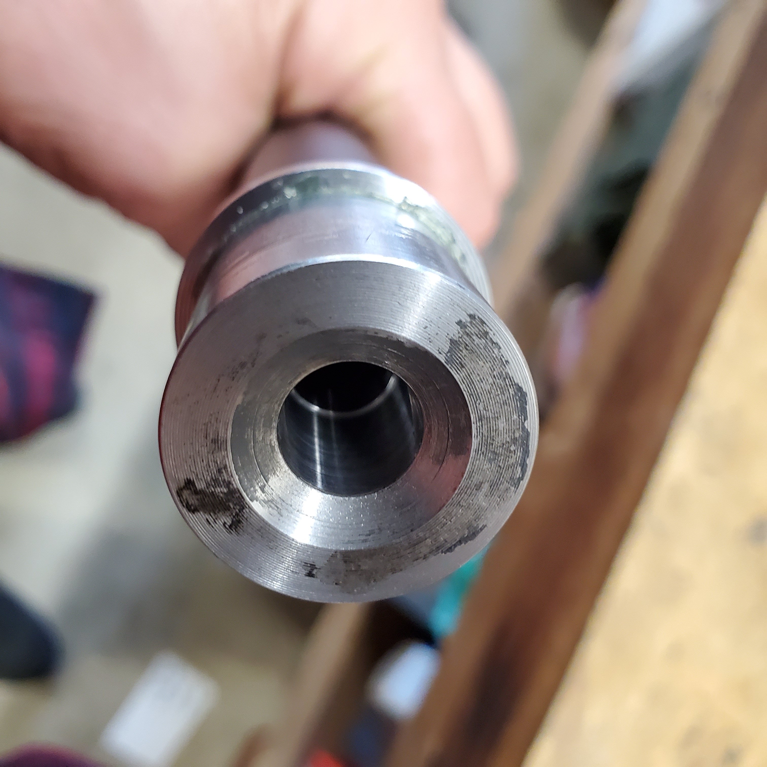

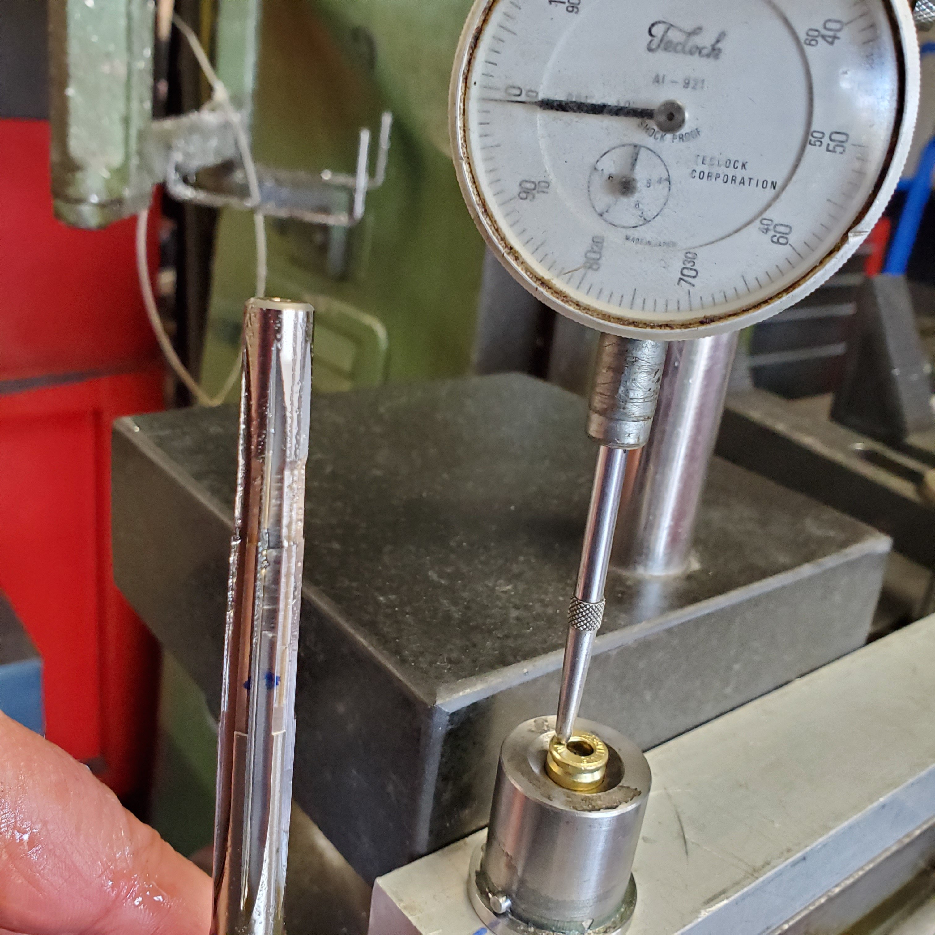

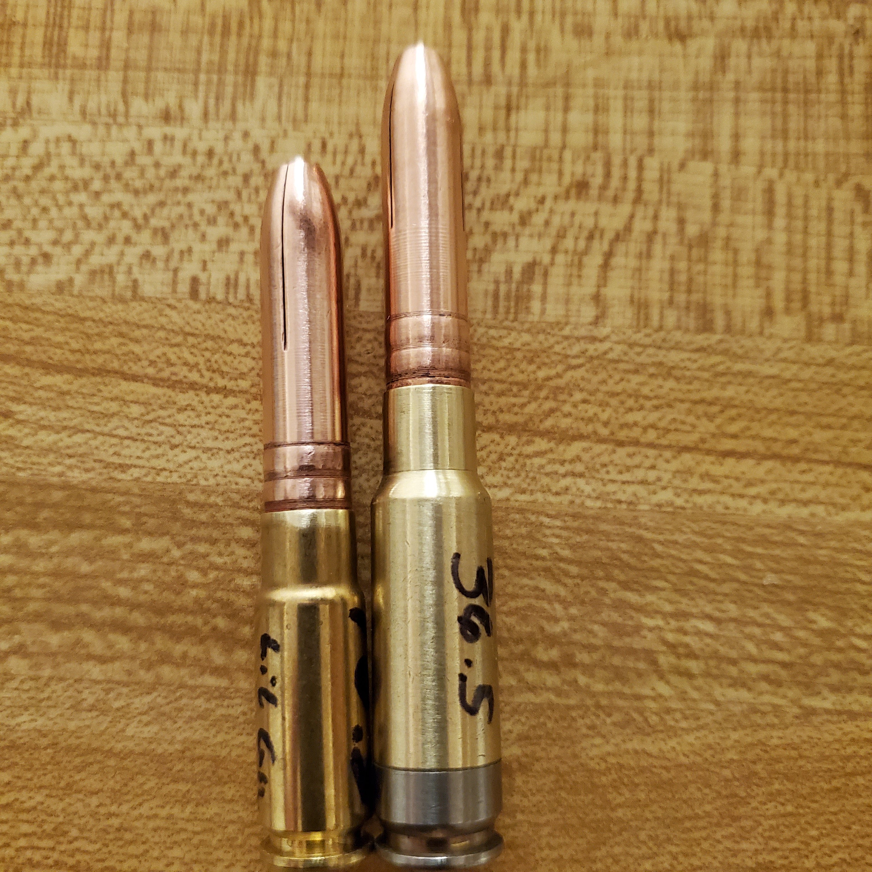

You already decided hybrid cases are not for you...no further discussion is necessary. Don't use them, ...& be happy.
Can't be scaring the chambers because that portion of the case is all brass LOL...maybe .090" in transition from Stainless to brass actually enters the chamber.
So almost all of the S Steel head is hanging out of the chamber so your bolt can grab onto the case head for extraction.
The post is about "more fun with the 308"...there is alot of 308 fun to be had,... hybrid cases are just part of the fun.
I've made hybrid cases for 308, 358, 8.6 blkout, 375 raptor, 6.5 CM, 6 mm Dasher.
How about some accurate 308 subs...or hollow pointed 30 Mauser 86 gr jacketed pistol bullets out of a 30" 8 twist 308.
Inquiring minds want to know...
A variety of calibers with hybrid cases, some with very heavy bullets...including a 308 250 Atip at 2515 fps.

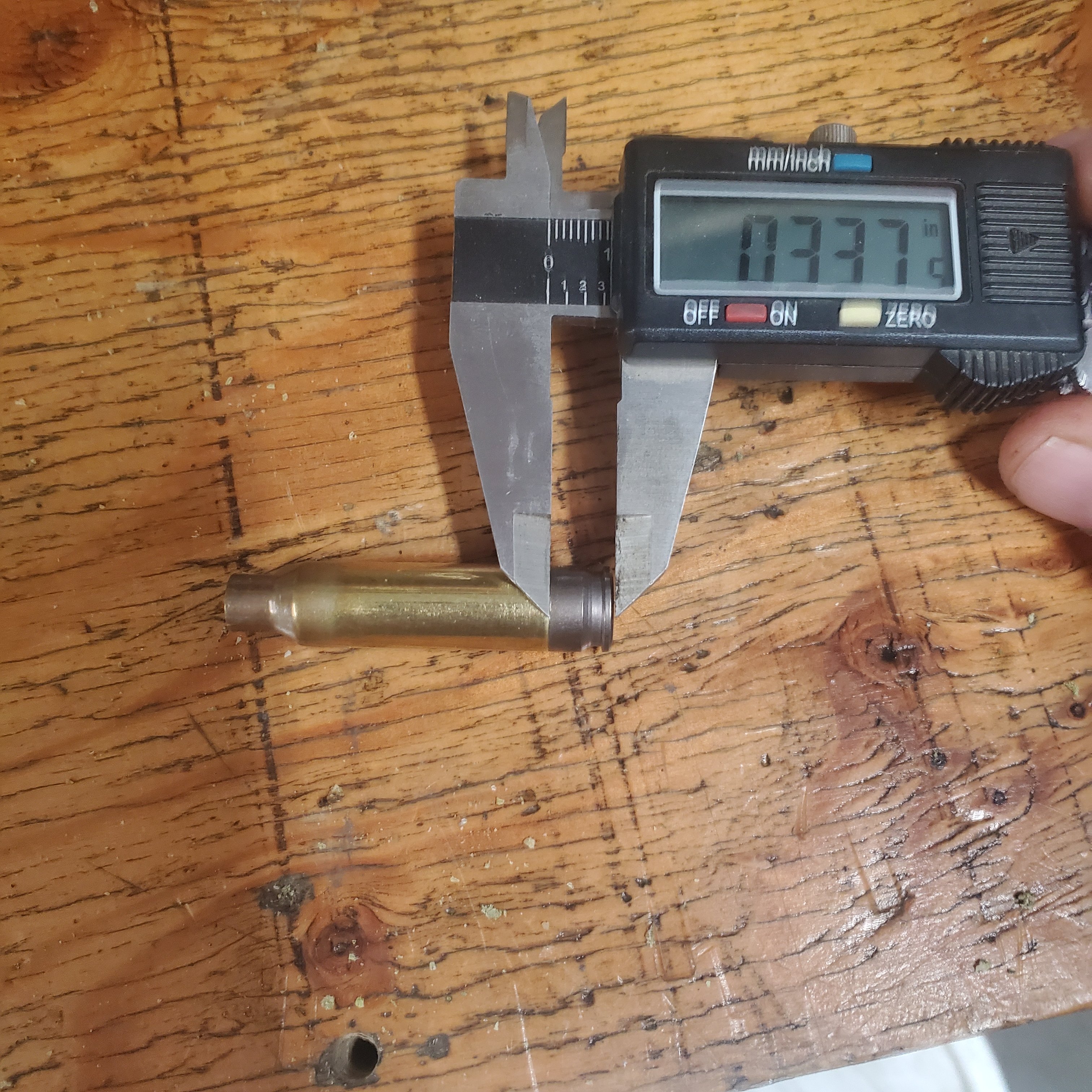

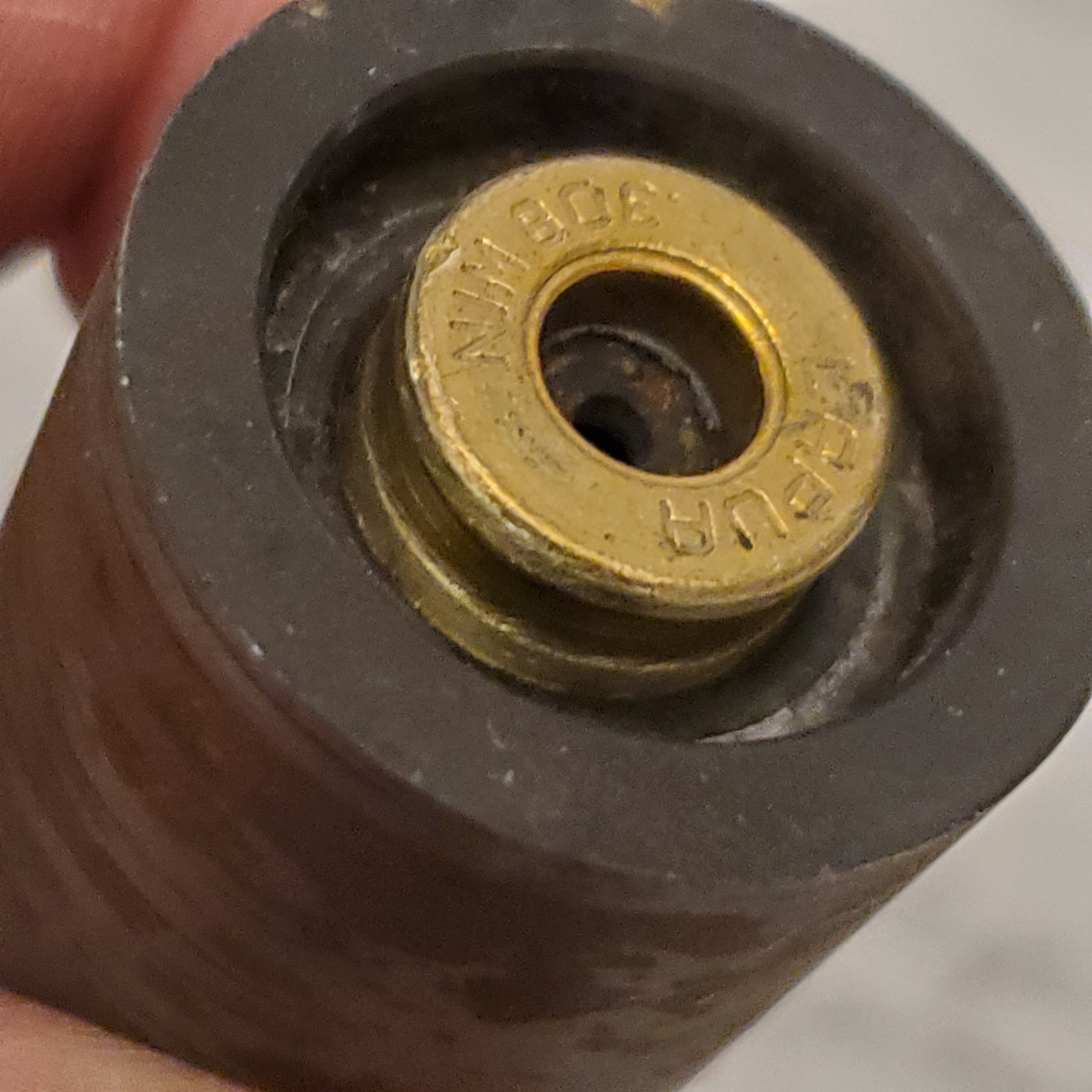

I resized a couple of those binary cases and they held 1.1 grains less H2O than the Alpha Brass I have been using. Thats pretty substantial
Good to weigh them for water capacity.
The hybrid cases will usually gain a fair amount of capacity after firing...depending on your chamber they usually equal or surpass other case volumes...but newer hybrid cases have been showing less case capacity then the first years production.
It's been reported that LC is making them now, and they are a bit heavier, with 23 and 24 date yrs stamped on the case heads.
My older Sig hybrid cases with no date stamp measure 58.3 to 58.8 gr of water capacity after fireforming. If you see any load data and your cases are of less capacity your maximum load must contain less powder...

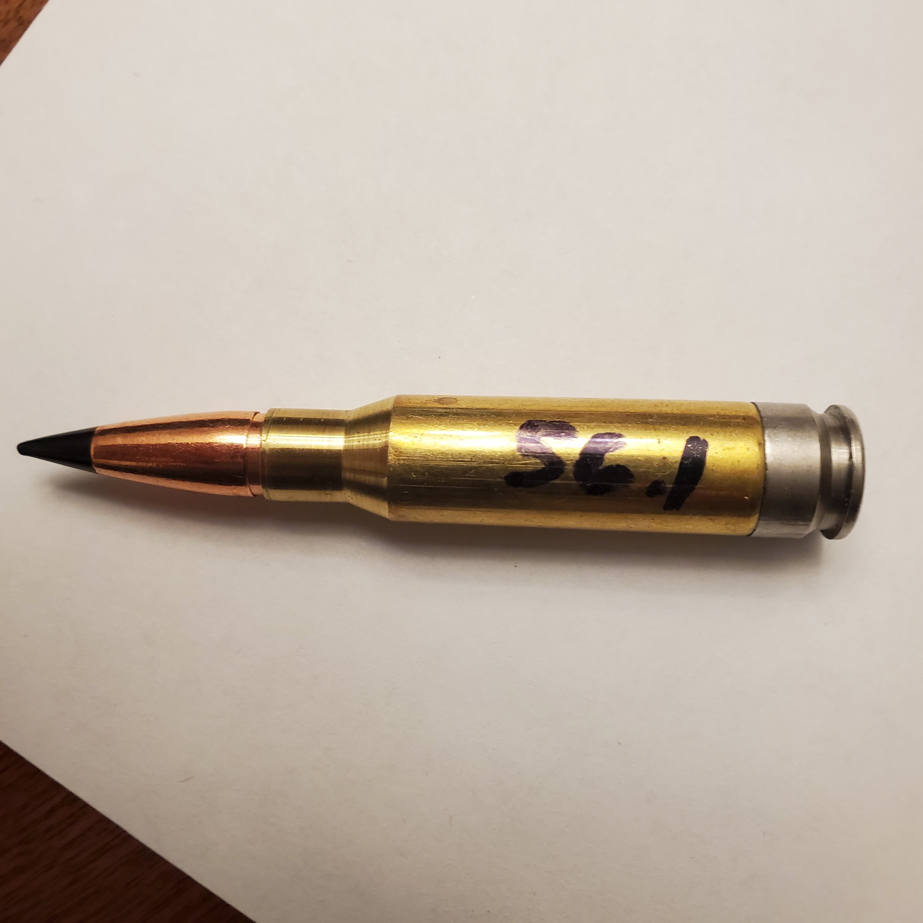

This 308 test load does indeed contain 56.1 grs of powder...this was over 3500 fps in a 22" barrel.
And a variety of powders behind the 212 gr eldx in 308 with hybrid cases fulfilled on a request for that bullet and max loads were refired for different powders in the 48 to 50 grs area.
Case capacity changes make a huge difference in pressures....so beware, and always check yours vs the other guys in the data.
The hybrid cases also usually need trimmed to length after the first firing.

Those who wanted some 308 Win data for the Hornady 174 gr ELD-VT velocities from the hybrid case.
This is a good load fastest tested today with low S/Ds 3086 fps with RL 17.
Also shot some 174s with Varget = 2858 fps, RL 15 = 2877 fps from the 22" barreled rifle.

I hit 2850 with the 180 grain Gamechanger using Power Pro 2000MR, Alpha SRP brass and CCI 450s. I blew my first primer with this load however that piece of brass is on its 15th firing all of which have been over book max. This is from a 20" barrel. Bolt lift and extraction still smooth on the origin action. Accuracy was acceptable at 1" 5 shot group. Several other groups were smaller so will focus on refining those. SDs were all higher than I wanted.
Just going off memory here but I believe a impact has a .940 tennon length and a .948 headspace. 0.150 bolt nose recess. So .330 minus .158 equals 0.172" of case in the physical chamber. Does that math check out for actual gun smiths? I believe most actions with a "3 rings of steel" recessed bolt face are about the same.
Another way of looking at it is 0.130" of steel case above the .200" line of the case in the chamber. The .200" line with brass cases is the spot i measure case head expansion of fired brass at on traditional cases to check expansion and pressure. Are you seeing much/any growth at this point on your fired hybrid cases?
.172" plus the chamber radius .015" ? of the sold case head is Not supported by anything.
The 3 rings of steel do not support any of the solid head that sticking out, ...from the chamber radius to the bolt face.
The .480" dia bolt face recess does not support the .469' to 470" case head.
Three rings of steel are there to contain the burst or explosion along with the vent in the action.... in an over pressure event, so big chuncks of brass or steel don't enter your face...but the finer chunks of brass will escape with enough velocity to penetrate your face and eyes, along with the high pressure gas released.
But if the bolt recess shatters, what is not contained by the counter bore in the barrel it's coming for your face along with the brass case head fragments now in much larger pieces to do some real damage to your body.
The .700" X.150" counter is usually. 155" or a bit more deep...clearence all around the individual bolt. There is a radius on the rifle chamber not taken into account.
Everything has a bit of clearance added so a little debris won't shut down the guns operation.
The 3 rings of steel are containment vessels, a safty measure,...as no actual support for the solid case head exists as it's sticking out of that chamber.
The majority of the expansion is around the .200" line cause the brass is thined out, now it can expand and seal the chamber of your rifle as designed.
This is what your FL sizing die sizes down to make clearence between the chamber and newly reloaded round....most of the solid case is not sized.
As you have the rim extractor groove and die champher taking up that area of the solid head.
While the solid head has no expansion or very little like .0005" to .0007" too much above that and primers begin to fall out of their pockets much sooner than expected, but some will run over .001" case head expansion. Your call...
Stainless expands at higher pressures, that's why it's used in hybrid case heads...
Another example of solid head has no support .
This is a recut 9mm chamber .001" deeper than factory to clean up the dia of worn out chamber reamer used as it wouldn't chamber unless bullets were undersized.
Notice the large chamber lead in angle causing even less case support.
But it will handle +P loads well above standard pressures into the 40,000 psi
area.
