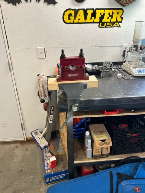

Part of the issue other than cost is i dont want to bolt one to my workbench, but maybe I can bolt it to a board and take off my bench vice to use its holes to temporarily mount the board to the bench.

That’s what I do, old board with some holes for the vice bolts, clamp it wherever, usually it’s hot so I go outside and slap it on a trailer in the shade and breeze

My barrel vice is bolted to a short chunk of 2x4 I just clamp the wood in my bench vice when needed. My presses are actually on a 4x4 that I also clamp in my vise
Oh even better if clamps are enough to hold it on. I was thinking to use the bench vice holes to bolt the board to my bench, but clamps are even easier if they are strong enough.
