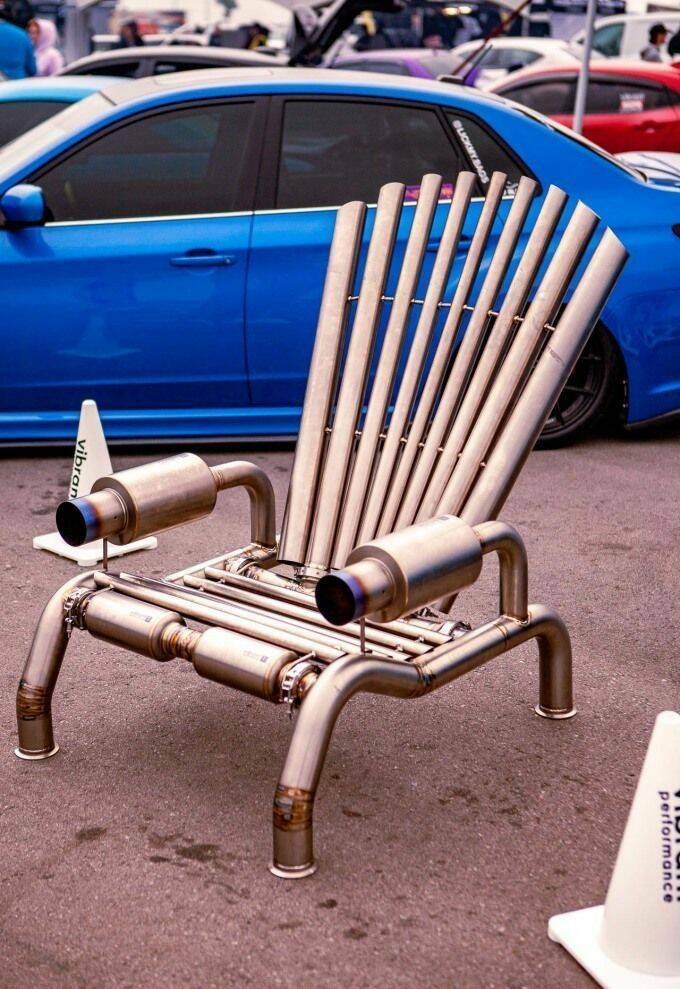

That’s some dam good welding!!!Just about have my race rig setup. This should keep it from diving in the corners.

That's going to leave a snail trail on the seat...
