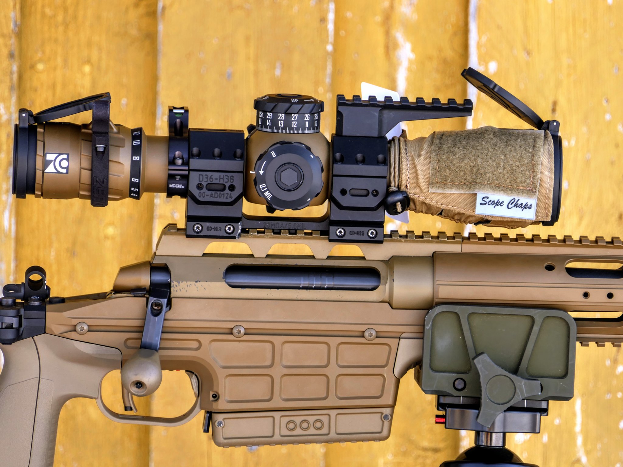

I looked at these but at the time they didn’t have a ton of attachment points for red dot mounts and stuff. I should look again.
Both sides and top, and on front and rear section.
So there is enough places to add attachments :)
Guess who´s picture that is on the front page ;)
