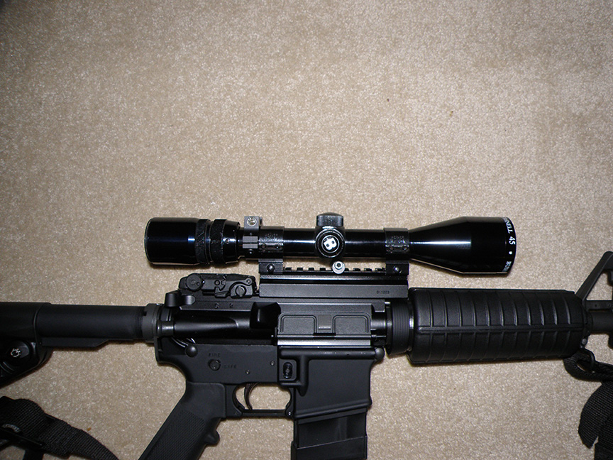

This is my Bushnell 3.5-10x45mm scope mounted on my Colt LE6920 M4 and it has perfect cheek weld. I suggest you take your AR to a sporting goods store and mount it there so you can see if it has a cheek weld that fits you.

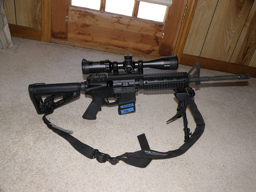

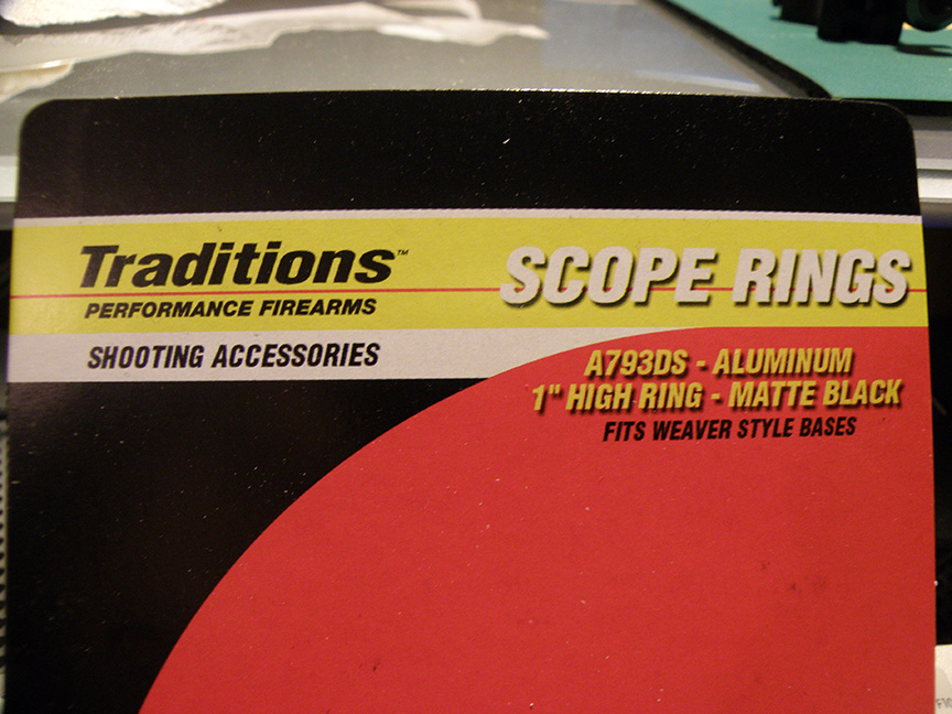

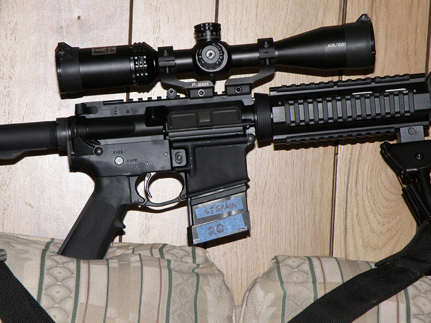

I ended up buying a Bushnell AR/223 (4.5-18x40mm) scope which I used the same mounts and I am much happier with the option of using 18 power if I wish to. I really love this scope.
With the new scope the riser cost $12 and the rings cost $14.

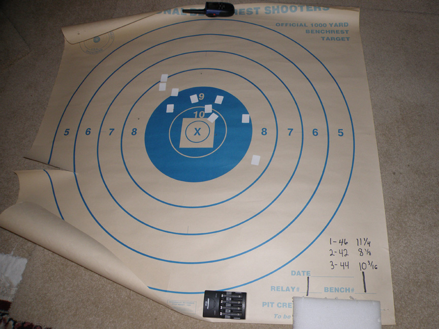

If you are planning on shooting out to 1,000 yds. I suggest you go with a 20 MOA instead of a 10 MOA. I shoot in competition at 1,000 yds. and with a 20 MOA rail which gives me plenty of elevation adjustment since I need 108 one quarter MOA clicks to get me in the center of the target.
I am also going to order these glue on for the elevation turret after I make my drop chart. They are very accurate. Range your target with a laser rangefinder then turn the turret to the yards, hold for wind and shoot. No computer necessary.
http://customturretsystems.com
