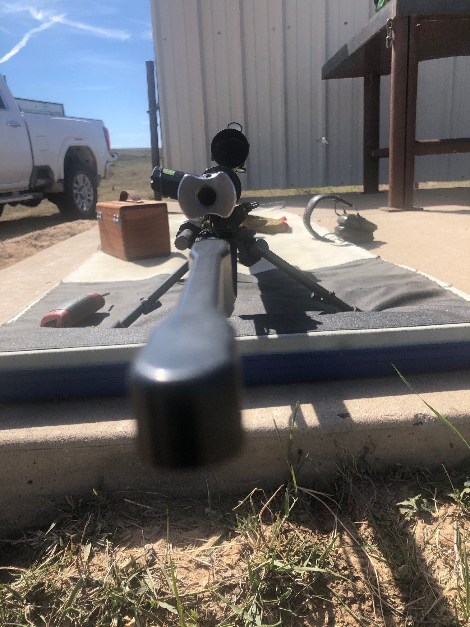

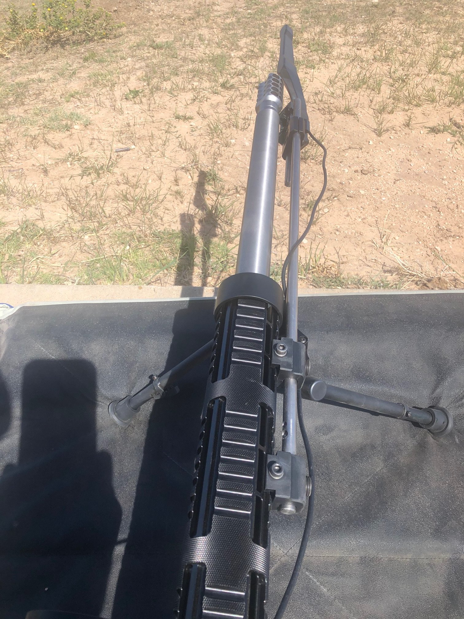

The next batch of Magneto speed mounts are almost ready. This batch features a double rod clamp which makes the unit useable on virtually any pic rail mount that encompasses the forend section. I will also be including my recommended (caliber/bullet material dependent) distance from bore to the flat bayonet portion - in order to get repeatable readings without effecting point of impact change when unit is removed.
Here are a few pics. Keep in mind the picture with the 2 pic rail mounts is actually the bottom of the forend tube when shooting the TUBBGUN. Notice how the double rod clamp allows infinite adjustability in approx. a 3" circle.

The spacing recommendations will be very helpful. That has been the only time I’ve been able to alleviate the POI change. But then playing with sensitivity comes into play.
Having it somewhat already figured out and included with literature is nice.
