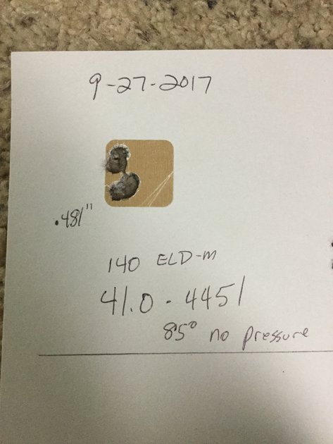

Try some 4451. My understanding is that it has the same chemical compound as h4350, but it has a slightly different grain structure, for a very slight difference in burn rate. I got this info from a Hodgdon bulletin, so it's not simply made up. 41 gr of 4451 with a 140 eldm rocks it pretty hard. Velocity is very slightly lower than h4350. Shot this today doing load dev. Two other groups that were slightly larger backed it up. Will play with seating depth now to see if it will tighten up a little. These were .010" off.

I'm having excellent results with 41.4 gr of IMR 4451 with the 140 gr ELD-M on my two 6.5CM rifles, velocity is a bit slow (2730 fps) but accuracy at 100 yards is sub 1/2 MOA.
