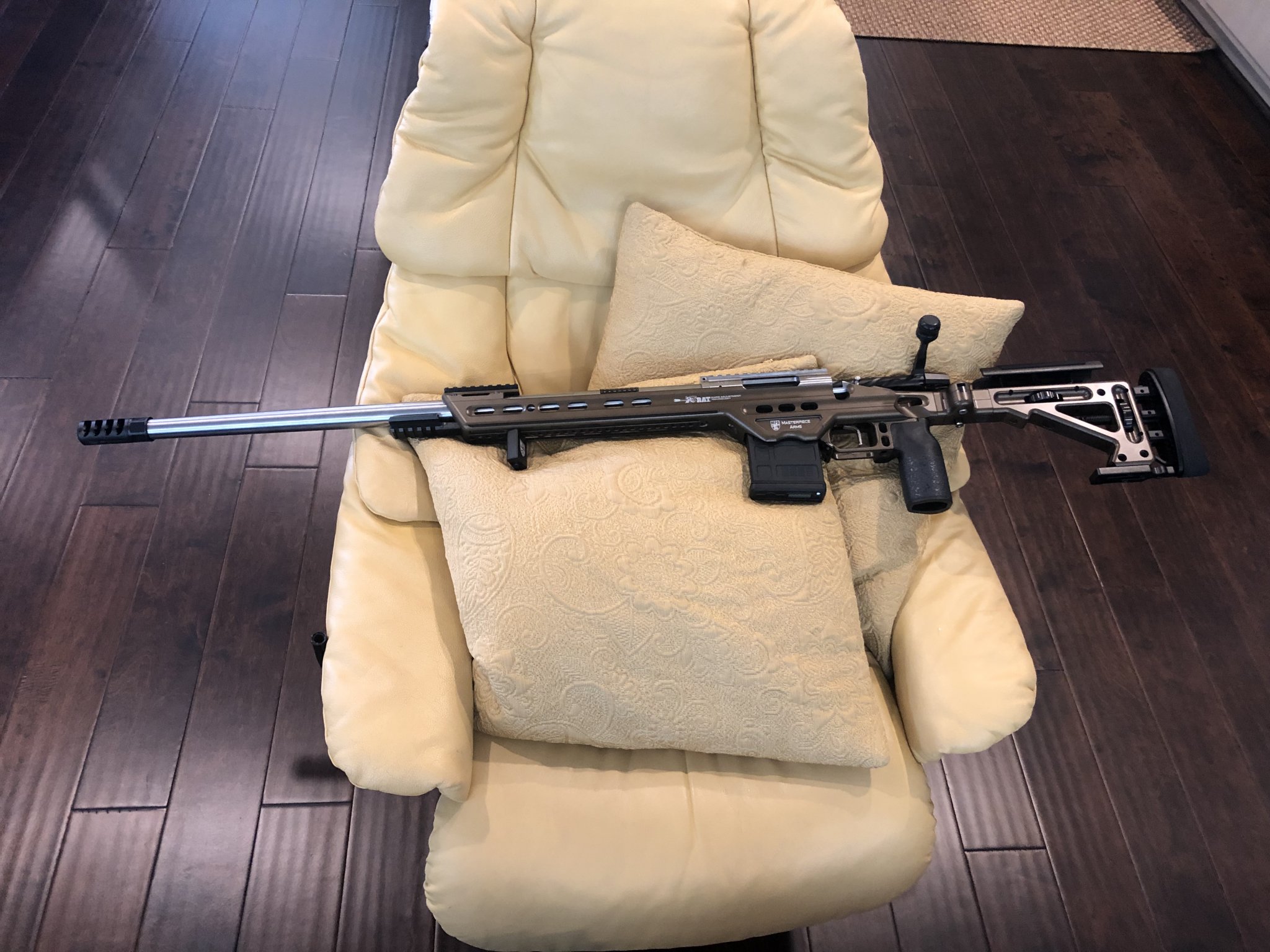

Picture of new MOA BA in 6.5 CM. MPA chassis, Curtis Axiom action in a v-block in the chassis, burnt bronze color, barricade stop, super adjustable chassis system.
Right handed but left eye dominant, and once you get to middle age, you will wonder what happened to your eye sight, so 4 years ago switched from shooting right handed to left handed. Got lucky and found a left hand action at Xtreme Guns and Ammo in Houston. They seem to have a lot of them in stock.

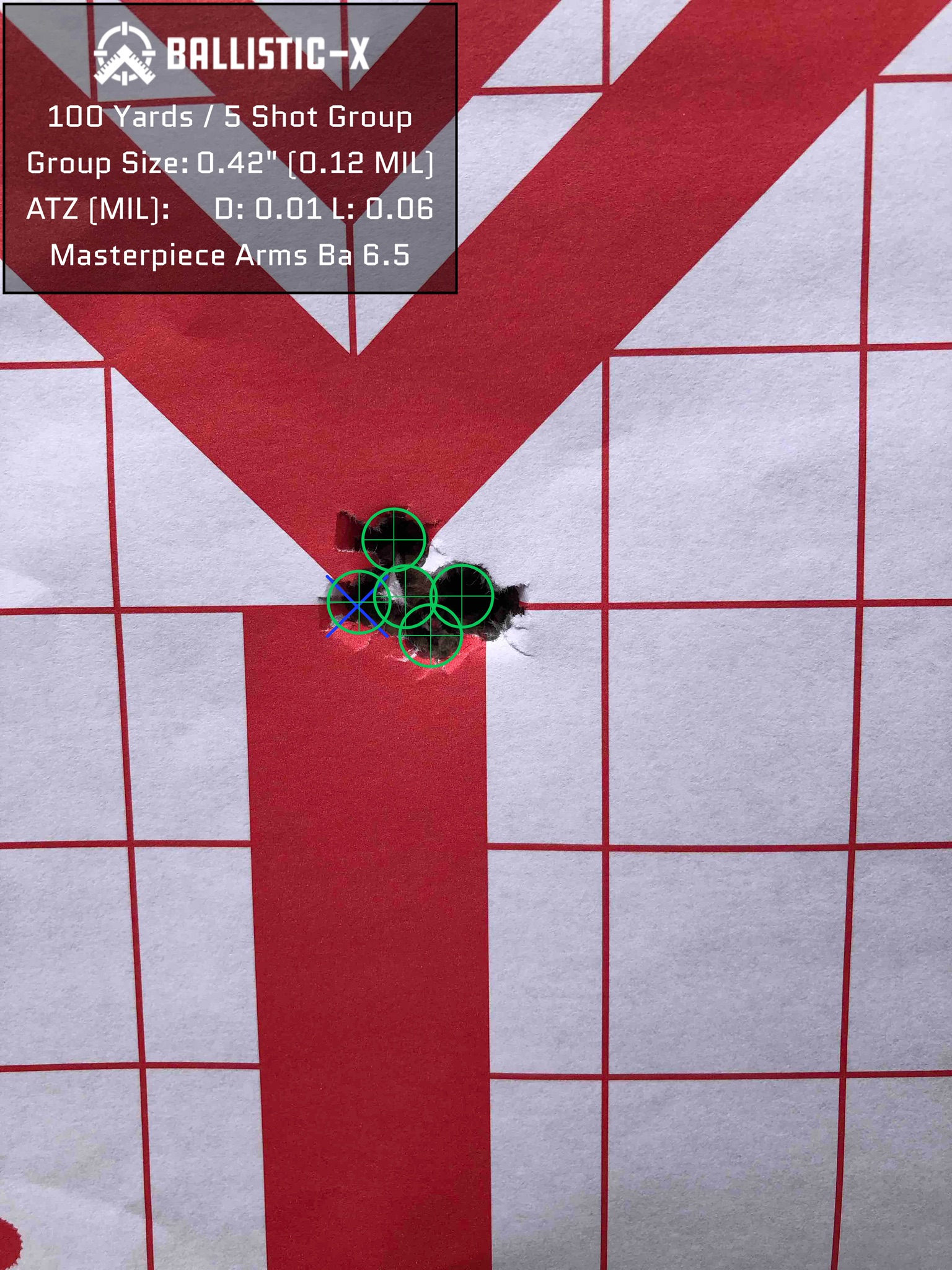

What size groups are you getting at 100 with the factory ammo?
Namibian
Can’t say ,as I don’t shoot factory ammo. I will say with my hand loads ,it is by far the most accurate rifle I have ever shot . Happy to help with anything else I can . ...good shooting
Fair enough!
Barrel beeak-in is now done, so later this week i will get the scope zeroed and shoot some groups at 100. Cannot wait, pretty excited to try it out!
Curious what groups size you are getting with reloads too .... Post a pic, and don’t be shy, if you and the gun shoot good groups, you are allowed to show off a little! ?
Nice!
0.42” is superb, especially for a five shot group. If you shoot three shot groups, you will get a few 0.2” and 0.3” groups too. Good for bragging rights, but only five shot groups count. [Too easy to get lucky with a three shot group...]

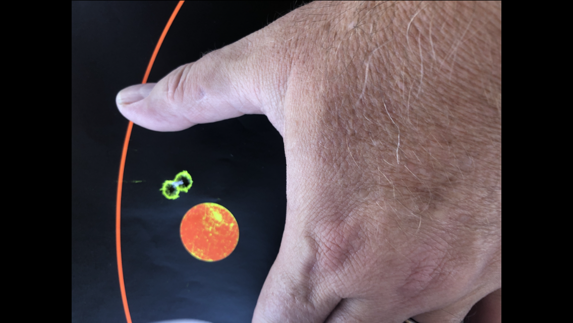

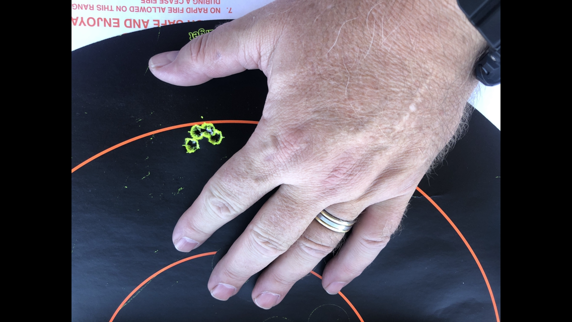

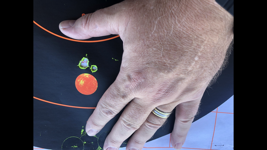

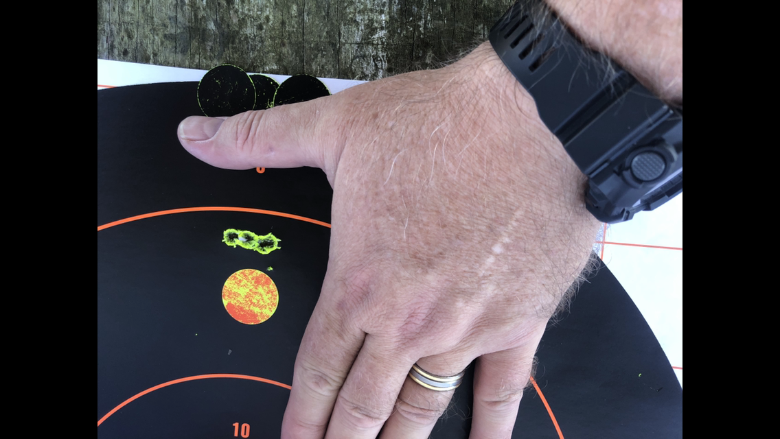

Got some groups to show now: Hornady 140 ELD-M hand loads in Alpha brass.
Slowly getting used to shooting a left handed chassis gun (right handed but left eye dominant), and I’m getting the groups fairly routinely below 0.5” now.
Shooting four shot groups. Best so far is a nice 0.35” group with three bullets through one enlarged hole. The typical group size is around 0.45”.
i had some trouble with horizontal movement, did not take a sand bag along, just an empty dirty sock. No free recoil here. Shot from a nice steel bench though. [The horizontal movement should go away with a better setup.]
Quite happy with the accuracy of the rifle. VERY comfortable rifle to shoot.
Speed was limited to about 2770 fps for H4350 and 140 gn bullets by a combo of the tight chamber and rather thick alpha brass, so less case capacity, and pressure signs arrived early. You have to download about a full grain plus a bit more compared to a sloppy Savage or Rem700 chamber. SD was 7.6 fps, which is a little better than most of my reloads.
But: Hornady 140 gn factory ammo shoots remarkably well. Berger factory ammo (Lapua brass, Berger 140 Hybrid) achieved 2820-2840 fps which is quite fast for a 26” barrel. Also shot well (0.45” average 5 shot group size). I would guess that speed is better because Lapua brass is not suite so thick, and they are probably using a proprietary powder. [Lapua in Finland acquired Berger some time ago.]
The tight chamber and lower max speed is the price you pay for the improved accuracy you get with a factory load. Not a bad compromise, bu

Avg velocity is 2770 fps out of 24" barrel.
I'm already at 767 rounds on mine and I think I got it in August of this year lol
