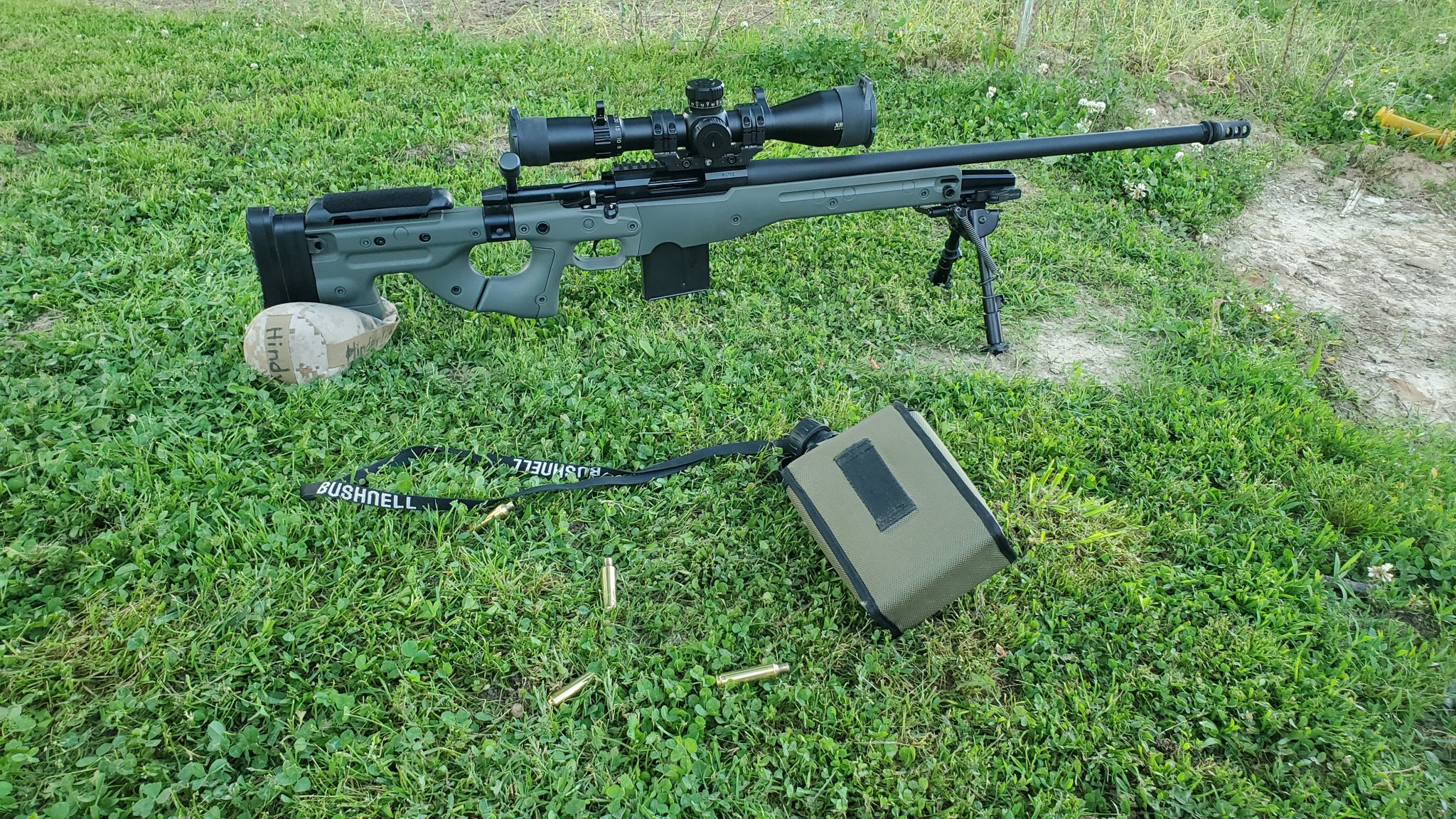

    Just curious if I'm alone on this issue ... where the two screws on my MPA-300-WMBA rifle that connect chassis to action, keep loosening after 20-30-ish rounds. Worked with MPA and got their "lock-washer" solution, and also followed their advice to over-torque to 65 or even 70 in/lbs ... but it's still happening. They said "don't use thread-locker" ... but I'm struggling with what's next. The rifle is a nail-driver when the screws stay tight, and had a 1-mile shot with this rifle this summer. So ... anybody else seeing this? Anyone find a solution or have a suggestion?
