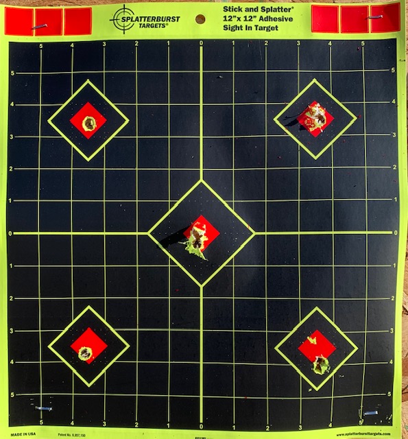

Final Update (I Hope) ... had good weather for an extended range day (no smoke, wind or rain). Put 100 rounds through my newly returned MPA 300WMBA ... the photo below is shots 96 through 100. Everything stayed tight, and as the photo indicates ... no degradation in accuracy. It took a while, but Phil and the crew at MPA seem to have solved this problem. In the past, I couldn't get past 20 shots without the action screws loosening. Not sure how or why bedding the action solved this problem, but I don't care ... it shoots straight now, and at the end of the day, that's all I really cared about. Frankly ... it feels like the repaired rifle actually shoots tighter and more consistent groups than the broken one did. Maybe there's something to this whole "bedded action" thing. Problem solved ... happy ending. Competing with it this weekend at ranges out to a mile ... looking for continued good results.
Bedding actions properly has been proven to increase accuracy since the 50s, nothing new. Alot of chassis' bolt on just fine and give excellent accuracy, as is, but bedding will always increase accuracy and give better return to poa/poi.
Yeah, bedding is a good thing. You could view it as a band-aide fix, but it works. My two Beanland custom rifles that can shoot 0.17 MOA 5-shot groups are both bedded. And I have zero issue with that!
Since getting this MPA back from the "Mothership" ... it's definitely shooting "lights-out". It was spot-on at various distances between 400 and 1,600 yards at a competition on Saturday, and I had 3 final shots to hit an 18"x36" steel target at 1-mile (1,760 yards). Shots 1 and 2 were super close, and Shot 3 was center mass. I'm absolutely "thrilled" with the accuracy of this rifle after MPA bedded the action to solve my loose screw issue. It's my new long-range BFF ... I'm a "Bedding Believer" now.
