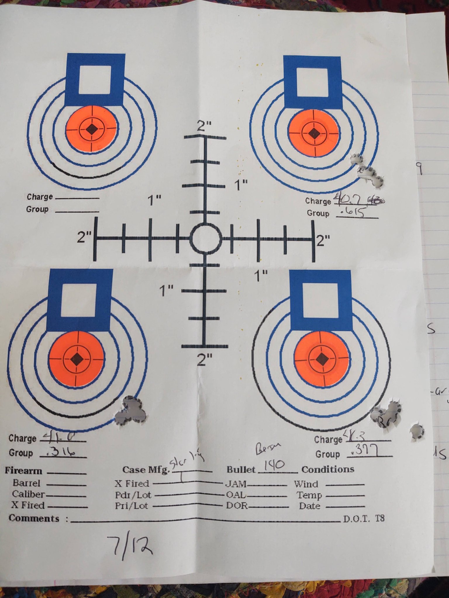

I followed MPA recommendations for barrel break in and with very little load development my rifle shoots 5 shot groups that are . 31 to .37. It is also chambered in 6.5 CM.
Very nice. Mine is shooting at .5 MOA at 200 yards.
