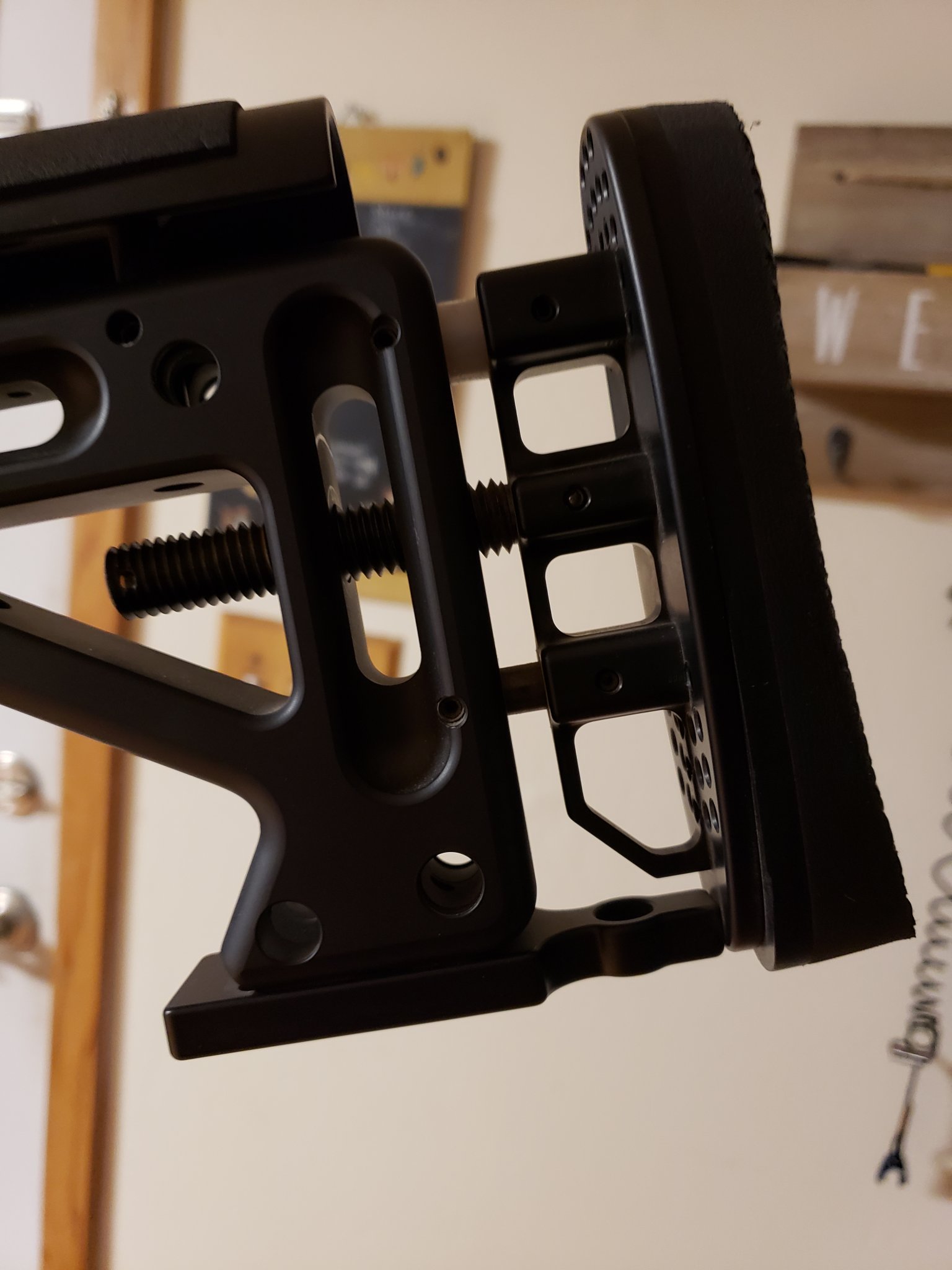

If you have a bag rider, slide it back far enough to put a little pressure on the butt pad and then lock it down. It will take all of the wiggle out of it and also serves as a stop shim for if you ever need to take it off and want it to go back on in the same spot.
That will only work if you have a short length of pull.
Yes at some point the bag rider runs out of room in the slot to move rearward. On all 3 of my MPAs it could probably run out to around 14 1/4" LOP or a hair longer. Folders can get a good amount further since the out of the box LOP is longer on them.
10-4 that. I am 6’ 4” so the LOP is an issue to me. I run the stock all the way back, probably past its intended max LOP, but it works.
