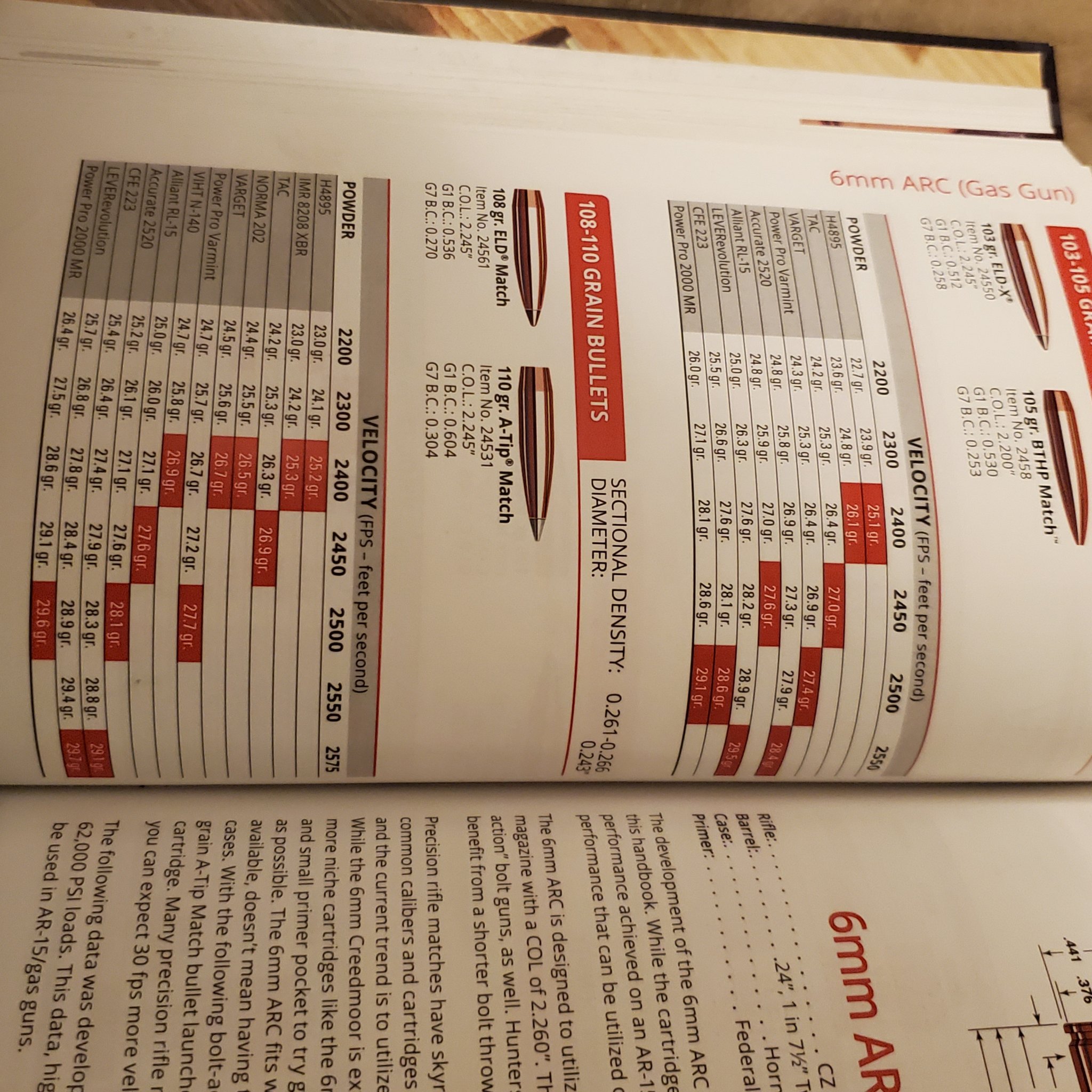

    Here's the manual 110 gr Atip at 2575 fps in 18" AR gas gun Noveske Model N4 starting on page 239 of the Hornady manual. Not a test barrel but velocities taken from a Noveske 18" AR.

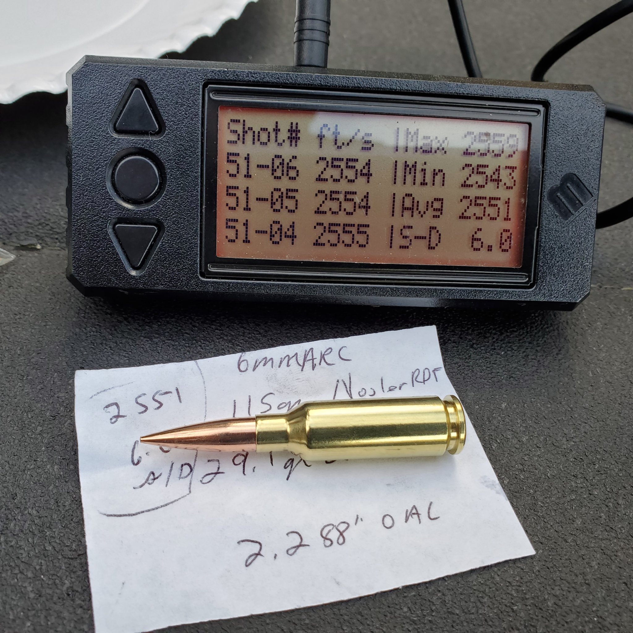

    My 18" Proof barrel will shoot the same velocity, and up to 2603 fps. With maximum loads of Leverevolution, the 115 gr DTAC seated out to 2.290 vs the 110 gr Atip, almost the same length, and seated at 2.245" have the same pressure and the 115 is 2593 fps, which is what Hornady recommended for their gas gun load data.
    It has been working for me for years with 2 ARs with 18" Proof barrels.

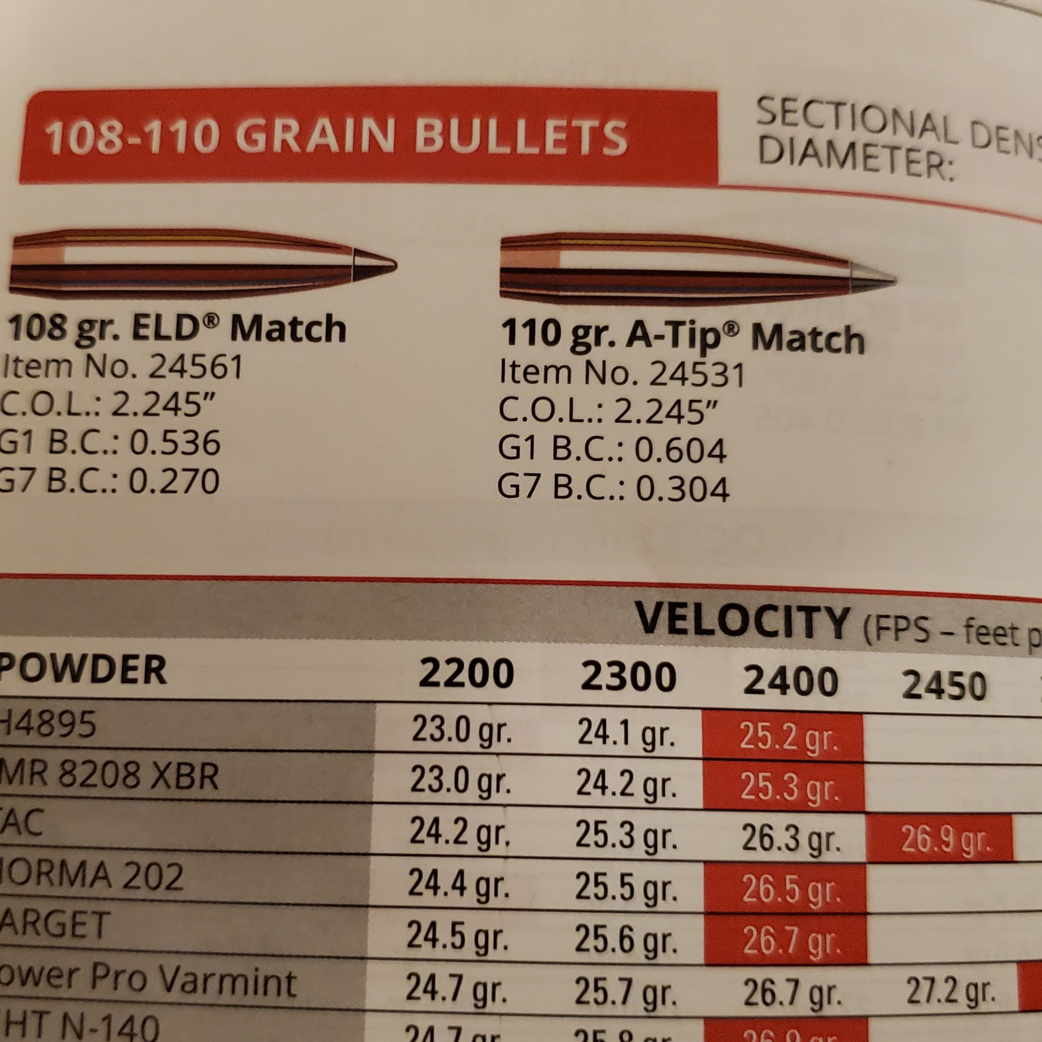

    First don't let your bias blind you...
    Look at the photo it shows the same load data for the 108 gr and the 110 gr Atip
    Here's a close up ....they are interchangeable in their load data.
    I have quick load too...it's a prediction only..
    It says so every time ya use it. Use loading manuals over Quick Load.
    That is from the makers of the QL program.
    I use its predictive software...too, as a guideline and when manuals are not available.
    Bullet length and if the 110 Atip and 115 DTAC are almost identical the 5 grains in weight is not as significant as length, and I add .050" to that 110 gr COAL manual length when loading helps bring down the pressure on the 115 according to QL it will have slightly less pressure than the shorter COAL of the 110 gr.
    The 115 gr RFD at 2550 fps and .634 BC is an excellent load for a 18" AR 15 probably hanging with most 16" 6.5 CM autos with factory loads.

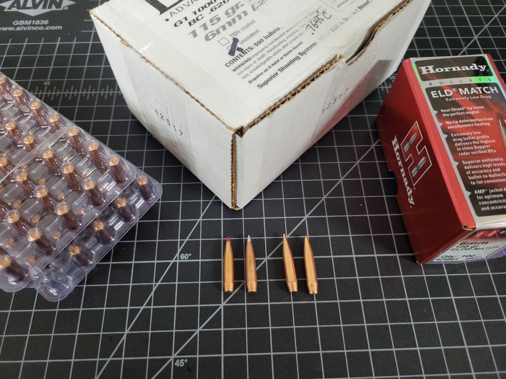

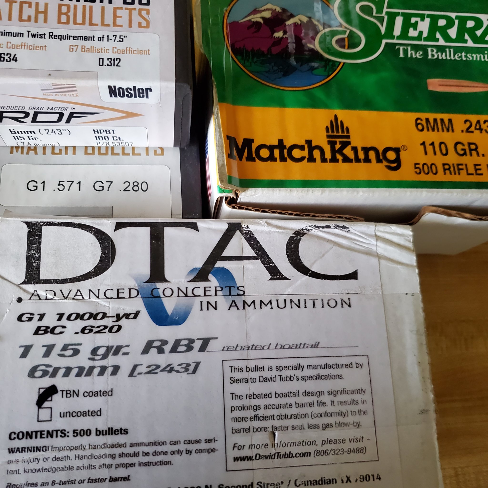

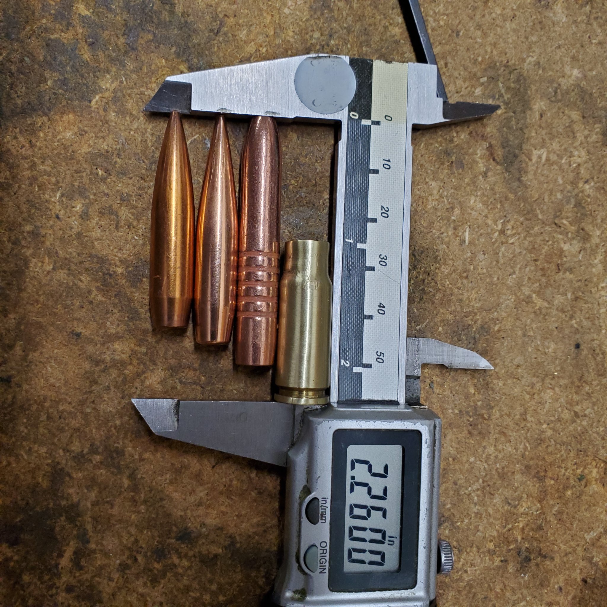

    I've shot all of these bullets and have first hand experience. I went ahead and measured their bearing surfaces for the sake of this thread. Here's the comparitor measurements, it should make it obvious why there's such a large difference in pressure and why A-Tip data doesn't work very well with RDF and DTAC despite the close weights.
    108ELDM .474"
    110 ATip .404"
    115 RDF .520"
    115DTAC .466"

    Hornady published load data for it way back in the 9th Edition I think, but of course they don’t show pressures.
    108ELDM .474"
    110 ATip .404"
    115 RDF .520"
    115DTAC .466"

    I've shot all these bullets too. In 6 dasher and both 6 mm ARCs...so I have "first hand" experience with all of them too, as well as many thousands of others.
    Hornadys data works for me as well as a million other firearm owners, go through their manual they lump bullets together where it does not have a great effect on pressure. Most Everyone knows about bearing surface and types of bullets.
    I have even run a few tenths above maximum and never experienced any problem with the load data I've used from their manuals.

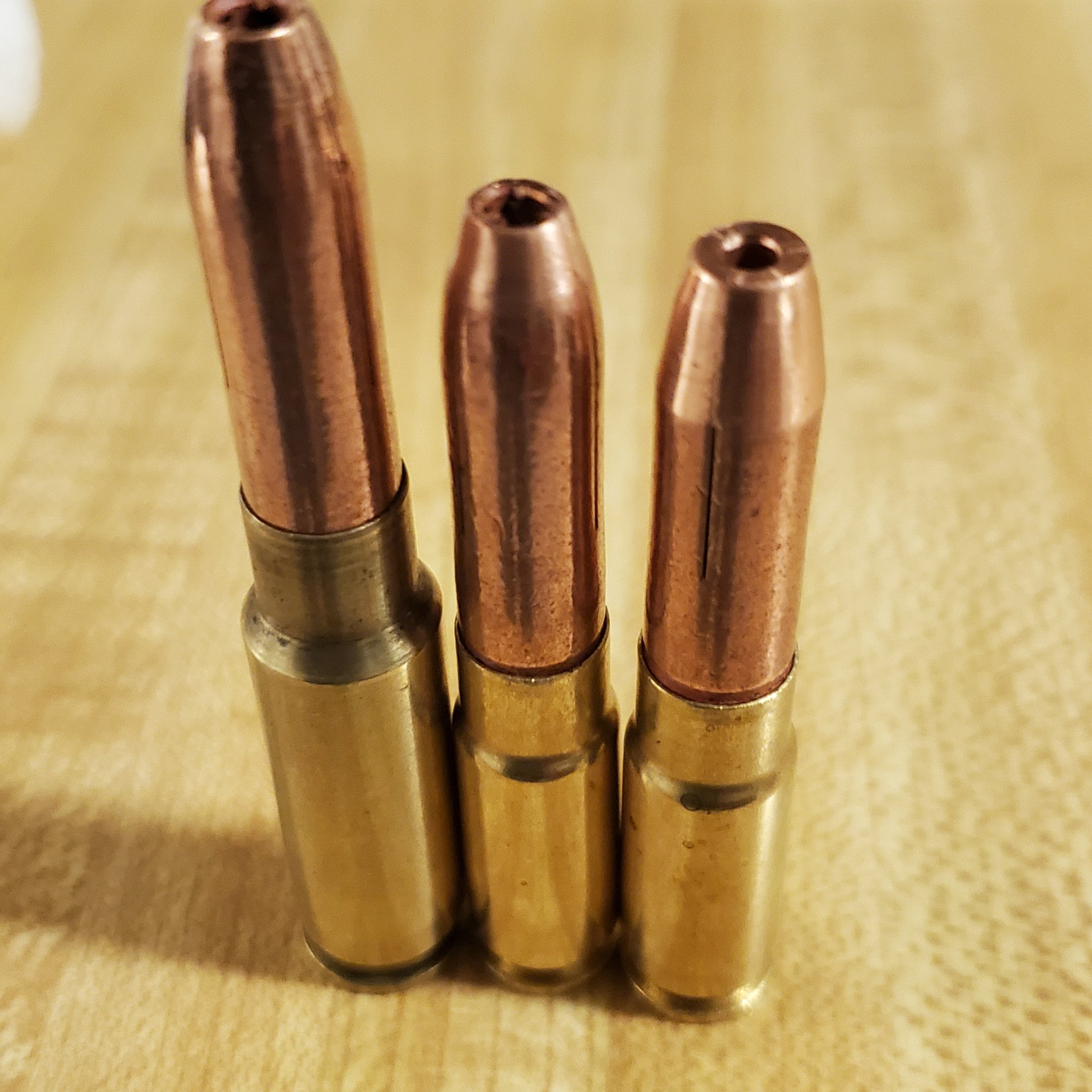

    Bearing surface?... Here are some bullets with lots of bearing surface, all copper bullets I've developed load data for..." first hand" ...LOL.
    Lots and lots of beating surface...so maybe I've learned something about bearing surface.... maybe I've even adjusted the bearing surface of the bullet.
    Maybe I've made and altered extra long bullets and fired them...subjects of my own design.
    Guys who want to shoot 350 grains 400 grs in an AR 15....and heavier as the caliber goes up.
    So the 6mm ARC has better performance than you want it to...it beats your favorite cartridge... obviously... it can't do that, but it does.
    Don't like it, don't whine, change cartridges and get better performance, there are lots of choices...and remember no one really cares, and none of it is really important.

    But somehow Hornady is wrong and that the QL you possess is right on,
    I clipped all the extra shit out because it's irrelevant. Hornady doesn't publish pressure data at all. Further, Hornady's test fixture isn't an AR15. I have never seen Hornady's 6ARC test fixture chamber pressures and neither have you. No one has besides Hornady. You probably are replicating their velocities, by all accounts it is in fact real. However, every bit of data from other sources, that includes pressure, conflicts with what Hornady considers a safe maximum load. On top of that, Hornady does not produce data for the 115 DTAC, or claim their data extends beyond what's in their book. If you take the time to measure the bullets it is plainly obvious why the pressure is different between A-Tip and DTAC. That difference is reflected in QL.
    QL is in fact an estimation. Hornady's load data is also an estimation. They give you a warning at the beginning to work up.
    I think I have explained it well enough. Anyone reading this is free to draw their own conclusions based on the discussion. You can have the last word and I'll move on.
    6 mm ARC, Hodgdon has the same max load on their load data site for the 110 ATip as the 107 SMK ...exactly the same powder charge at 28.2 gr of Leverevolution for both bullets.
    Fact.
    Similar weight, similar profile, uses the same max load for a bunch of cartridges in pressure tested data. Fact.
    Hornady fires their pressure tested anmo in an AR 15 18" barrel to give one a realistic idea if what to expect in a production rifle...fact there is the photo pictured above...fact.
    Hornady does not produce the 115 Dtac bullets so they will not produce load data for it. Duh...
    But reloaders work up load data from similar bullets all the time, every day...
    It's shared to those who care to learn, and work up for their chambers... Yahoo.
