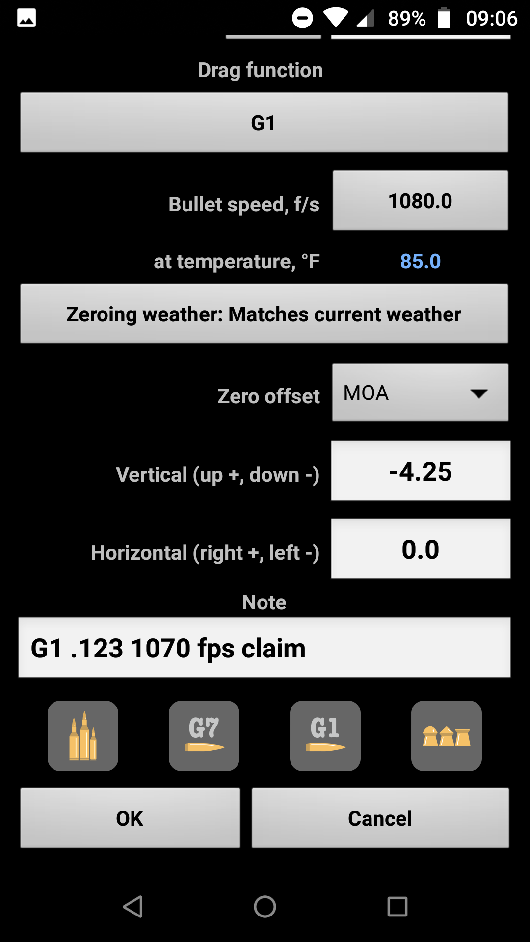

Assuming your scope has a zero stop. Provided your faster load had a higher point of impact with the same sight setting you'd zero with that then set your stop. Your slower rounds you'd measure the offset (should be lower than your chosen zero load) and record that data.
Most ballistic calculator apps have the ability to record an offset and will give you that difference in a calculation.

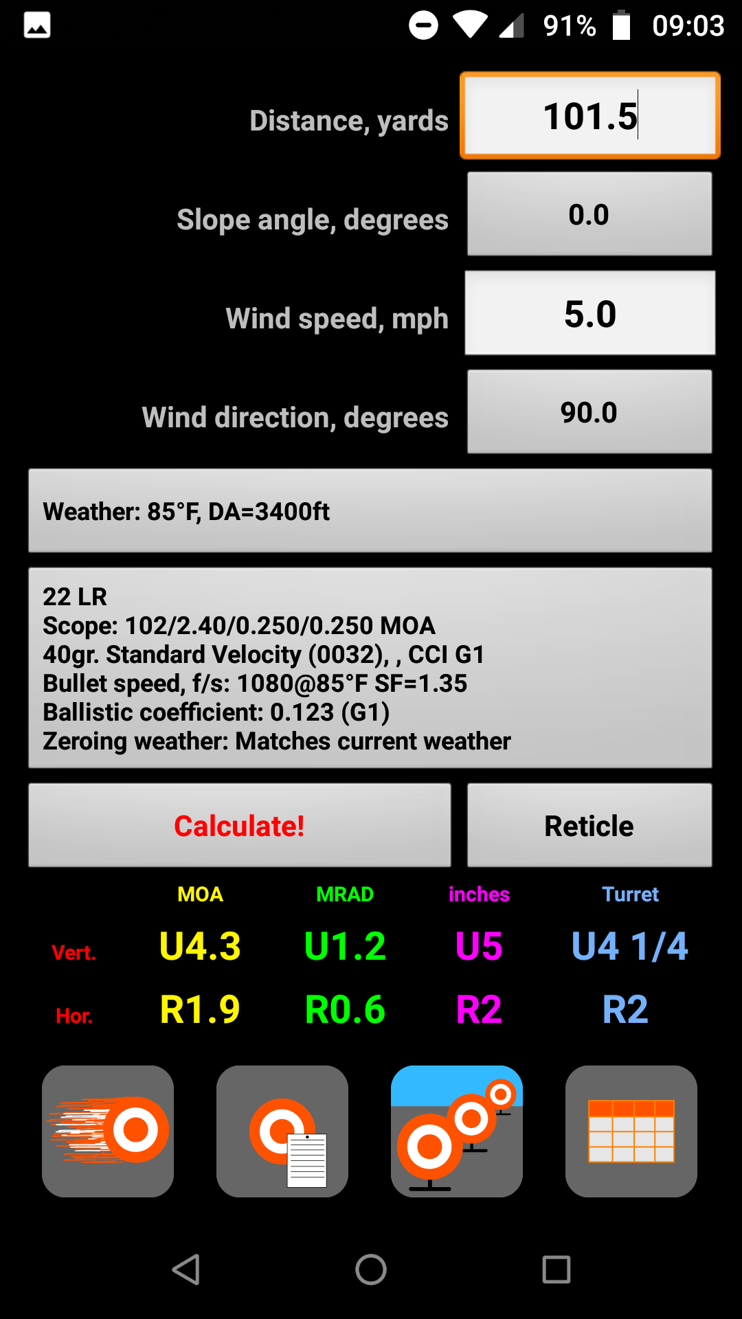

Yes, given the practice load is slower/lower point of impact you'd be dialing up to "zero" for that. If using for example Strelok Pro and had both loads entered properly you'd see the offset as part of the solution.
Example:
