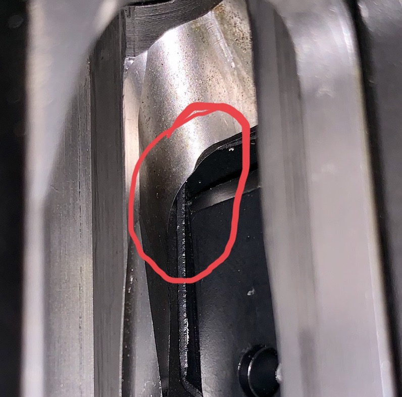

Im having crazy problems extracting and sometimes feeding from AI magazines in my MPA Comp chassis with a Bergara LRP chassis. Ive had the LRP for well over two years and never experienced a single extraction or feeding problem....any help? My brass comes out all marred up. I tried uploading a video but apparently I dont have an approved link.
*Update*: If anyone has a similar problem, try Pmags. Mine works flawlessly now with a Pmag. Must be the spring tension in the AI mags....probably gotta break them in.

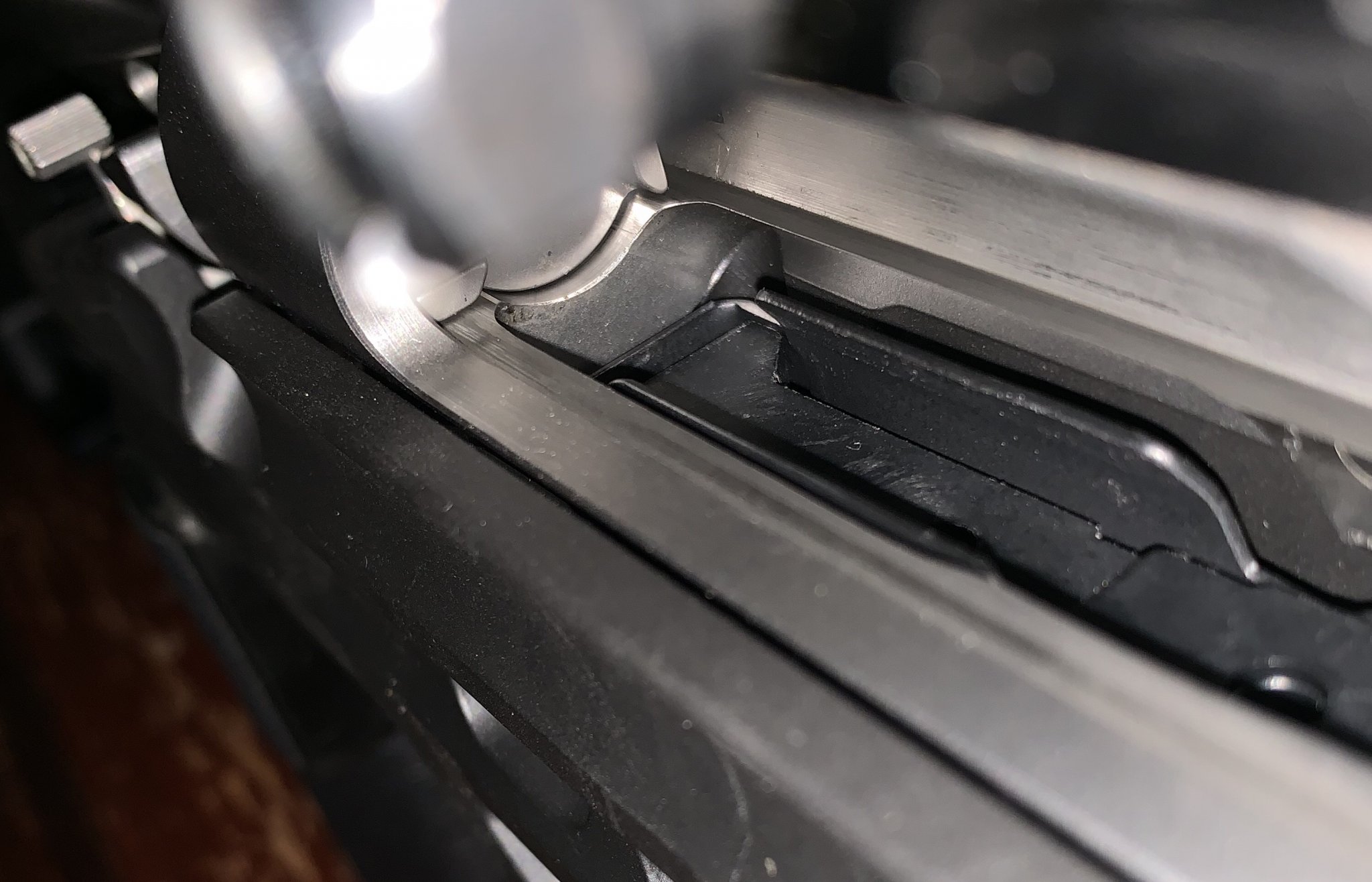

My Bergara Premier action locked up the bolt behind/infront of the feedlips when I was using a gamechanger. I shaved the feedlips as per their video, and then found that my bolt was dragging hard on the feedlips.
I emailed MPA, and they responded lighting fast. They recommended the mag blocks. I just ordered them and will respond with an update.
Update:
Mag block does absolutely nothing. It's too short, and I'm goimg to try to Jimmy rig something to make it work.
EDIT: I did put a small amount of silicon caulk on the mag block.
What does work is just modifying Pmag feed lips as noted in the videos MPA put in. Unfortunately for my pmag, the amount of material I had to remove to make it function rendered my 10 round pmag useless. Going to try an MDT mag before I return the chassis.

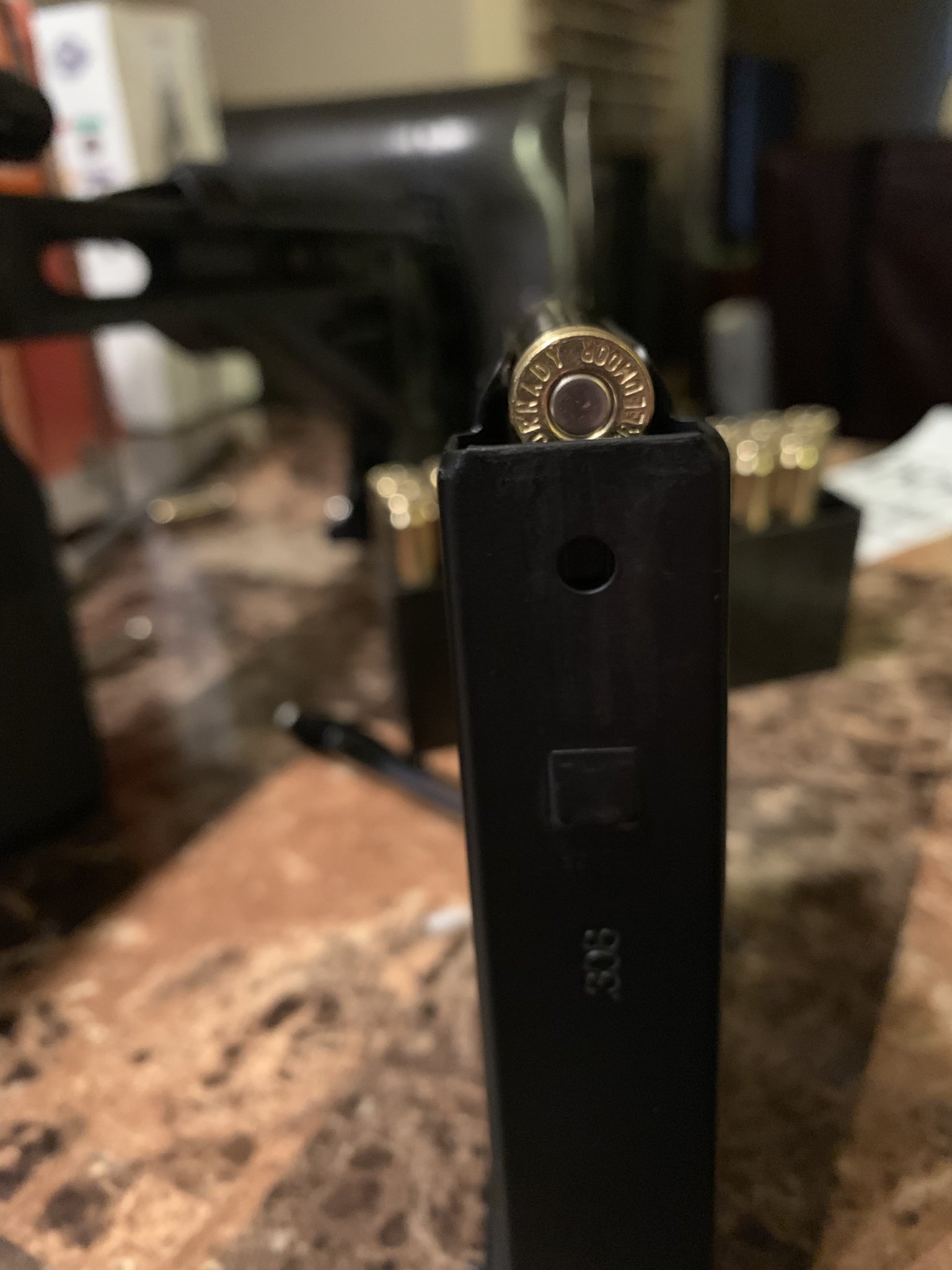

Has anyone tried the Accurate-Mag designed for 6.5 Creedmoor in their MPA chassis? Can’t find any information or reviews about them online. Not sure what makes them 6.5 Creedmoor specific.
The magazine follower is different. 6.5 CM shoulder is way farther back and a typical 308 follower allows a decent amount of shift back and forth.

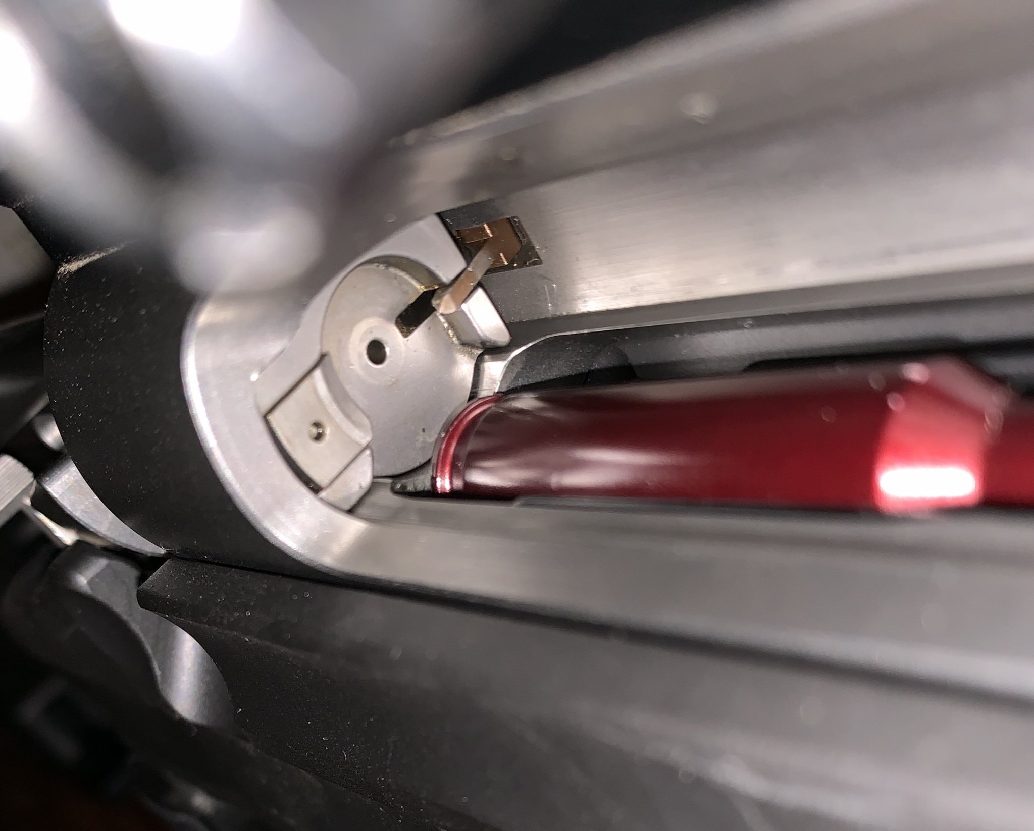

Final update on my end!
The mag block makes a noticeable difference with a metal magazine. With a polymer magpul, I am assuming the plastic flexes too much for the mag block to prevent extra movement.
In general, the metal magazines work much better in the chassis than poly mags. The MDT didn't have any problems, unless using the magazine on a barricade. (Where the mag block wood prevent the feed lips locking up on the bolt.)
