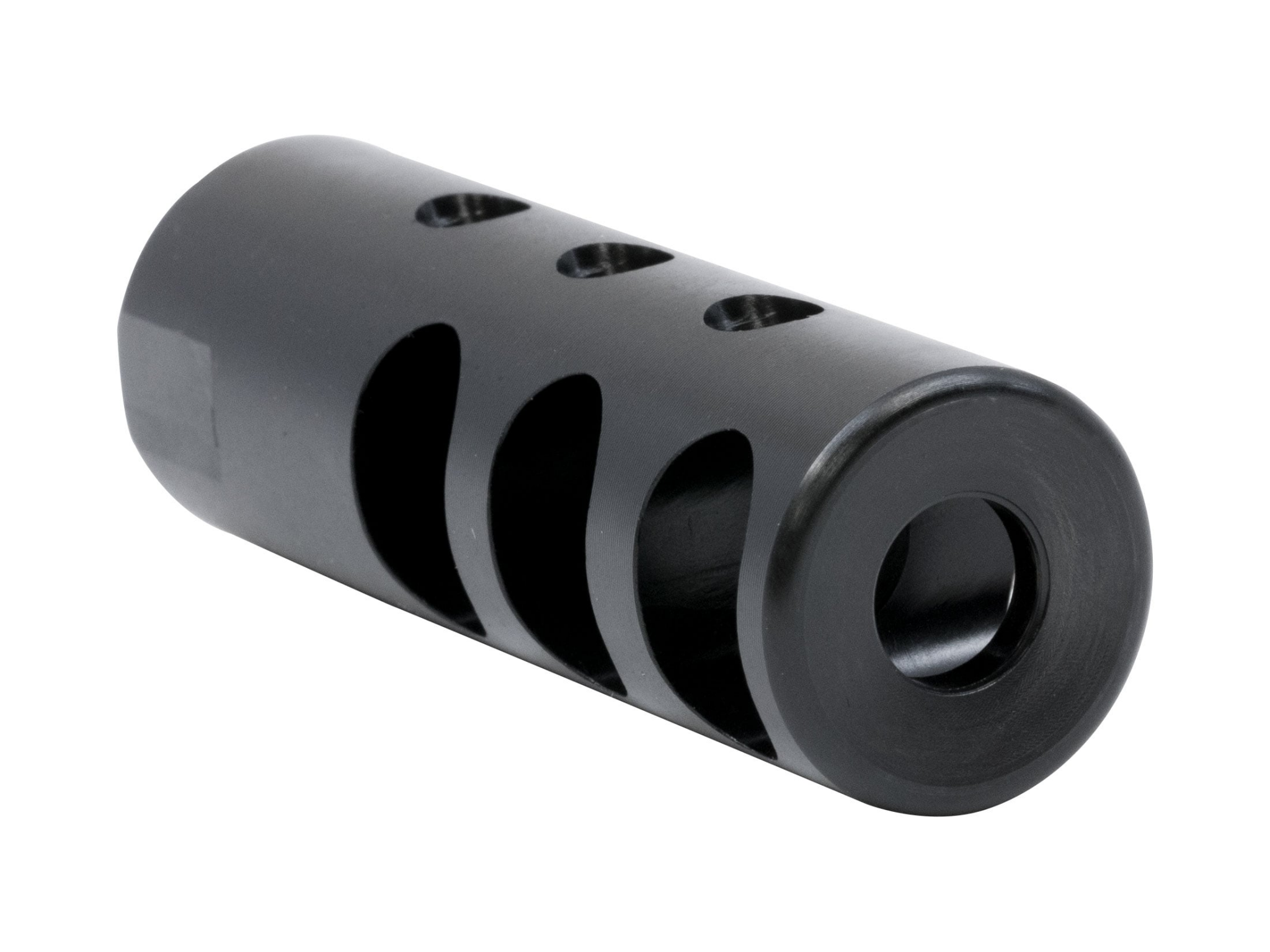

Hi all-
I was hoping I could draw on the brain trust here and gain a little insight and knowledge on the subject of muzzle brakes, especially in concern with crush washers.
I recently bought a new Tikka T3X UPR and am very happy with it. However, in an effort to mitigate 308 recoil as much as possible (especially 180gr rounds, which are most of what I have stocked...) - I bought and installed a new LimbSaver AirTech recoil pad (I have various LimbSavers on my considerable shotgun collection, and they've always been *amazing* - so I figured I would try on a rifle ... I have yet to shoot it yet with the pad installed, because I was waiting to get the brake in the mail, in order to compare a 'before and after...) - and I also found what seemed to be a great deal on an "AR-STONER Precision Muzzle Brake" - which seemed like a steal at $20.
I have never used a detachable muzzle brake before. This particular one comes with a Crush Washer - I took the advice in some of the reviews and bought and extra. My question is pretty much ... when I use the Crush Washer and install the brake , am I going to be needing to buy and install a new crush washer every time I unscrew the brake (for cleaning etc.) and putting it back on? I have Googled this a few times, and mostly get answers involving car oil changes, and the answer seems "Yes, you need a new one everytime you do this..." ... when I search on SnipersHide, I mostly see (not-at-all-helpful) answers like "Pay a good gunsmith to do it..." or "buy a better brake..." - I am happy with what I bought - I am just a little confused- I was under the impression you can take them on and off at will - if you have to burn a $3 crush washer each time, I'd assume it's more of a semi-permanent type of thing.
And lastly- timing is just making sure the ports are where you want them, right? In my particular case, it has large left-and-right ports and a few smaller ports on the top - timing it is just making sure the ports on the top are on the top, right?
Thanks!
You can reuse the washer. If it doesn’t time correctly with adequate torque you will have to buy some timing washers that work like shims.

The crush washer starts out flat and then deforms to allow a custom timing.
I seriously wonder what would be the big deal if the user simply hammered it out flat again before reusing it.
Greg
Are we talking about the same washer? Im pretty sure the standard muzzle break crush washer starts out cupped like a bowl with the center cut out. Crushing it flat creates the spring back pressure to resist rotation. It will loose some of the spring over time but can still be used again.
Another option is a nut behind the brake making it self timing.

I've always considered crush washers to be one time use. Have I cheated a couple times in a pinch - sure. But no reason to be removing/reattaching brake/flash hider anyway unless replacing w/ something else. Don't use crush washer for suppressor mount brakes/flash hiders.
Reactions: clcustom1911
OK roger that -thank you very much and to everyone .... I want to shoot it once or twice without installing it yet - so I can judge how much an effect the LimbSaver AirTech pad makes, and then once installing it I'll keep it on - Thank you to everyone again!
I’d go with peel washers to time it correctly. And yes, I’ve reused peel and crush washers before. That being said, why would you remove it regularly? I’d only remove it if it needs cleaning

I also consider crush washers one-time use. I try and always have a few extras around sine they are pretty inexpensive. I have on occasion, used one a second time if I’ve run out of extras and it works as it should.

I wouldn't use a crush washer on a brake or suppressor mount. Maybe on a flash hider. I use Precision Armament's ACCU-WASHER system. It's not expensive if you can find a local smith the uses them but a guy doing a one time installation of a cheap MD probably doesn't care about anything but saving money. Peel washers work but look like shit.
Or you might want to drill and tap to make it like this. You can slight turn the muzlebrake to one side to compensate for improper bedding of rifle or shoter position
Crush washers are cheap. I bought a 5 pack of them for about 8 bucks. The classic (non-peel type), are intended for single use.

OK Bad idea, but at least somebody's thinking about restoring the crush washer to its original shape.
Got a better idea? I'd love to hear it.
I don't care about the cost of the washers, they're cheap enough. I just don't go for one-use items; they're a waste of money.
I've tried shims, and they work, but I really think they could just as easily be considered an excess when (re)mounting a simple brake. My main concern is time involved in the the order, wait, delivery process, especially in days like these. I also think the timing nut is a better approach when timing is an issue, because I do expect that the crown will need to undergo carbon removal occasionally.

putting a C3 onto a DPMS 308 with a crush washer. , the contact started at about 60degree past TDC, or about 2:30 o'clock. I thought about adding a shim to get contact to the right of TDC , but went ahead and worked the muzzle around, all the way back to TDC and about 2/3 the turn the washer split, ehhh I crushed it.....I am guessing that this is not the actual intent of the crush washer, to split ???
It should not split.
No, it should not split.
The proper way of working the brake is to tighten it, go about 10-20 degrees past its tightened location on the barrel, then loosen it and repeat the process. Continue until it hits the indexed spot.
