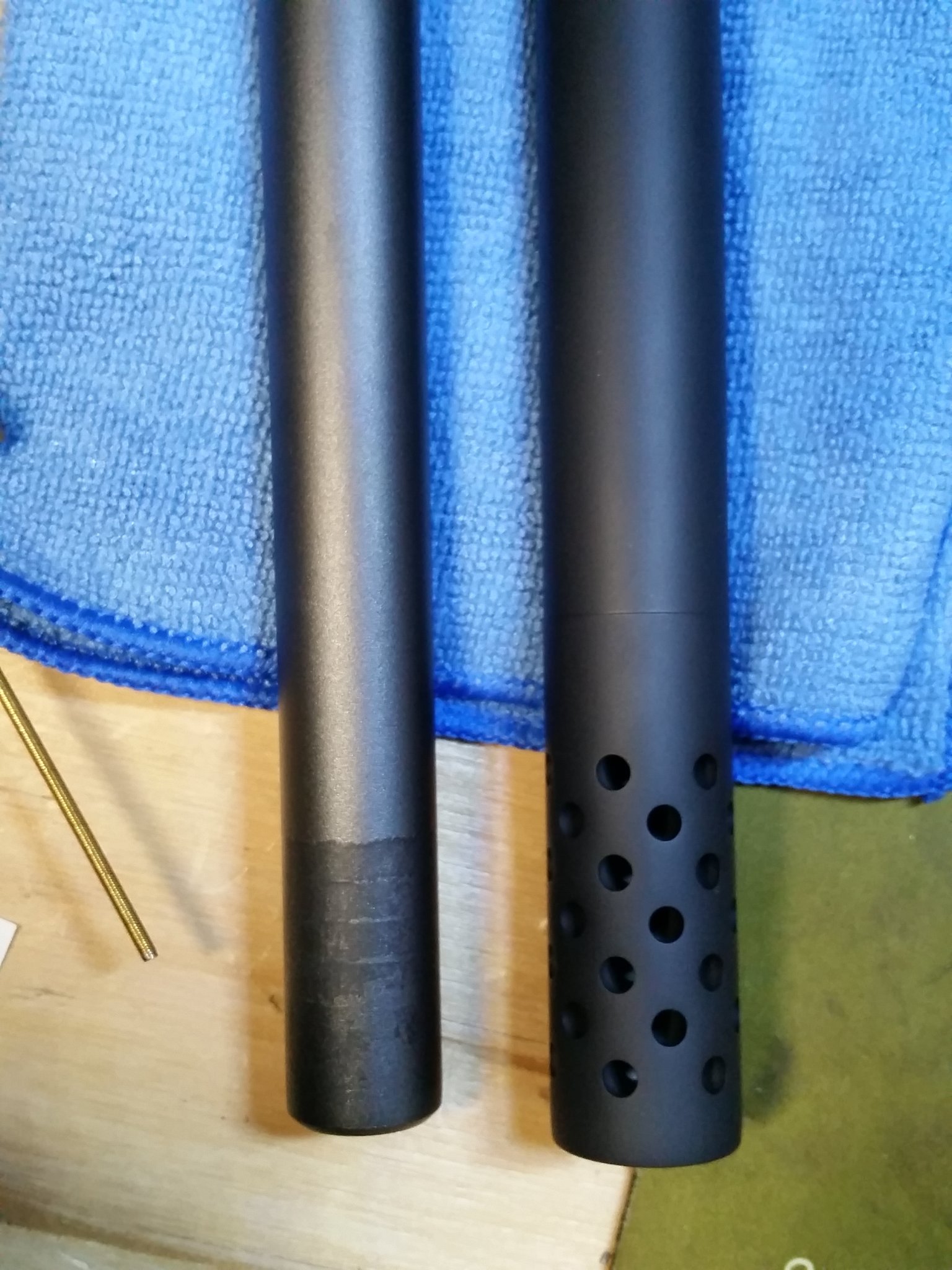

Just completed my .223 build and I am on the fence about adding a muzzle brake or just going "naked" with a thread protector. Rifle is based on an Origin action and has a 26 inch Remington Varmint contour barrel in an MPA Hybrid chassis. Weight is about 13 pounds with scope and rings (less mag and ammo).
Recoil is already pretty mild, so it may not be worth the effort and additional noise. Muzzle is threaded 5/8-24, so any brake recommended would have to fit.
Interestingly, the rifle seems to group a tad better with my Magnetospeed on the barrel. Maybe the additional weight is improving the harmonics? Could a muzzle brake have the same impact?
Any thoughts or experiences here are appreciated.

At a 26" barrel, you aren't going to have all that much gas pressure left, so a brake is kind of a why?
If you say the rifle shoots better with the MS on the end, perhaps you have some harmonics going on you need to address, maybe try with and without the thread protector or the thread protector spaced out with some washers etc. or a heavier / lighter thread protector.

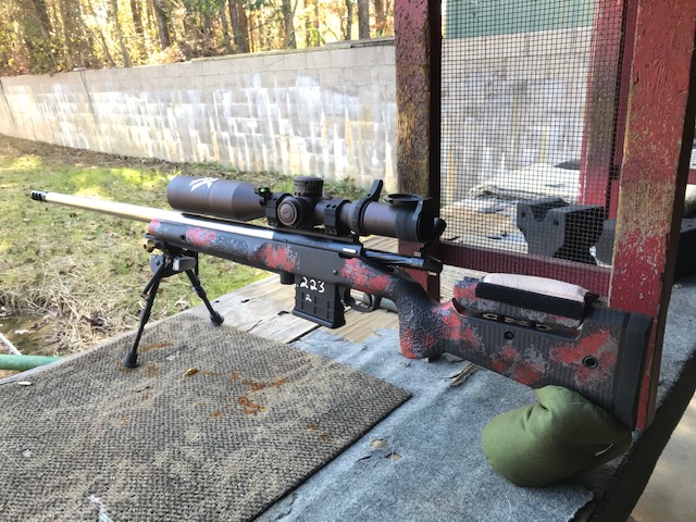

Originally I put a muzzle brake on mine, a 24" MTU profile Krieger, to protect the threads, but it isn't that loud that far out. I feel like the gun tracks a little nicer during recoil.
Put a brake on it and you decide. I have a brake on my 27" .223 with a Proof Comp contour barrel and it almost feels like my .22. It's very nice and barely moves. I wouldn't take it off or put a can on it. Perfect like it is.
