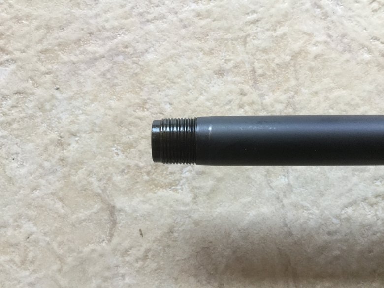

Muzzle brake for thin barrel ( 0.63” ) 5/8” x 24
It's threaded for 5/8"-24 already? I can't imagine any gunsmith in their right mind would do that. The barrel wall thickness at the threads would only be 0.0035". I believe 0.675" is considered the bare minimum for 5/8"-24 threads.
What is the caliber?
Thompson Center Compass. Was done at the factory. 6.5 Creedmoor. Cheap hunting rifle.
I still want to put a brake on it.

My mistake on the math. Hadn't had my second cup of coffee yet. 0.63" is still well under any manufacturer recommended minimum I've ever seen for 5/8"-24. Strange that they wouldn't go with 1/2"-28 or 9/16"-24.
Is the shoulder behind the threads, .63"?! Or are you measuring the actual threads? The major diameter max spec for 5/8-24 threads is .6255" that leaves a shoulder of .00025"... so basically no shoulder at all.
with a 6.5 creed your barrel wall thickness is .16625". I wouldn't be overly concerned about that unless they make a deep relieve cut.
Check out KDF muzzle brakes... http://www.kdfguns.com
Here is one on a 7mm Rem mag. The shoulder diameter of the barrel is 0.648...
Sure isn't much shoulder there. I prefer more shoulder; but then I only use brakes for mounting one of my suppressors. I guess there's more need for a shoulder when mounting a brake for a suppressor. The general rule I've always gone with for 5/8x24 is .725" MINIMUM.
One big concern with threading a thin barrel is the end of the barrel becoming distorted because of the extremely thin wall between the bore/crown and the threads. Not saying it can't be done - it can. Just not something I'd do.
