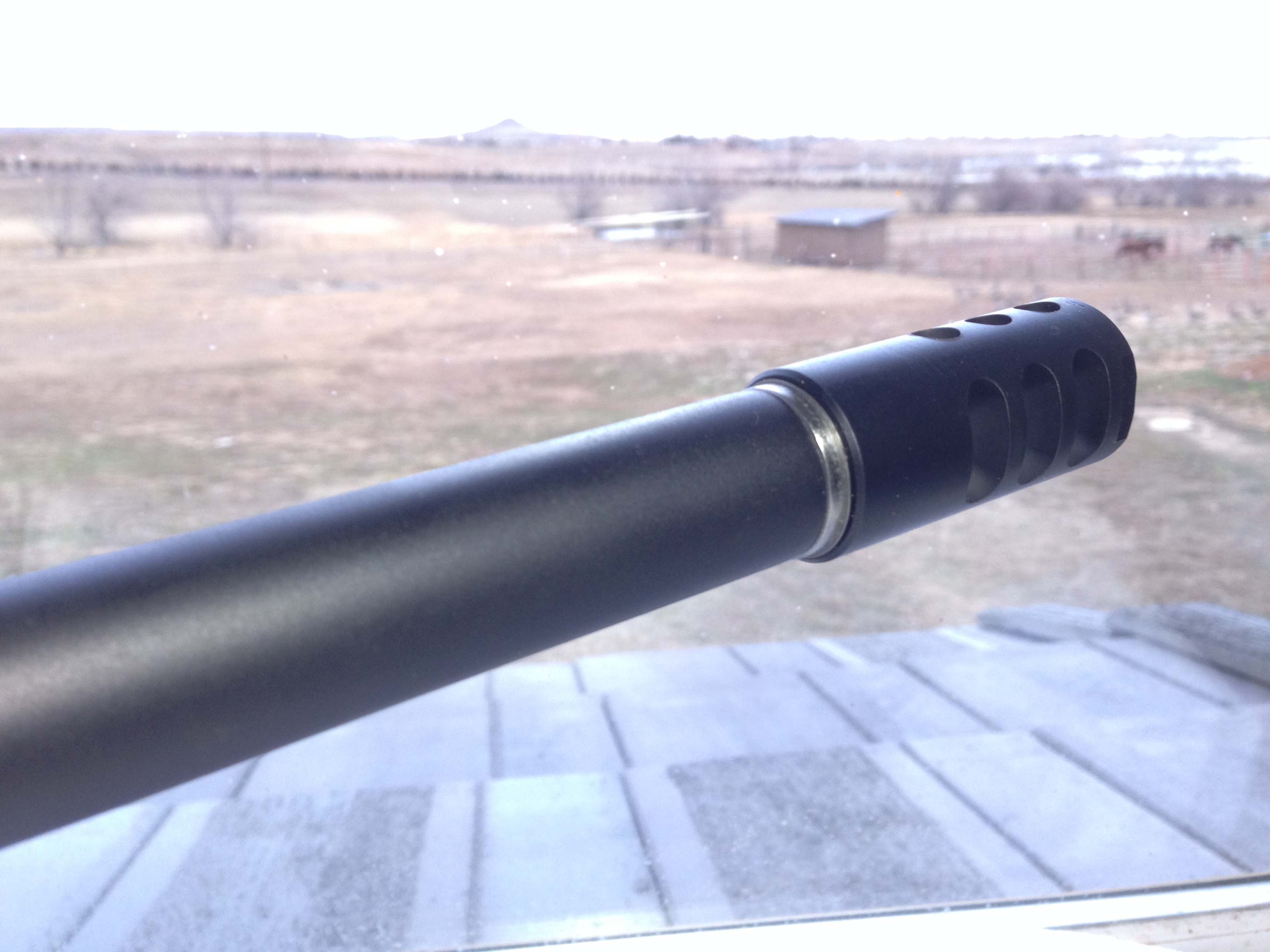

I have a brake on a 20" .308. While I feel 308 isnt a shoulder breaker, its pretty cool to spot your own shots and I can shoot all day. Brakes become more effective as the cartridges get bigger. Some even consider it required with some cartridges. The design of the brakes also dictates effectiveness.
I have a Badger Ordnance 'Thruster' on my 20" 308. It makes a world of difference in spotting my own shots. Louder yes, but a worthwhile tradeoff in my opinion/experience. I'm wearing hearing protection either way.
I'll add that I'm handloading 208gr AMax over 49gr RL17, so there is a bit more recoil going on than with FGMM 168 or 175 type ammo.
Since a brake works by harnessing the kinetic energy of the high velocity gasses coming out of the barrel it would make sense that the more gas you have available and the more velocity it has then the brake will be more effective. Since the little 22 cals don't have a lot of recoil to begin with you get more noise than braking effect. On "real" rifles with enough powder to make some recoil the brake will have much more effect and a good brake moreso than a bad one. On any of them you will find that the shorter the barrel the more the brake will do. Some of that is due to the additional high pressure gas available and some is due the fact that your shorter barrel won't allow the bullet to reach as high of a velocity and therefore less recoil induced in the system. With the AR setup a pretty goodly amount of gas is dumped into the bolt which increases its rearward velocity and as it stops the energy is dumped into your shoulder. The gas that is used to operate the system is not available to help out with the braking so you don't get nearly as much recoil reduction as you would with a bolt gun. My .338 Lapua bolt gun gets a huge recoil reduction from the simple brake provided with the rifle and even moreso with the suppressor I built for it. Unfortunately as you noted you can't use these more effective brakes which also reduce the noise. My 300 blackout gets no help at all from the brake but there isn't any real recoil to reduce so it doesn't need it anyway. Its all relative.

Added the JEC on my 20" .308 and love it. Easy to see the target shot and I completely forgot about the recoil while shooting. Something less to distract me while I learn this art.
