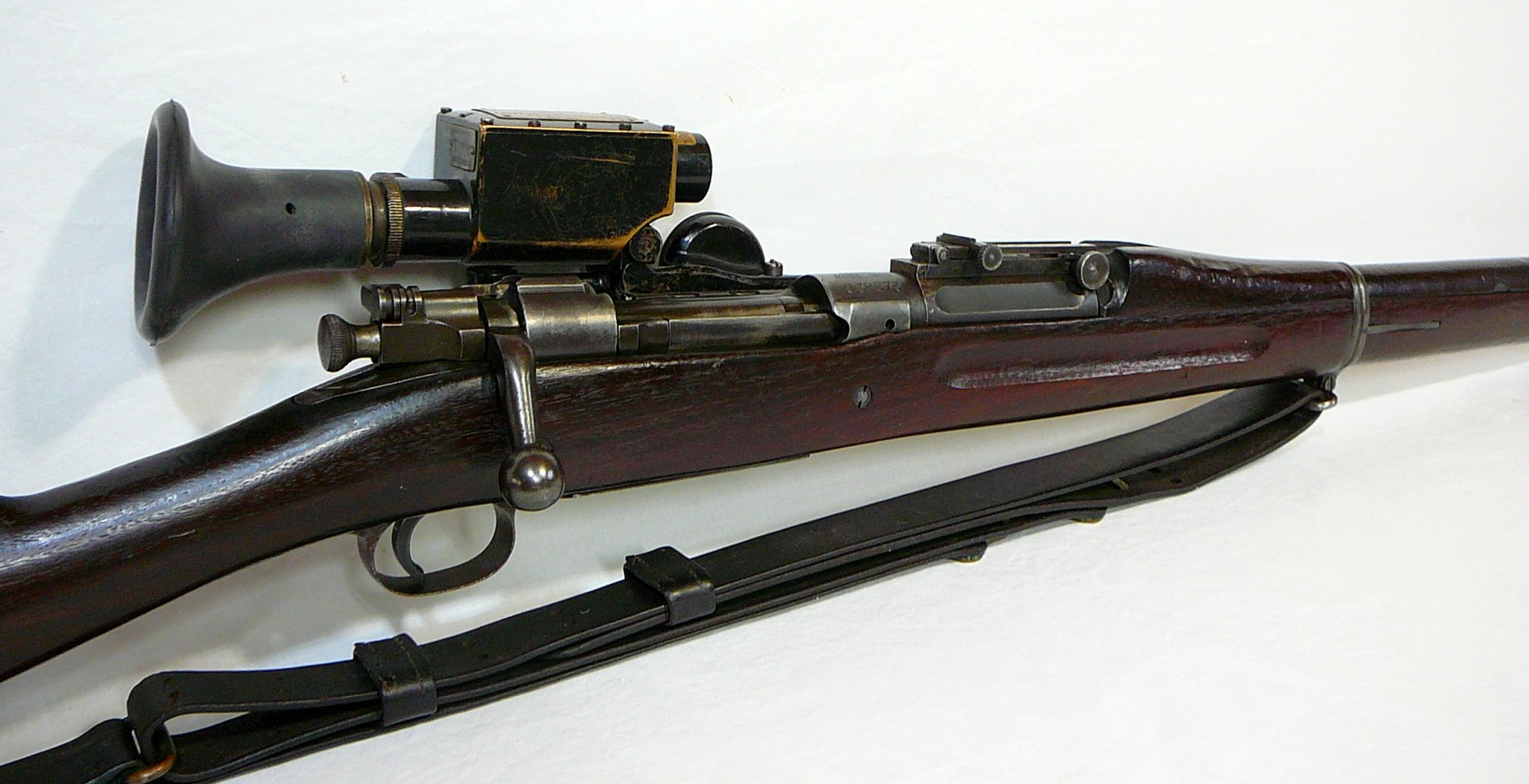

But first is the 1913 Warner Swasey Sniper. There were two variations of the Warner Swasey sniper. The first being the 1908. This is the later 1913. This rifle is a rare one to find as it's all original. Most of these had the mounts removed and turned back into a regular service rifle as SA ordered them all removed in the late 1920's. I suspect this one was one of the ones you could buy off the old DCM in the mid 20's that I see advertised for sale. It would have also been one of the last Warner Swasey's built in 1918
Serial 932873 barrel date 7/18

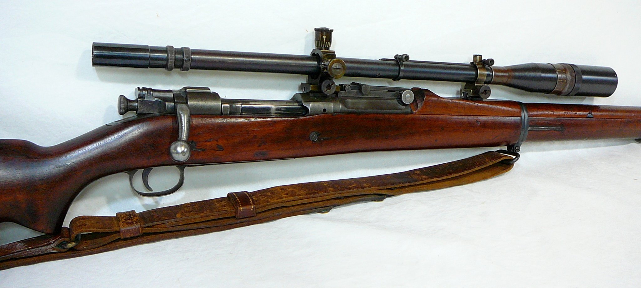

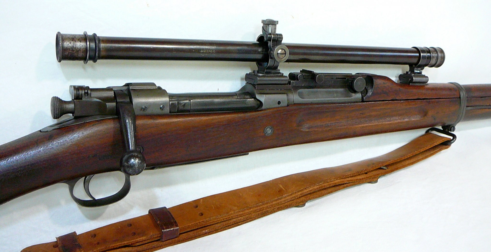

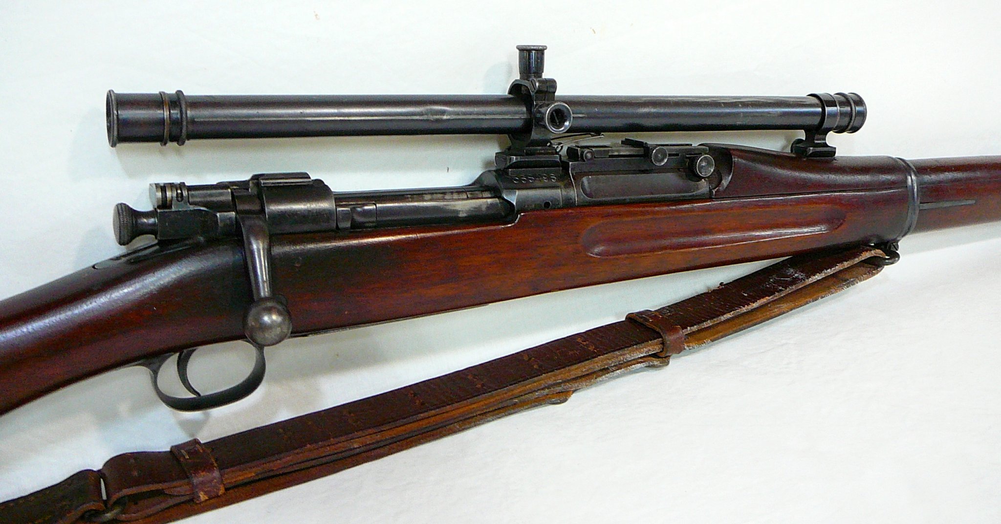

Next is the one I'm the most passionate about. Because I knew by reading the books something was wrong with the info you see on the WWI Marine A5 sniper rifles from WWI. The info in the books didn't add up, plus there was usually two or three paragraphs on them and that was it. So it actually took me a few years, but I found the docs. Even though everyone thinks of the Mann Niedner Variation as the main WWI Marine sniper. It really wasn't. Not in any great number at least. Adolph Niedner converted 150 in 1917, but was fired as being a potential German Saboteur. Next Winchester received the contract and made their own version which was called the Springfield Marine. Not only did the Marines receive 500 of these in 1917. But the Army actually received 900 in 1918. There is no difference between the ones the Army and Marines received. The Army actually even made this their official sniper in July 1918. Or at least it replaced the Warner Swasey and was a placeholder waiting for the Winchester Model of 1918 sniper that was never completed and cancelled at war's end. This is actually the A5 sniper of WWI that was used the most in WWI and not the Mann Niedner.
Serial 398496 Barrel date 6/09
It's interesting to note there is some connection between 1909 rifles and the WRA snipers. I think because the Marines received 400 NM in 1909 and some of these were the ones used in the conversion into snipers. The first pic below was taken in France in 1917. It is also a pre 1910 rifle by the features. There is also one serial in the Winchester Sniper docs that is within a 1000 digits of my rifle above.

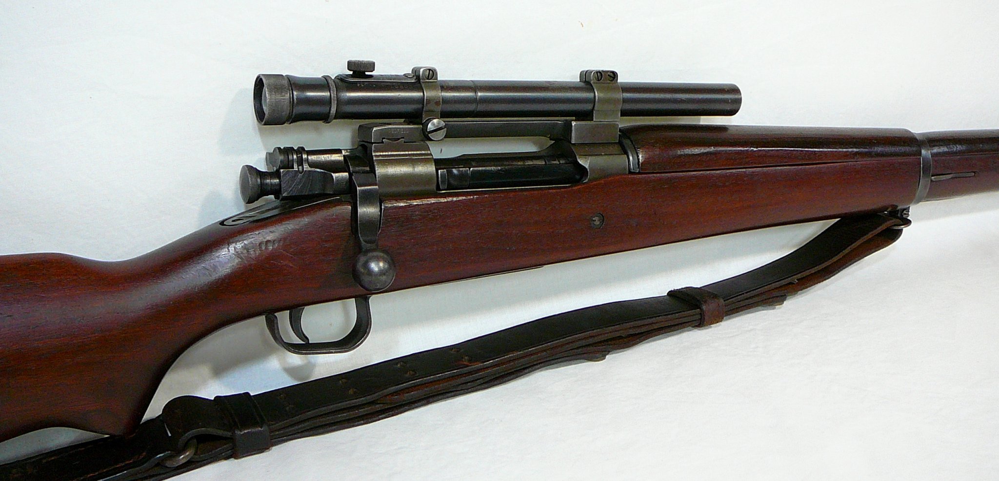

Next is one not discussed in books that much either. But is probably why there is a lot of confusion on the Unertl snipers. As these rifles looked like standard rebuilds from all available evidence and they ran almost at the same time as the Unertls. The Marines for sure now seemed to have built 150 Mann Niedner snipers for WWII. These were new builds using parts leftover from rifles torn down for parts inbetween the war. What we call the Mann Niedner conversion, the Marines actually called them the Marine taper block design. These rifles even though long thought of as WWI, really didn't start to make appearances till very late in WWI, or at least didn't make an appearances in great numbers during the war. It is more likely they would have been used as Team rifles in between the wars for training or competition. This rifle was probably initially made into a Free High Pressure rifle for the Marine rifle teams. Which utilized a heavy barrel and Lyman 48 sights. I believe this rifle was shipped to the Marines as a NM in 1928 and built into one of these "Free" rifles, as nicknamed by the Marines. It later would have been broken down for parts as all Free rifles were when the Marines bought their first Model 54 Winchesters. At the start of WWII the Marines had a considerable amount of loose loose drilled and tapped receivers that had been set up for the Mann Niedner blocks. All available evidence shows they pulled these receivers and built sniper rifles for training and the Marine Raiders.
Serial 1257998 barrel date 5/38

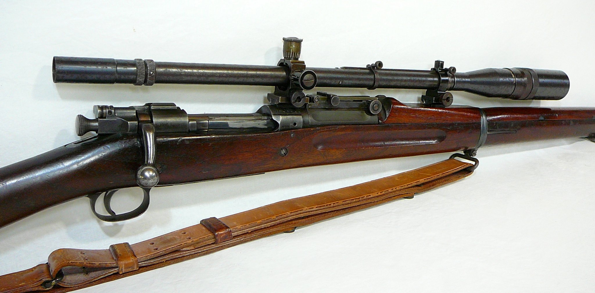

In the past you had talked of the confusion between the Win. A5 and the Unertl and how the system was written about as being "fragile. To me they look pretty much like the same type system. Was it just that the scope was more durable or the mount? That big 'ol long scope hanging out there would seem to me to be pretty fragile as well the the rear, adjusting mount would also seem to be prone to getting dirt and dust in and in short order becoming unreliable in field conditions. Not that I'm right, but could you expound on that a bit?
Awesome collection, BTW! ? For target competition, I'd say they were definitely cutting edge in their day for accuracy. Durability????
Reactions: cplnorton

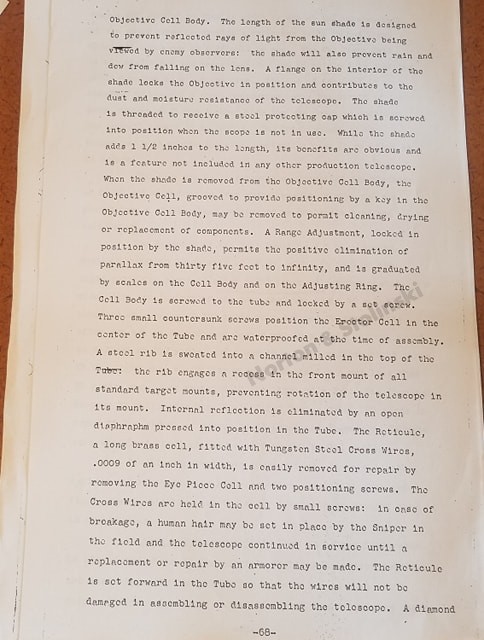

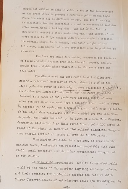

They are very similar in looks but to be honest in quality, the Unertl blows the A5 away. The mounts on the A5 are not that sturdy. The Mann Niender taper block conversion only make them a fuzz better than normal. But the difference really isn't much. They just don't hold the scope tube well and they easily get banged around causing zero issues. Also the A5 scope really wasn't made to handle the repeated recoil of the 30CAL round. They had a hard time breaking under recoil.
My biggest complaint on them is there are no clicks. So you basically have to guess as you dial in the scope. If you know how to read the numbers on the dials on the A5 (both WRA and Mann Niender) I'm sure it helps. But both seem even really hard to read.
On the Unertl it is much more robust and heavily designed. It's not easy to bang around. The scope tube is held a lot more firm. Also there are audible clicks. So It's easy to adjust for windage and elevation.
On the scopes themselves, the A5 has terrible eye relief on the M1903. Even pulled all the way back, it's uncomfortable as you have to get so close to the eyepiece to see a field of view. The Unertl isn't like that.
The other big thing is the recessed lens in the Unertl. It has a sunshade that helps keep dirt and rain from the lens. It's such a trivial idea today, but back then this was sort of revolutionary. I know it's mentioned very highly in the Lloyd and Van Orden Report from 1941. The A5 lenses are at the ends and easily got dirty and you couldn't see anything
The A5 wasn't even water resistant, so they had a horrible problem water. The Unertl wasn't water proof by any means, but it just was a lot better sealed than the A5.
When we get past the holiday I will pull some more docs and post them. I had this one already to go, so I will post this as I knew right where it was. But I will post more when I get time after the holidays to pull them.
By the way whenever it says lyman 5A in the Marine docs, it means A5. They confused the two, as Lyman made a copy of the A5 startng in 1928. But the Marines only had five lyman 5A I can track compared to 887 WWI era A5's. Even in the docs they detail they had Lyman 5A's leftover from WWI. lol So the Marine typing up these docs was just confused. Except for very minor differences they are the same scope. Just a copy made of the original WRA A5 by Lyman

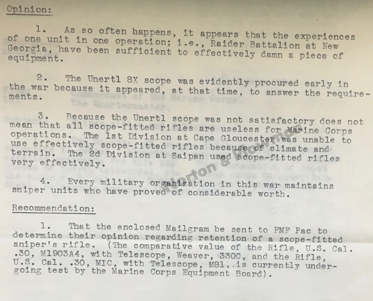

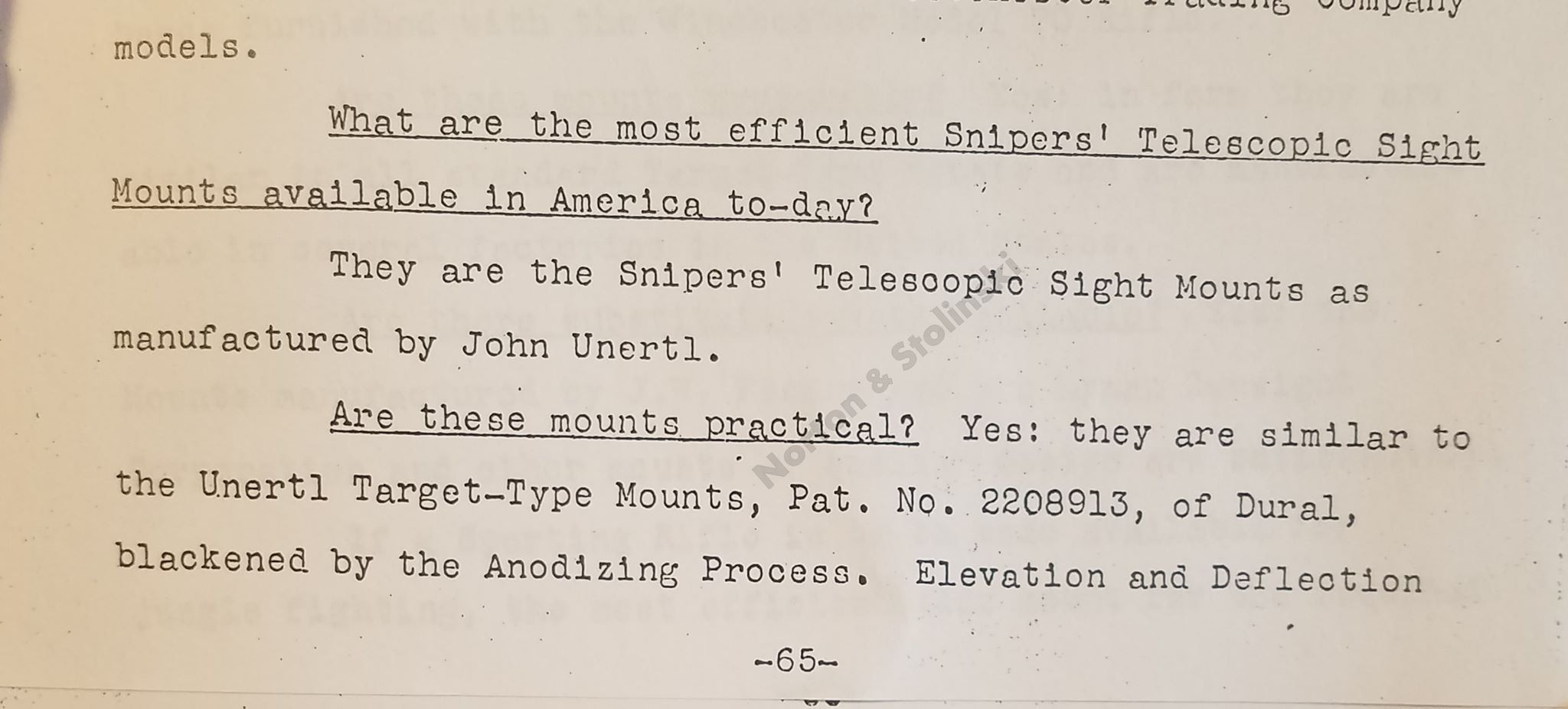

On the A5 vs Unertl confusion.
This is literally the report that damned the Unertl Sniper. This was a report by the Marine Raiders in the fall of 1943. This is ALWAYS the report referenced in the Marine docs as what sealed the fate of the Unertl.
It's really unclear if the Raiders had any Unertl Snipers at this point at all. There is no mention of them getting them. But they did have 80 A5 snipers that were built around Feb/ March 1942.
This report that cancelled the Unertl Contract never details which sniper they didn't find effective, though I am very certain the A5 is the rifle referenced here. The Marines later address they think it is possible they confused it as well.

Here is a doc where they detail the report above damned the Unertl. Below where it mentions the 1st Div couldn't use snipers on Cape Gloucester, it should be noted that any of the 1903 snipers could be detailed in that. As the 1st Div had the A5, 1903A4, and the Unertl all at that time, though it should be assumed they mean the A4 and Unertl. The 2nd Division on Saipan had both the A5 and Unertl, but it should be assumed the Unertl is the one referenced. As the A5 was in very small numbers for the 1st and 2nd Div. They each received 20 A5 snipers in 1941 for training. It is not for sure they took those A5's to the Pacific but it's very possible.

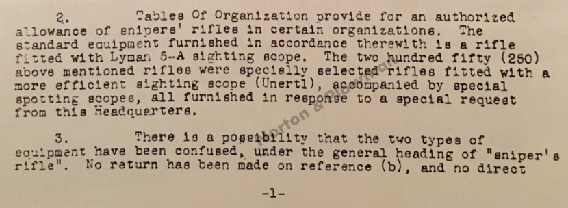

Here the Marines are starting to wonder if there is confusion on the Raider report above that damned the Unertl.
