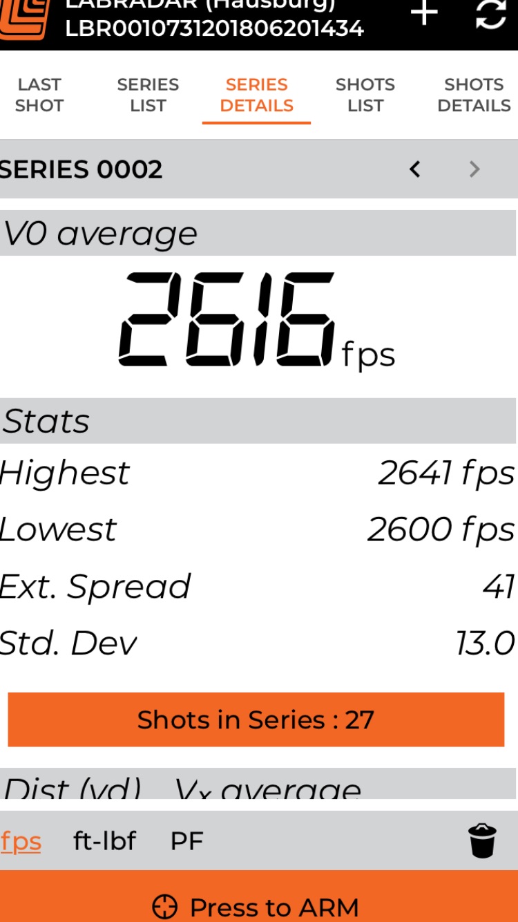

I bought 500 pieces of 308 Lapua LRP brass right after I sent the barreled action to Chad. I wanted to make a nice soft 185 load that still had enough ass to make it to a thousand and fire form my new brass while I was getting to know my new barrel. After screwing around on Quick Load, I settled on 210m primer, 43.1gr of Varget with a COAL of 2.890. Predicted MV was 2600FPS.

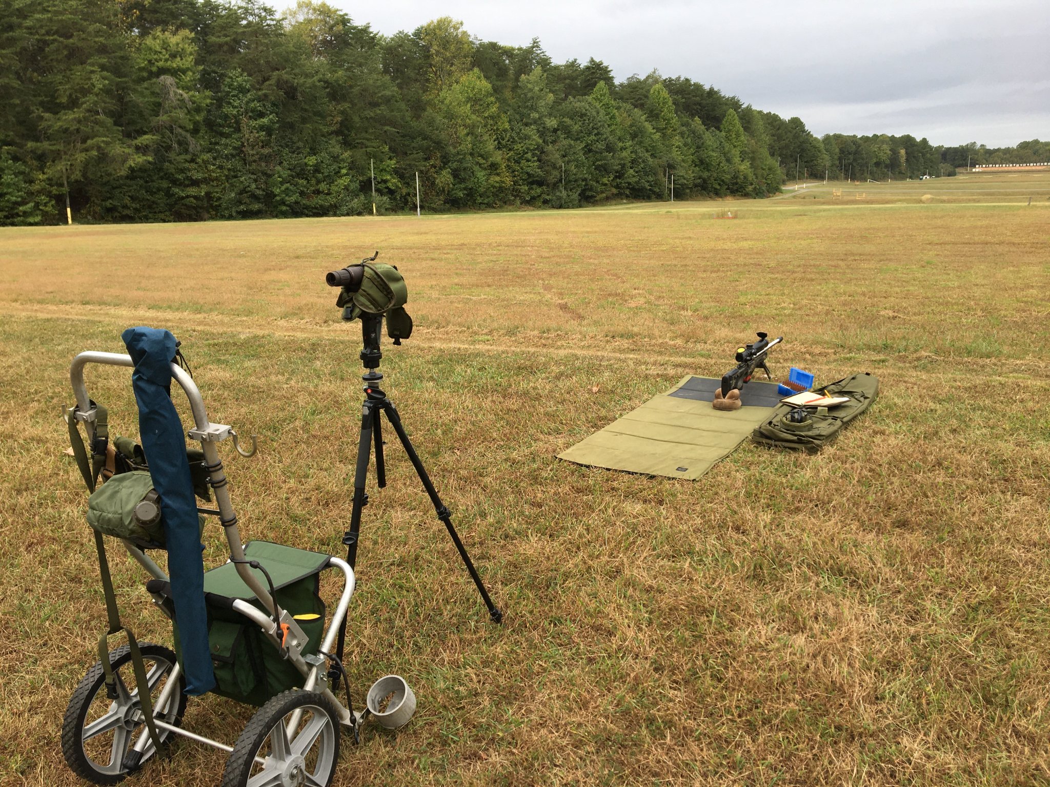

Last Sunday the conditions were perfect, overcast was a DA of 300ASL.

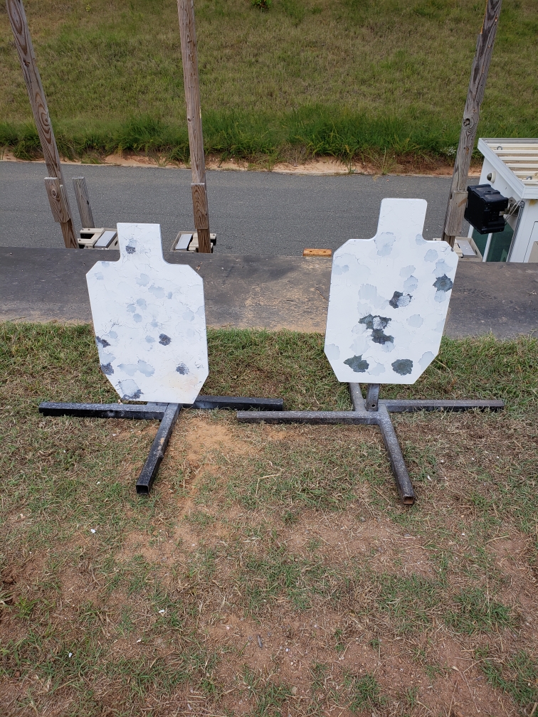

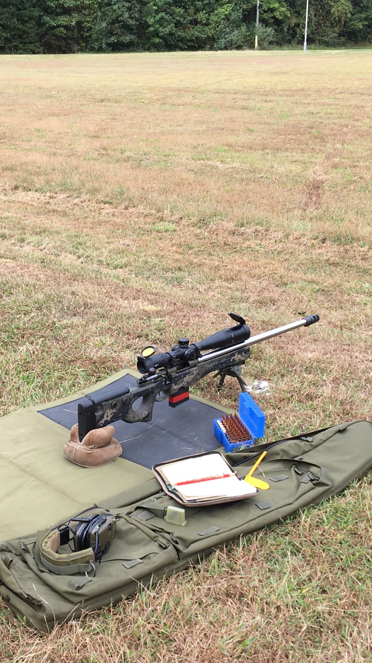

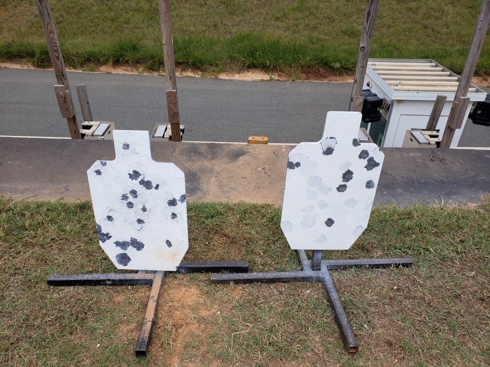

I’d set two 25x15 IPSAs on target point 25. One to figure out where I was and one to attempt groups. By the time I took these pics, I’d already put the Labradar away but QL was pretty close.....
Rifle shot pretty well for a “soft slow” load. Not bad for fire form loads. I‘m used to running these bullets much faster around 2725FPS.
It was 35.5MOA to 1000yds with .5MOA left wind (That‘s 10.4 mils for you other guys), not bad for a slow loading. That’s about the elevation 175SMKs used to run with a much higher DA.
