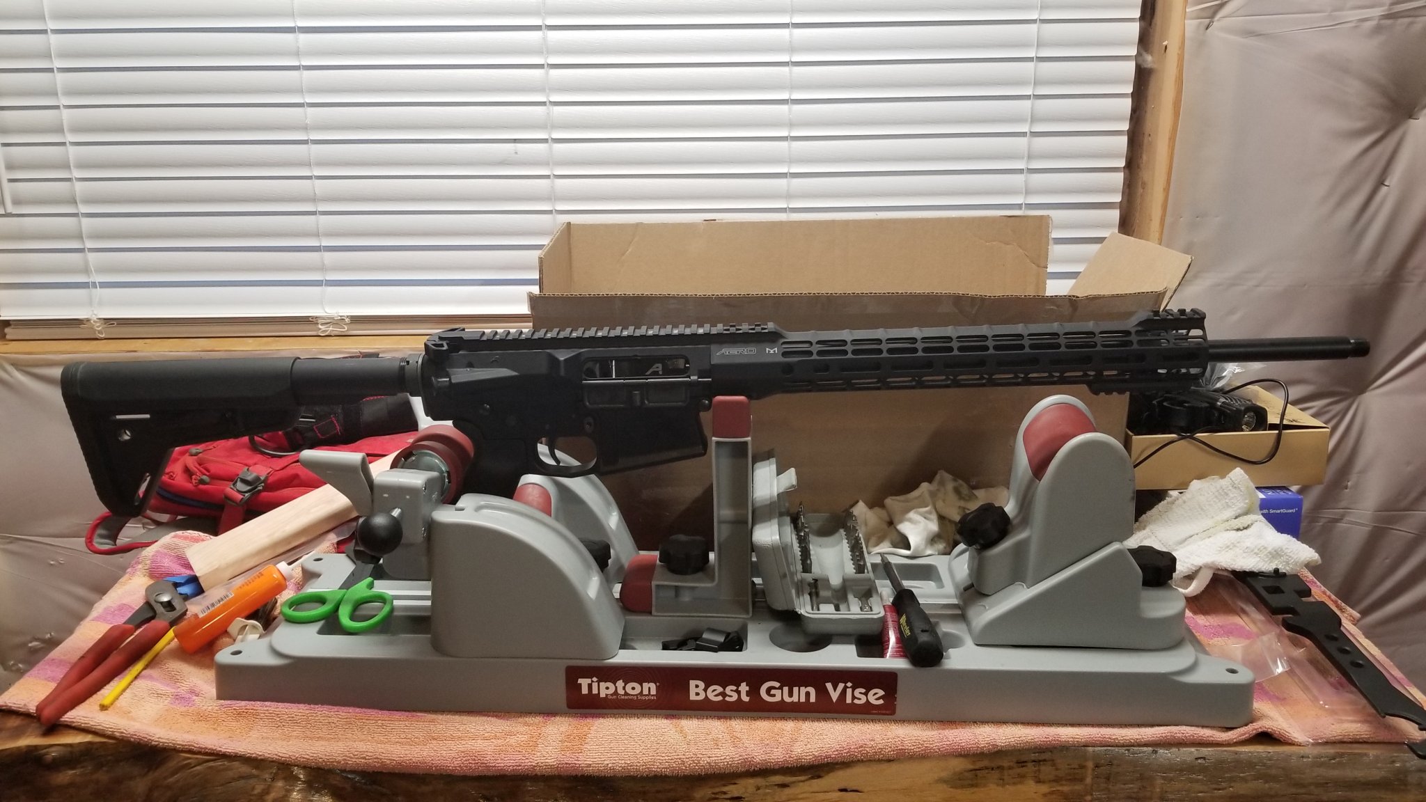

I had LRI build me a very nice Rem700 a number of years ago, and ever since then I have only been able to think of how much fun a semi auto platform would be. So fast forward a number of years, and Aero Precision has a sale i just can't pass up on. I also thought this would be a good time to see just how big of difference reloading makes. I opted to do a "budget" build sticking with the base model of all components (excluding the optic) while a buddy really wanted to do the same thing but he opted for nicer components and shooting factory ammo. His build includes the enhanced matched reciever set, nicer BCG, Geissle trigger, and SS barrel.
For now i plan on swapping my K624i back and forth. Im glad i went with the atlas handguard because it just barely left enough room to run the optic/ rings setup i had.
I will update next week the results of factory ammo. Hopefully it wont blow up as this is my first custom AR build as well.

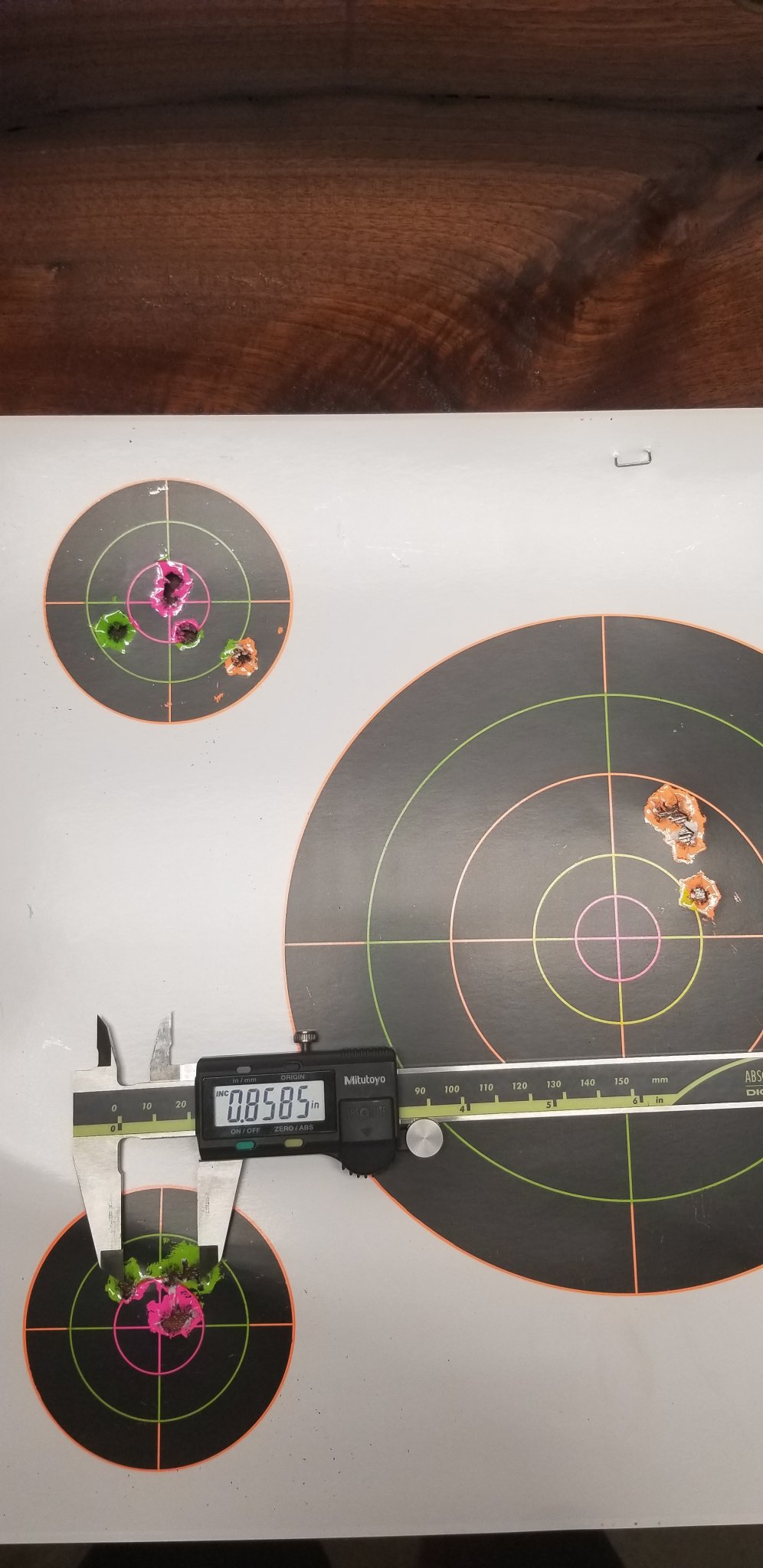

Had some issues with initial sight in. My zero was jumping all over, ultimately I think the barrel just needed a bit of break in. I also got tired of swapping optics, so I picked up a gen 1 PST 6-24. Looks a little goofy with the cantilever so I may be looking for a slightly lower 1 piece mount in the future. Also, the only true issue I am having is FTF/double feeds. I think the buffer spring may be a bit too stiff.

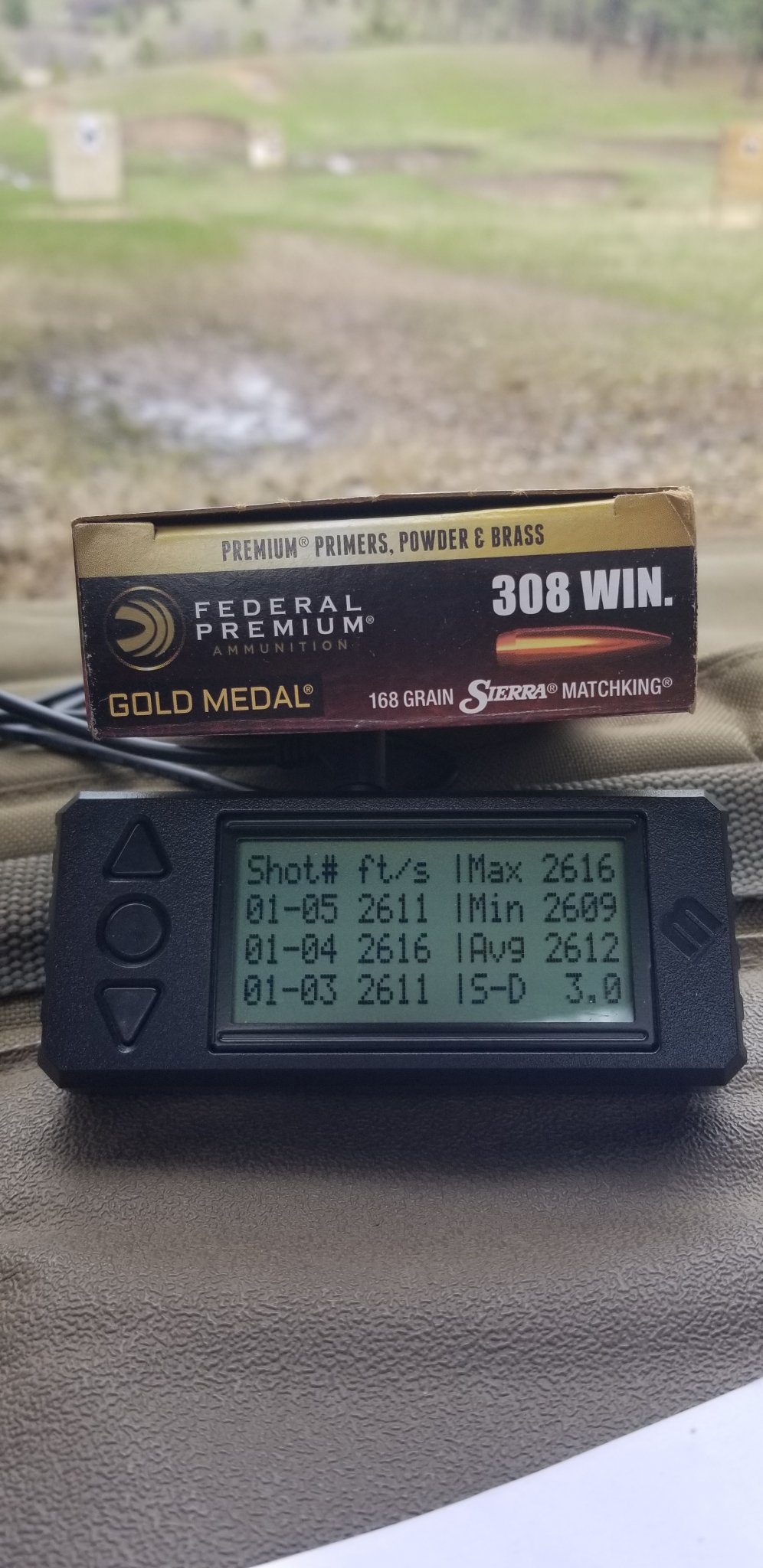

Been shooting 168gr FGMM, decided to chrono it over my Magneto Speed. 3 5 shot strings. Avg velocity was consitent, but SD was 3-11.4.

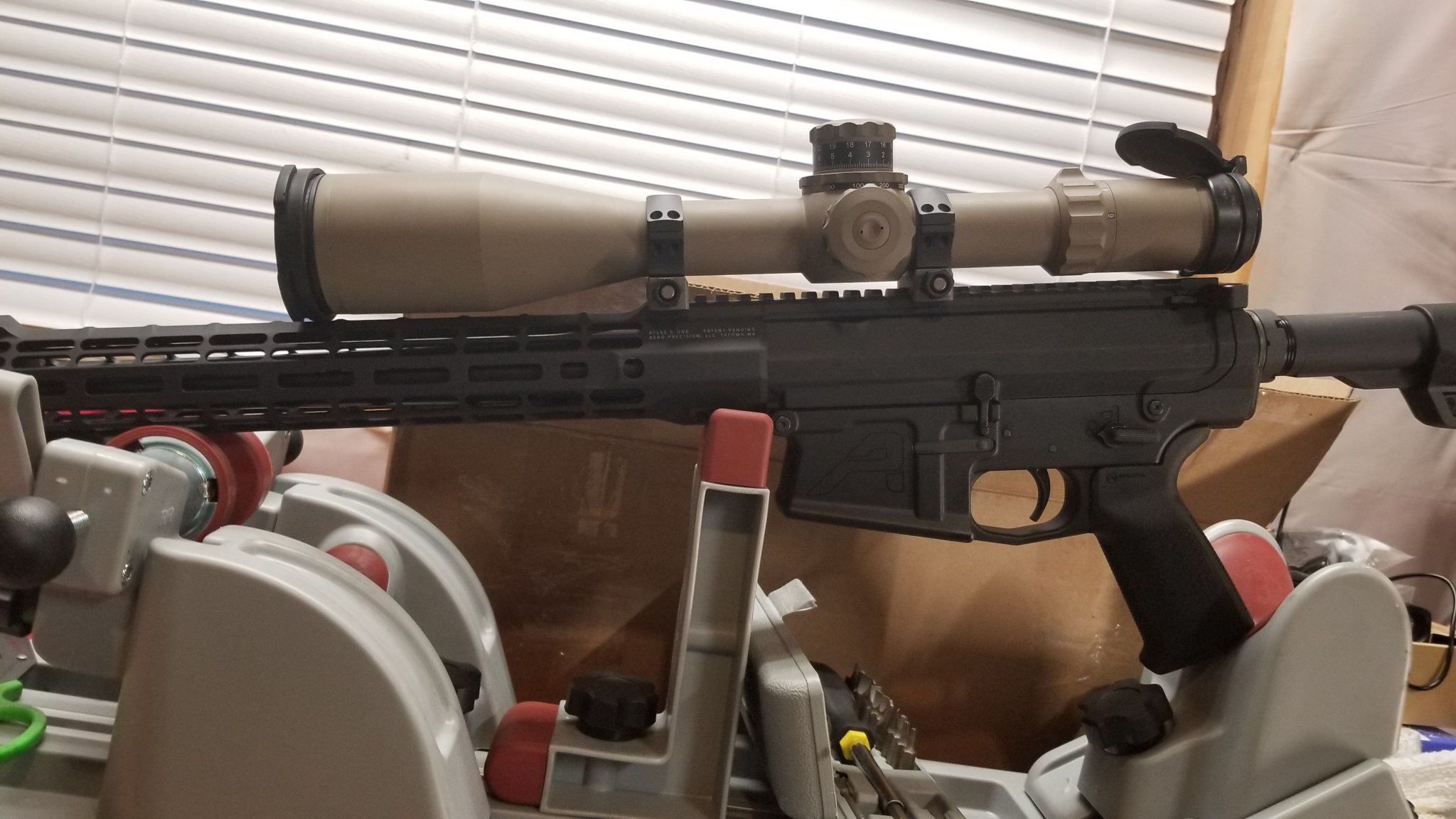

Your neck is going to hate you as soon as you hit the range lol. Go 1.4 or 1.5" rings, seriously.
Agree with other poster, mount rings directly on receiver and only the receiver - no exceptions. This will also allow you to set the rings further apart to make it more rigid.

Details on the other parts used in your rifle? Keep us informed on the results.
Aero M5 stripped receiver set (not enhanced)
Aero Atlas 15 inch M- lock hand guard
Aero 20 inch CMV barrel with rifle length gas system
Aero 308 phosphate complete BCG
Aero Low profile gas block, rifle length gas tube
Aero Enhanced 308 lower parts kit, forward assist, and ejection port cover
Aero Carbine length buffer tube and H1 buffer
Magpul MOE SL stock
Unsure about muzzle device
Appreciate the input, but the pic is not that reliable. It is a bad angle, and posted quickly from excitement. The optic rests completely on the upper receiver, the rings are just spaced wide from how it was on my bolt gun. The height was surprisingly comfortable, more so than the bolt gun. But I have a feeling vibration and recoil may cause the optic bell and hand guard to contact (No Bueno!)

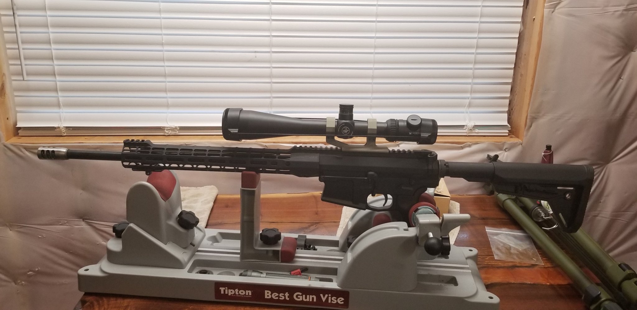

I doubt you’ll have any issue with the rail and the bell making contact. Let us know if you do please.
I use a 20.6 moa Spuhr (4602) mount with a 56mm objective (ATACR 5-25 F1) on a flat rail and it is tight - objective to rail wise - 1/8" clearance and shaved obj cap. But, the 1.5" height is not a problem for cheek weld - at least for me. That jam to the non rail handguard is interestingly low but seems to work fine on the Gen 2 RPR's. Do get all your mount on the receiver, though.

but i will say for me, safe but higher velocities in my 7.62x51mm (.308) is desirable if i want to test my limits in distance.
i have a 20" barrel (1:12 twist if it matters). cold hammer forged, chrome lined.
general consensus seems to be that (at sea level) 800-900 yards is the max limit for FGMM 175gr before the smk pill drops out of supersonic and/or loses stability (wobble and tumble). after many hundreds of thousands of rounds shot through this platform (by others), the SMK BTHP is the accepted standard for accuracy (versus so many other different bullets).
but then i have "seen" and read about plenty of people saying they hit 1000 consistently. are they all shooting at 7000 ft elevation?
so now i am challenged to see if i can do it (even though i don't compete in any way and am not any sort of marksman).
mostly just because somebody told me it can't be done, unless i can do it myself.
i am curious to see if tipped sierra match kings would keep it stable longer. no doubt wobble ruins BC real quick, and i and not sure how much higher velocities affect spin rate.
maybe the lower BC of the tipped, assuming it shoots as well as SMK can tip the scales in my favor?
if i can eek out a little more velocity to keep it supersonic at or beyond 1000 yds (at sea level, in an ice storm), it will tip even further.
i'm also considering Hornady Superformance Match, since they claim "safe" velocities up to ~2800 ft/sec (vs 26xx for the FGMM), but nobody has reported "super" results with a 168gr ELD out of these rifles. maybe it is worth a try.
The berger spin calculator says 168gr VLD is stable with a 1:12 twist at above 2700 ft/sec.

thanks. i'm going to give it a shot, but since a range with 1000 yards is not close, i will take a few things to try.
if i do try the hornady superformance, i can turn the gas down to the suppressed setting just in case.
