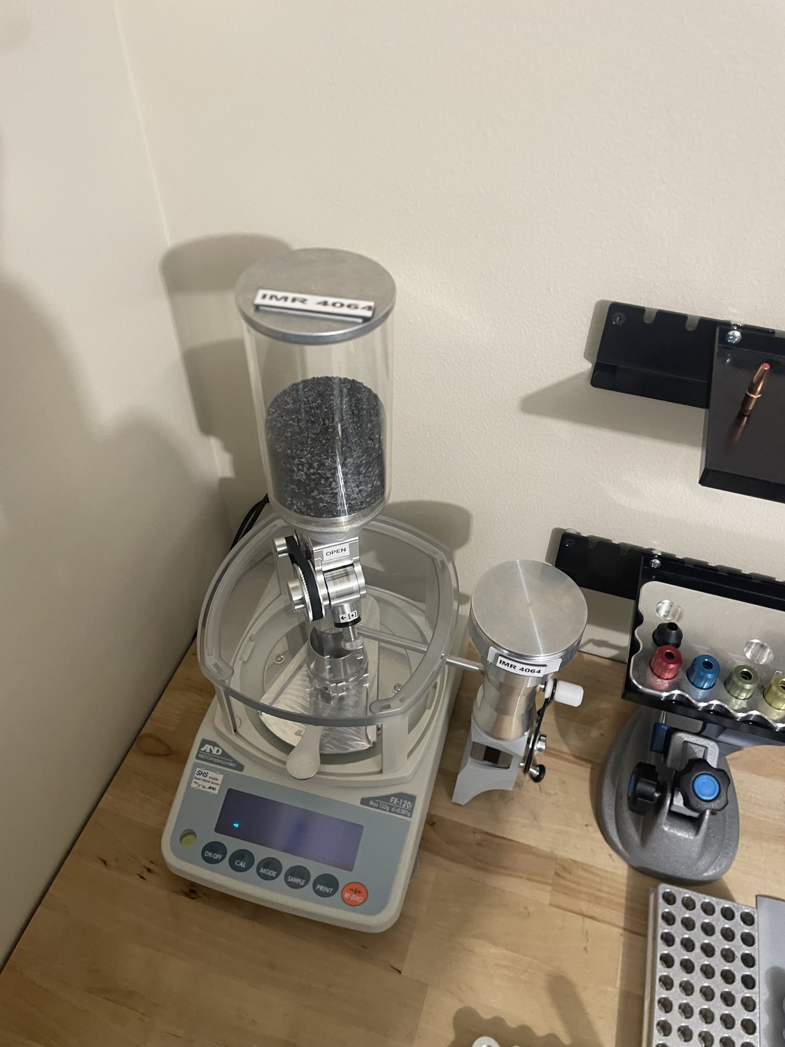

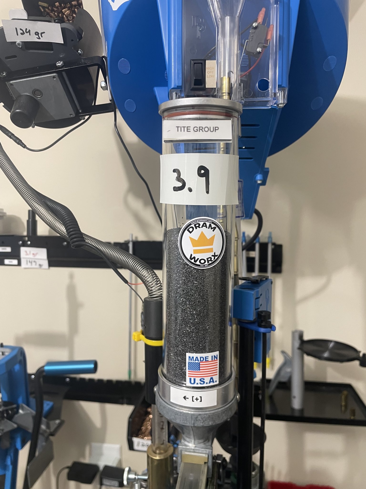

I made labels put them on magnetic tape for my powder measures. Can’t be too careful when it can be awhile between reloading sessions.
I just added some white metal tape so I can write the charge weight with a dry erase marker.
I’m poor so I use post it notes.

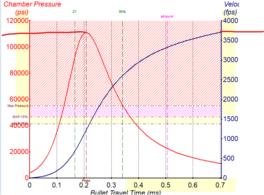

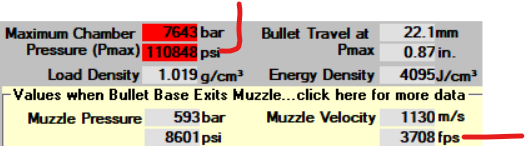

I may have missed the caliber and bullet weight. Gordon's Reloading tool is free download. I can plug in the specs if you post them.
