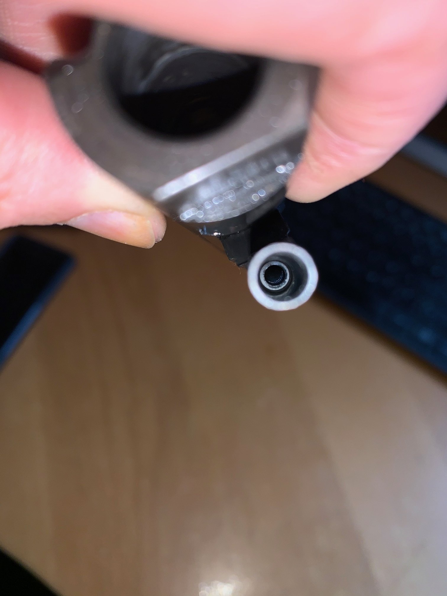

    I usually fly solo when going to the range, but I've had a few friends bugging me to take them.
    Brought 5 of them last weekend, 3 of which are brand spanking new to guns.
    I do enjoy teaching new shooters, but look forward to my next solo outing.
    1 Girl that was new had a 1911 45 home built POS she inherited. She also had and AR that ran perfect thankfully.
    1 dude had a Kimber 1911 9mm that kept stove piping cause he was limp wristing it.
    Another buddy had an M&P 15 that turned into a single shot after his first round (lottery winner).
    1 chick had an absolute blast shooting a Walther P-22 that I just completely reworked.
    Needless to say I was busy and came home with 2 broken guns to fix (theirs).
    The single shot AR I figured out pretty quick at the range but just got around to fixing it.
    What are the odds?

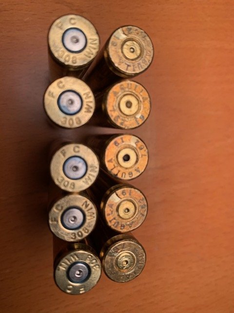

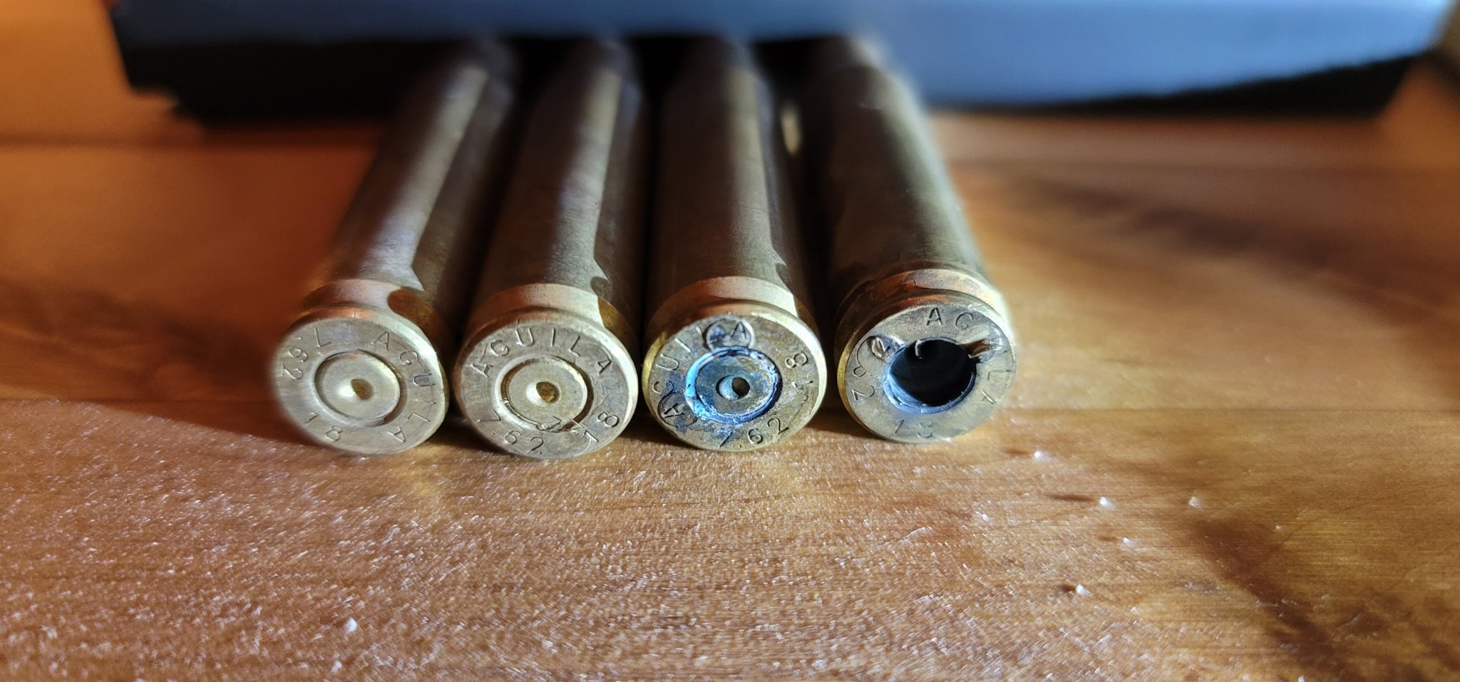

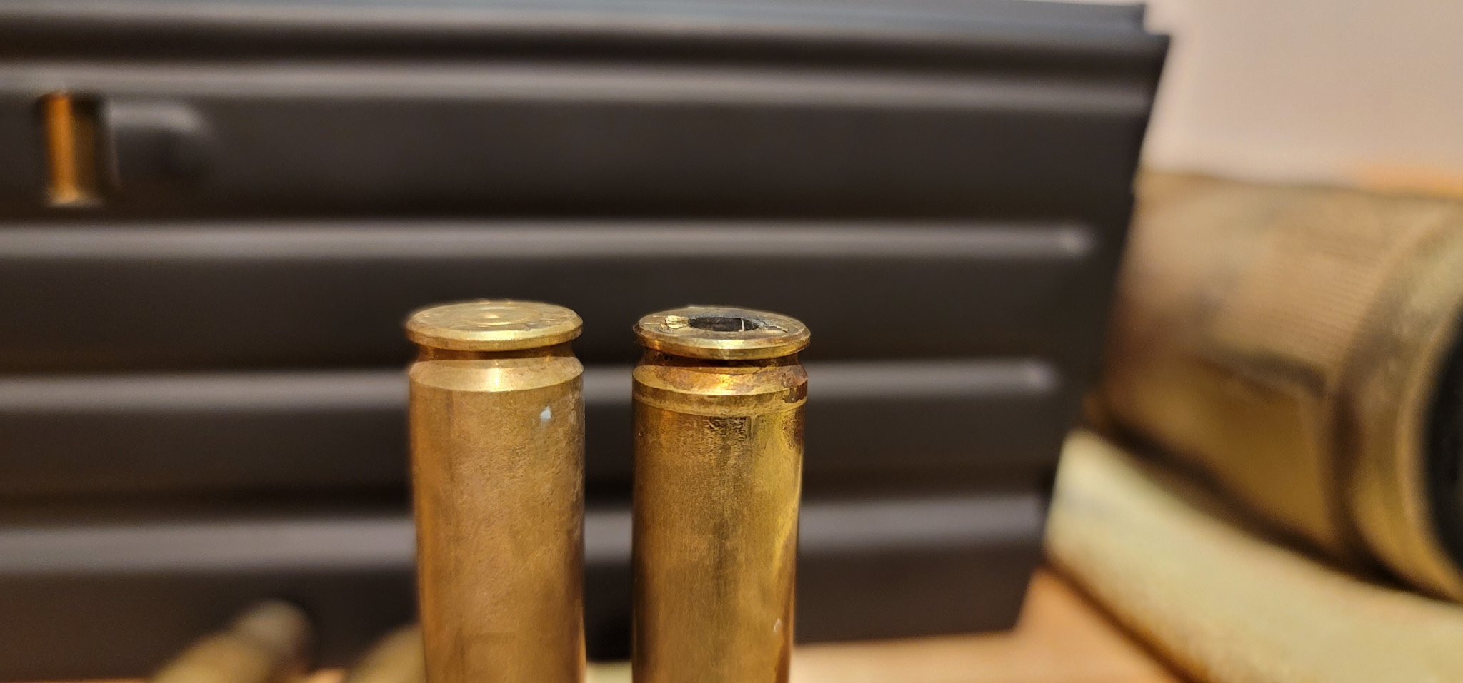

    Apparently the very first shot he took blew a primer that went straight into the gas key. It was deep enough that the gas tube wasn't touching, but I bet he put another 30 rounds through it firing single shot & the gas pressure pretty well swagged the fucking primer in the key.
    How/why did he lose the primer to begin with? Hand loads?
    He was shooting M855 factory he bought at the range. They were in a zip lock bags @ 50 pc's per. Probably Aguila, that would explain it!
    Before I figured out what had happened I checked a few of his manually ejected cases and they looked good. No pressure signs at all.
    The odds have to be incredibly high for a first shot primer up the poop shoot.
    Heard of the primer in the gas key trick quite a few times now.
    The Kimber wasn't working because it said Kimber on the side.
    I'd heard of the primer in gas key, but this was the 1st time I've seen it in person.
    What are the odds?

    Aguila 7.62x51
    Never any issues out of my first gen Sig 716 till I shot this stuff.
    Other 7.62x51 I have shot plenty of, is stuff from MEN with no issues. This was my second outing with it. The first time had a case stuck so bad I had to pry my carrier out with a screwdriver. Had two or three cases looking just the same. You couldn't give me a 30' container load for free if I had to keep it. Would only give it to my worst enemy.
    Aguila 7.62x51
    Yep I will only use it for extreme function testing.
    When I got my DPMS dialed in & wanted to prove it would run any 308............Aguila 7.62 was the test.
    It served that purpose well. The gun ran it, but I got a face full of gas everytime it pierced a primer. The ejector swipes were epic raised burrs.
    Brass is butter & primers are trash.
    Hard to believe these were shot from the same gun, same day.

    I didn't bother measuring, but a sml rifle primer fits. My guess is it's a loose fit, but all bet's are off when the primer is blown (likely swells). Against very long odds; this one went in the key cup out. I'm guessing here but I suspect the gas tube seated it right over the angled connector hole in the key (that's where it was parked). The full port pressure from his next shot swagged the damn thing in there bulging into the angled hole.
    To fix it I had to run through about 6 # drills until nothing was left. It had such a good bite on the angled hole it wouldn't budge.
    After seeing this I'll be sticking with large primers in my large frame DPMS's since they don't fit in the Key!
