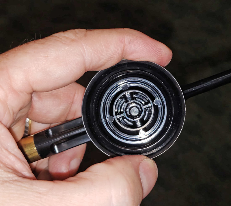

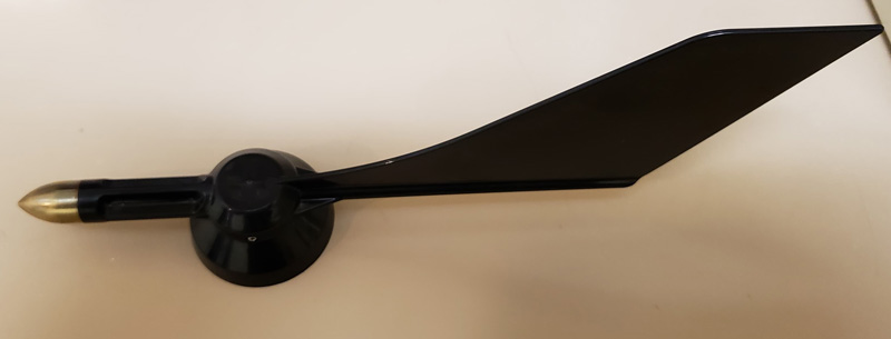

    This is a replacement wind vane for a Davis weather station.

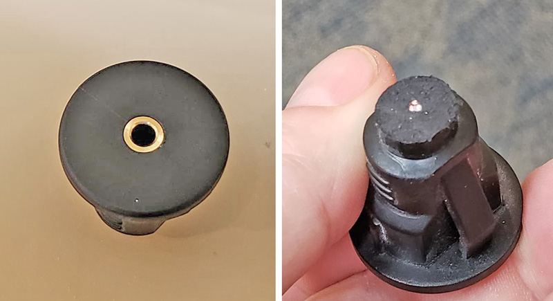

    This is a 3.5-mm jack extension cord made to install on a car dash. I cut off the wire and ground the base flat.

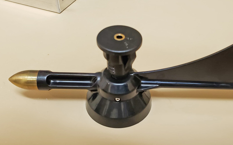

    I hot-glued the 3.5-mm jack to the top of the wind vane. The Weathermeter has a 3.5-mm jack so you can mount it to your phone.

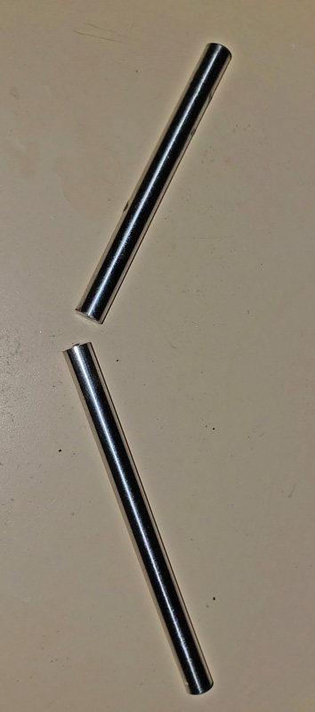

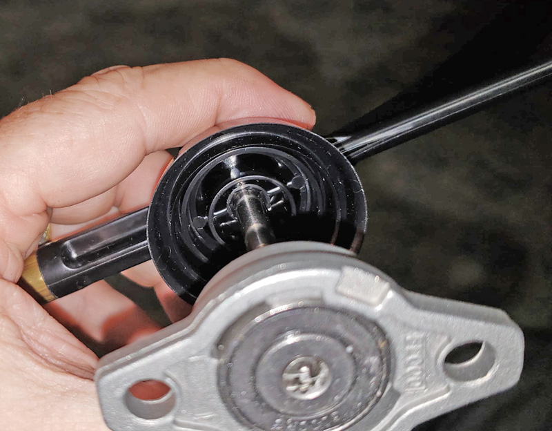

    I got a 1/4" x 6" stainless steel rod (shortest I could find on Amazon) and cut a 2-1/2" piece off.

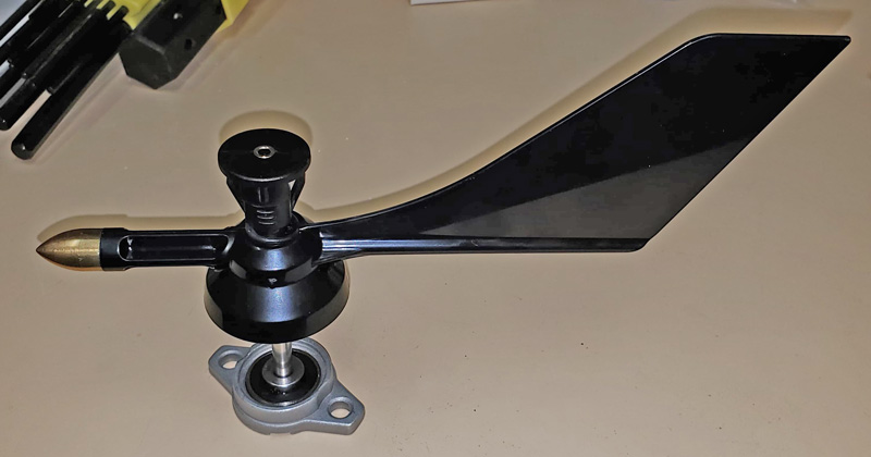

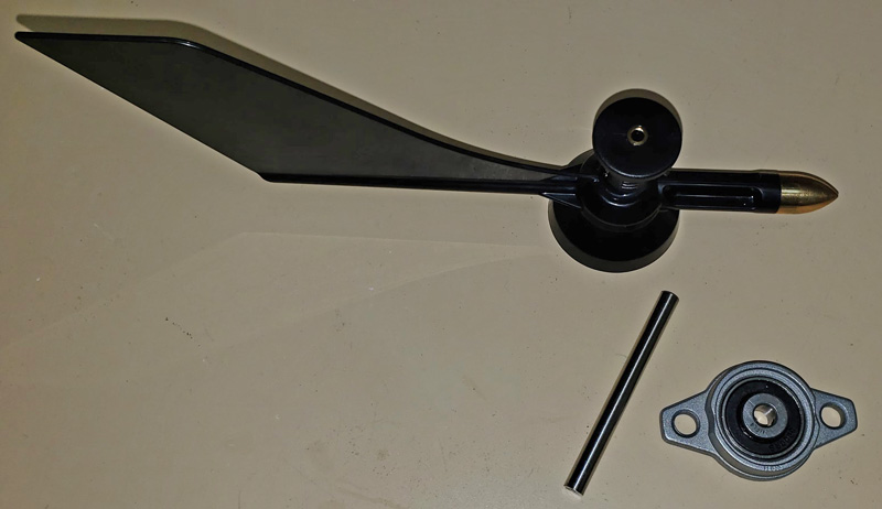

    I then got a flange-mounted bearing with a 1/4" hub. There are two hex set-screws to secure the 1/4" steel shaft.

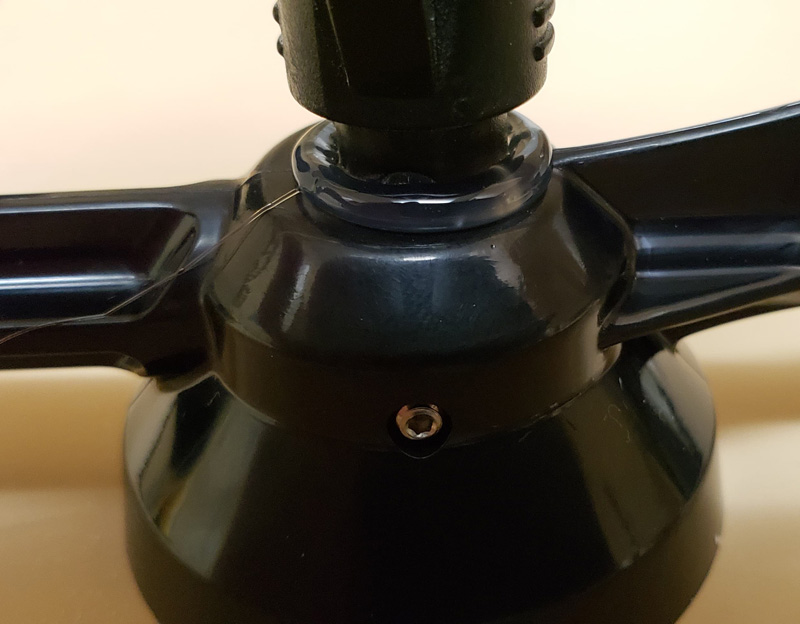

    The wind vane has a 1/4" socket in it with a single hex set-screw.
    (to be continued in next comment... stand by...)
    Inserting the other end of the shaft into the wind vane.

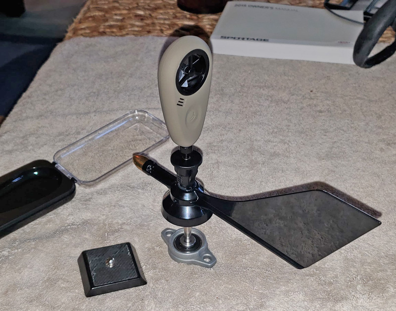

    Weather vane assembled!

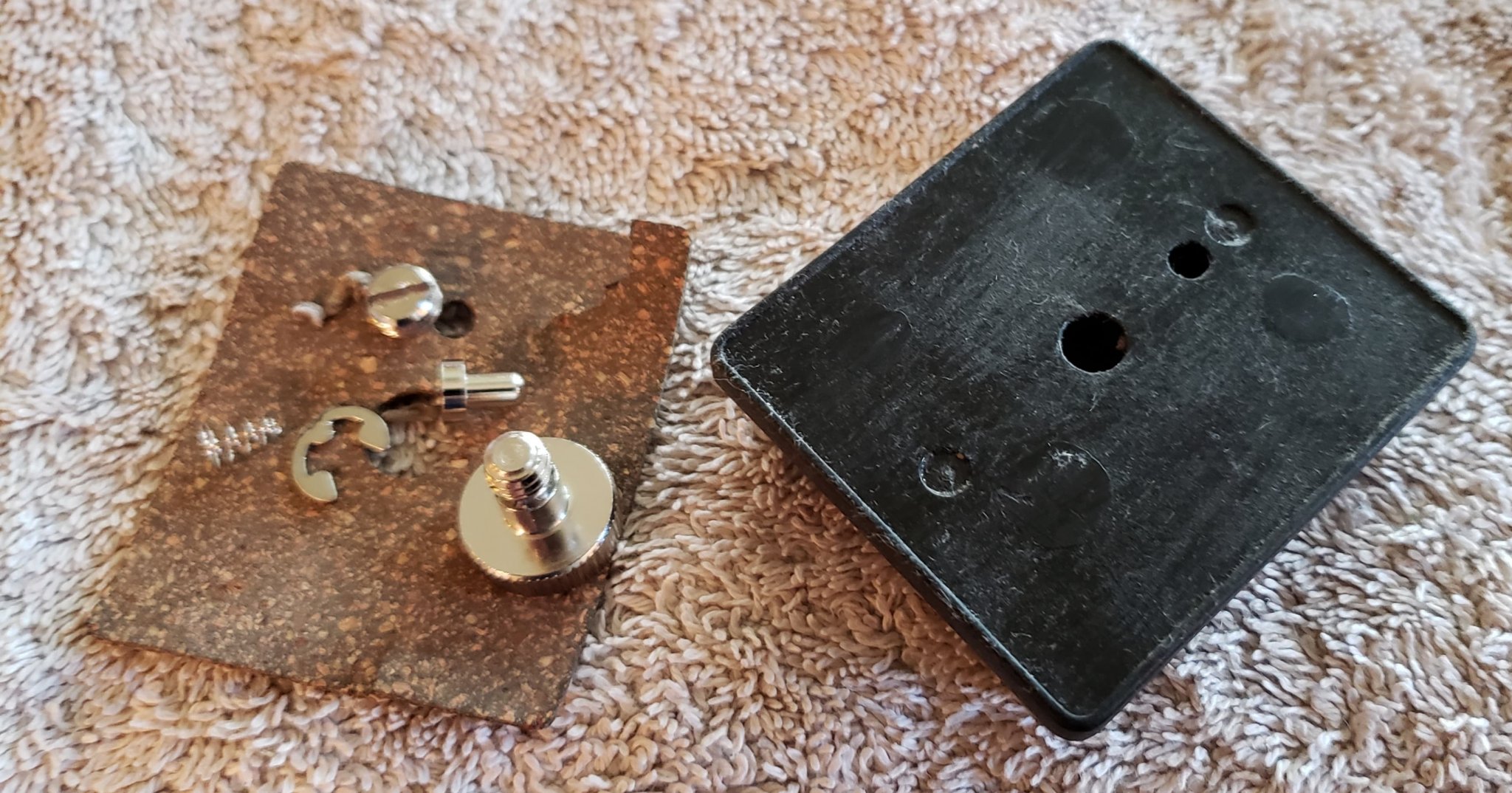

    Next... I need a way to mount it to my tripod. The quick-release mounting plate I had was too small (not enough room for the bearing). So, I ordered a new one with a larger top plate.

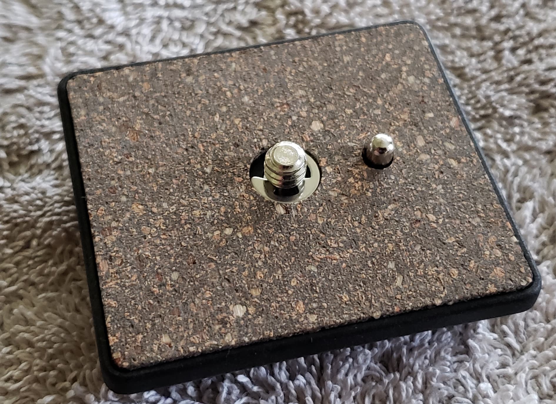

    I peeled off the cork and took out the hardware from the quick-release plate:

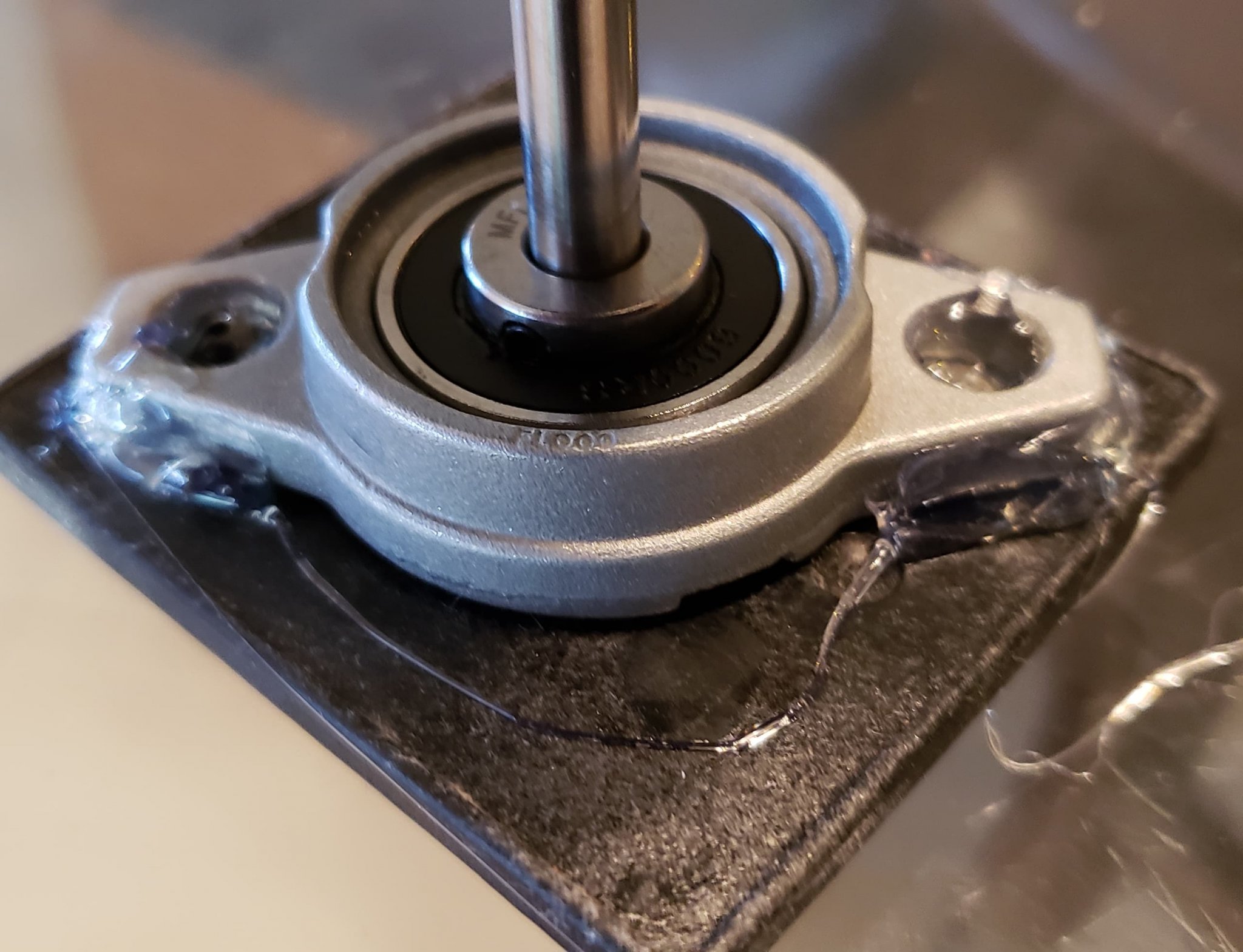

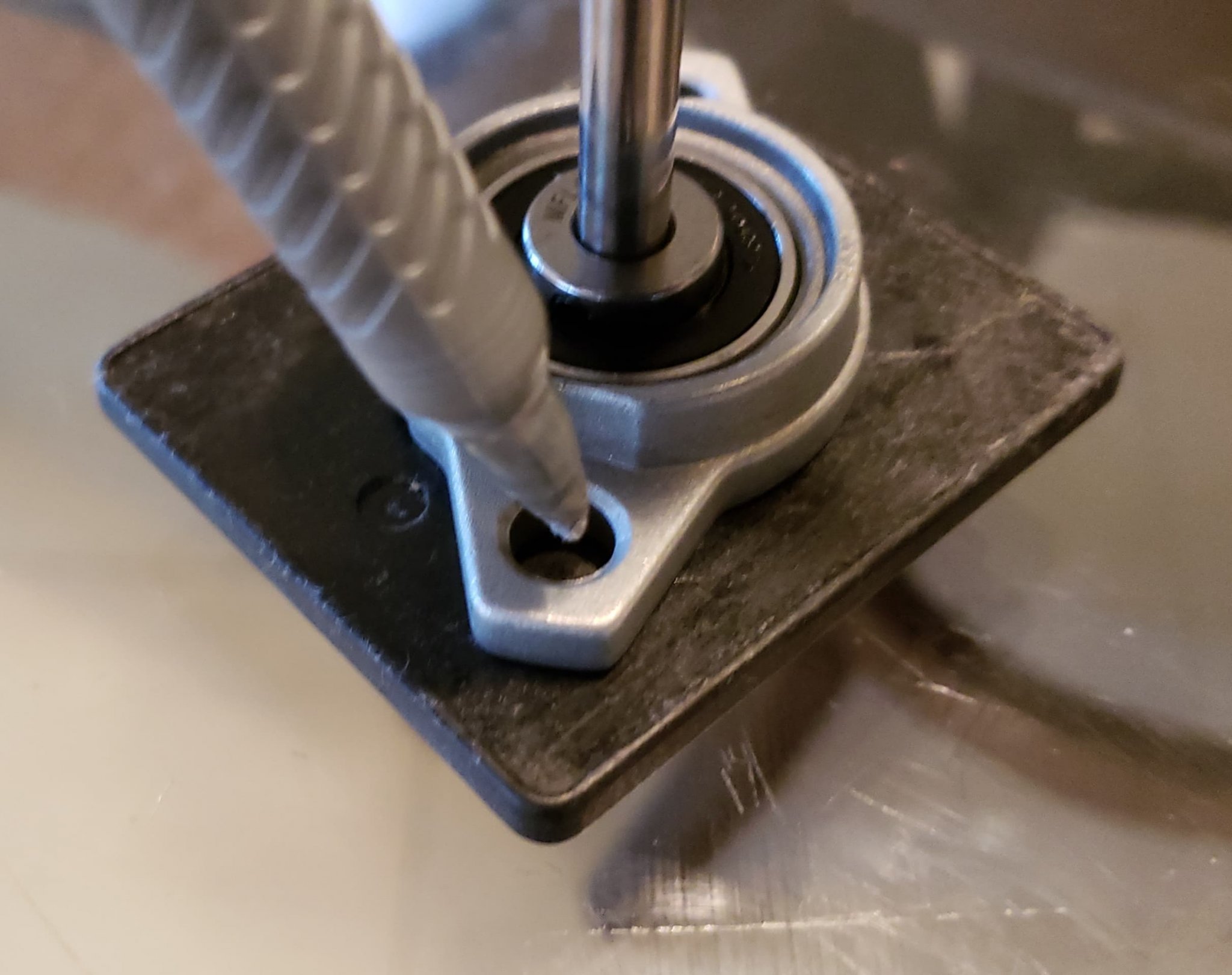

    Next, I hot-glued the bearing flange to the quick-release plate. It became apparent that this wasn't going to work - it came loose quite easily. The glue wasn't sticking to the quick-release plate.

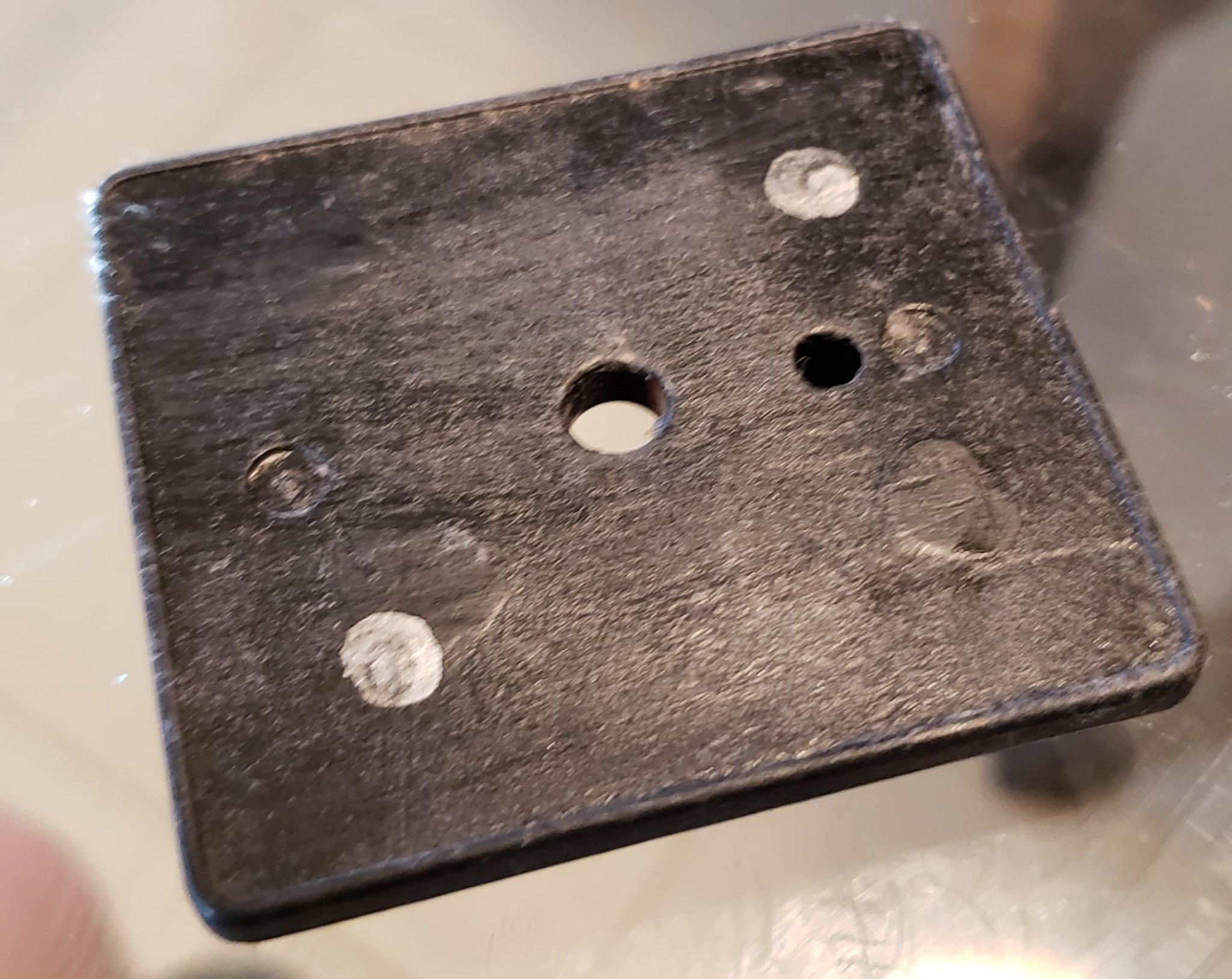

    So, I removed the glue and marked the holes on the quick-release plate for drilling.

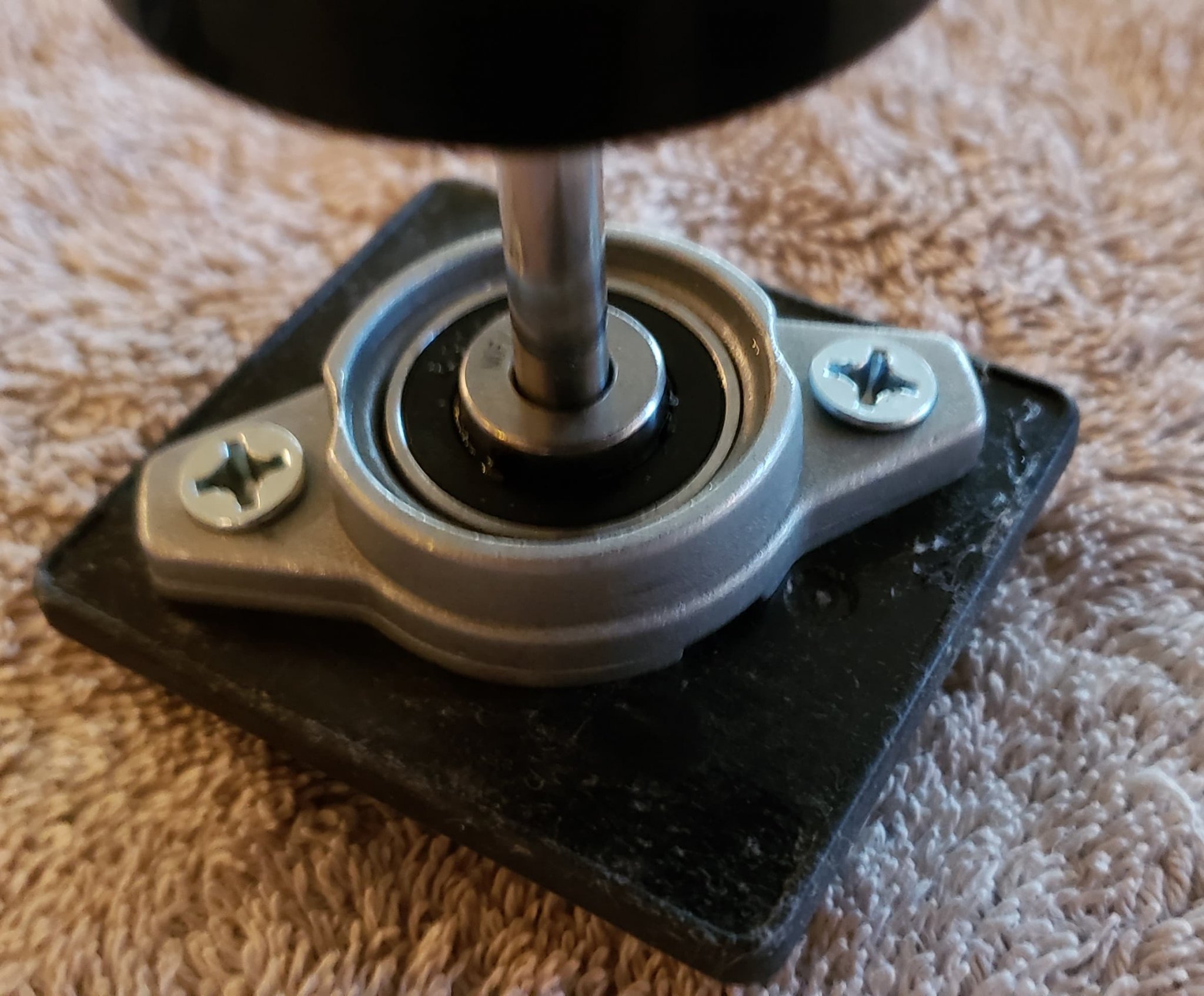

    Luckily, I happened to find the perfect screws in the garage.
    Now, that baby ain't moving!

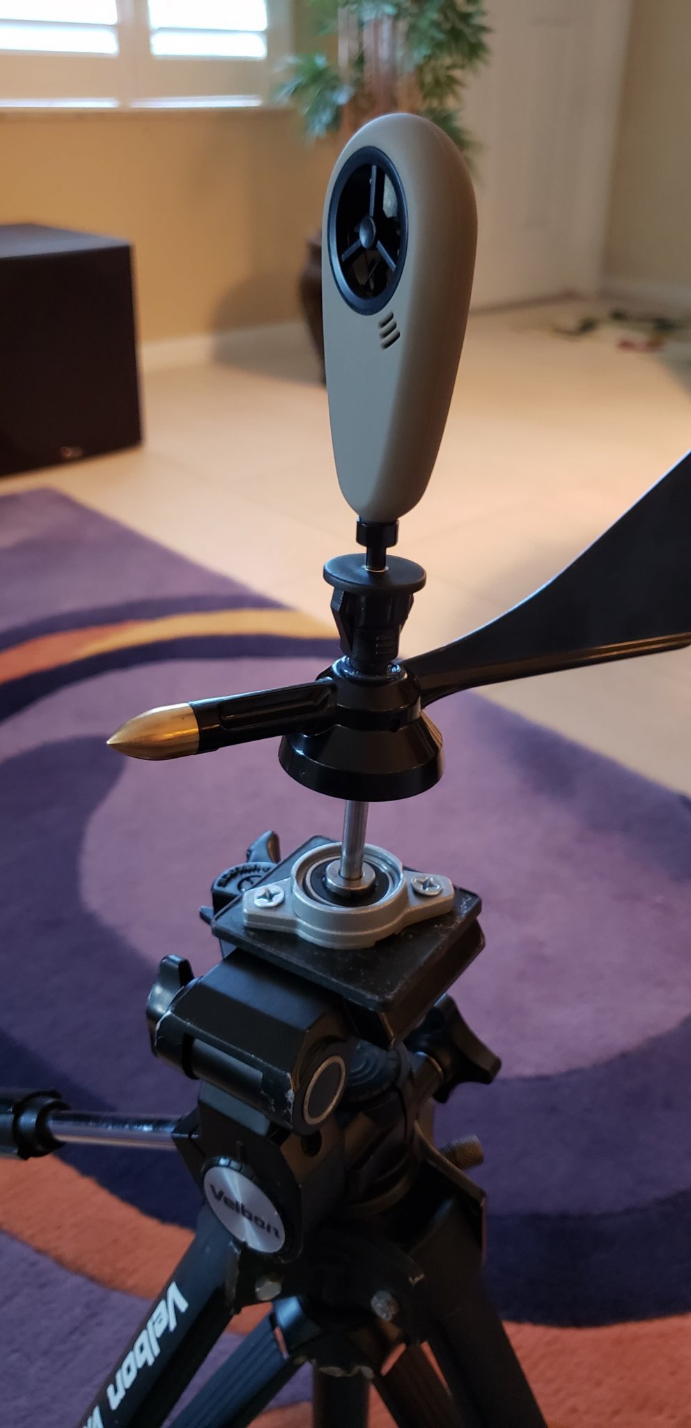

    Here it is on the tripod!
    Retrospectively, I would have made the shaft shorter. Also, I could use a 1/4"x20 (thread) stud with a couple of nuts to secure the weathermeter to the wind vane (instead of the 3.5-mm jack).
