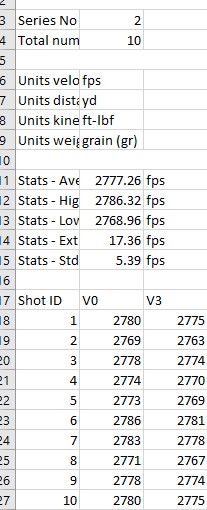

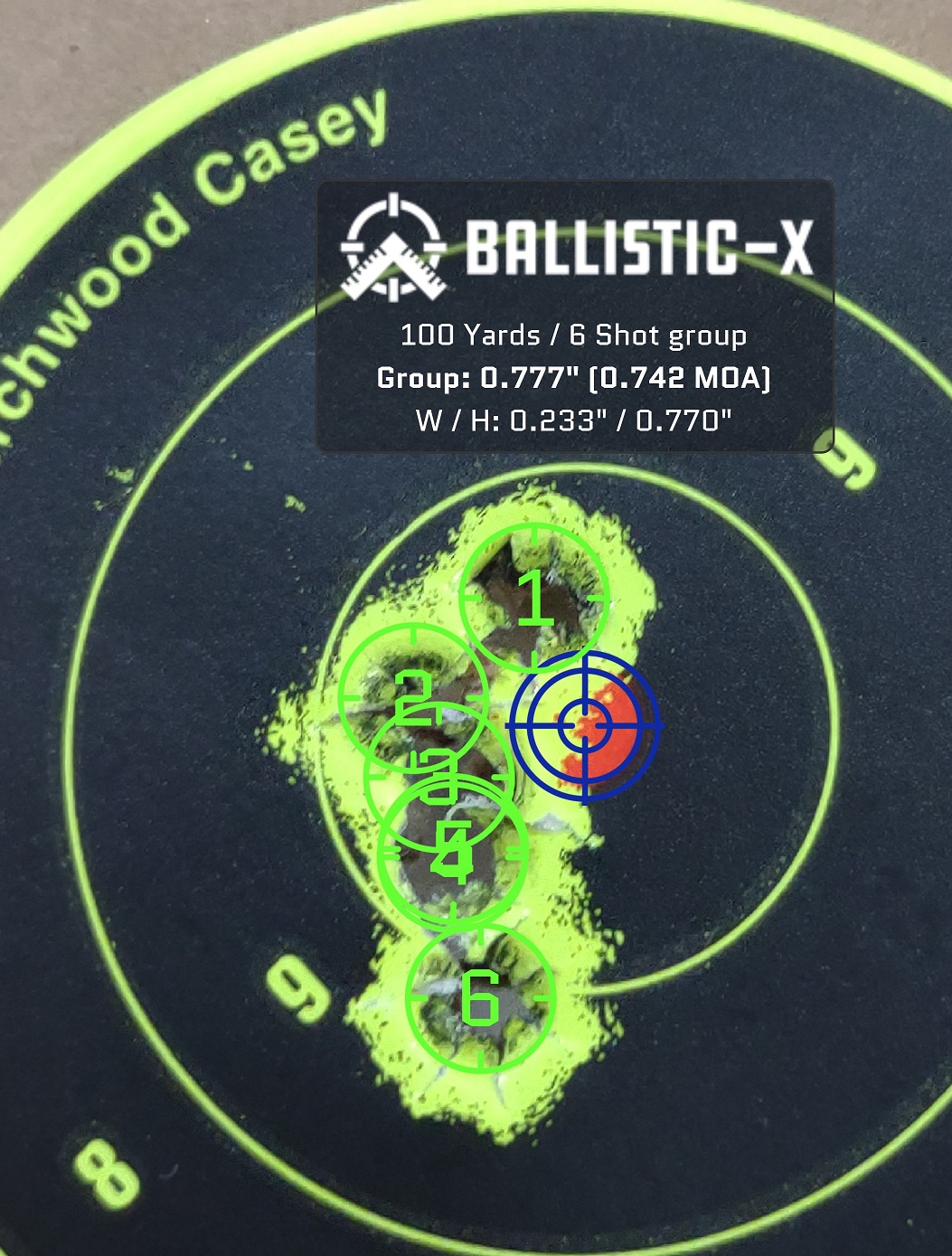

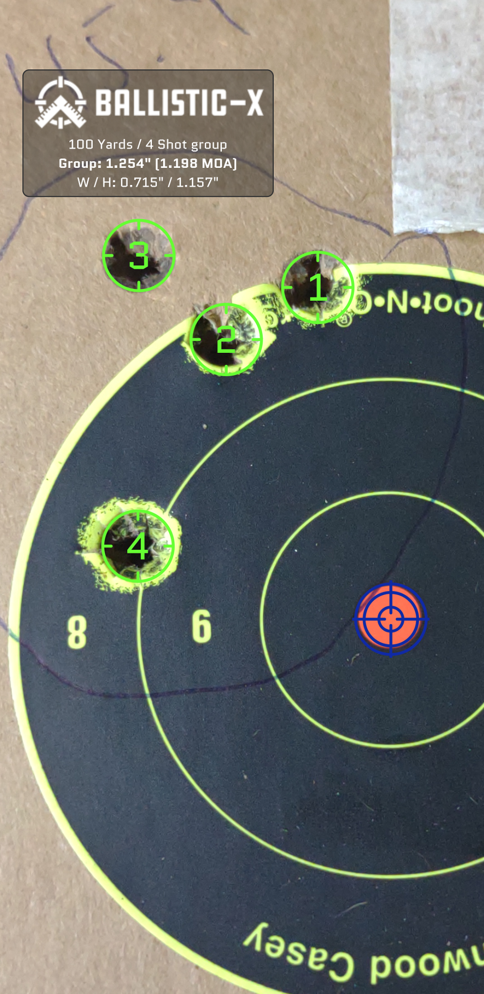

The targets that I've attached were both shot out of the same rifle with the same load. Sierra 165 Gamechanger, Fed 210M, 45.4grs Varget, Lapua Case, out of a Bighorn Origin with a 20" Proof carbon fiber barrel in an XLR element at 2777 fps (my 10lb hunting rig). On one target the brass was annealed, on the other it wasn't. I'll let you guys decide which is which and shot 6 was my fault.
