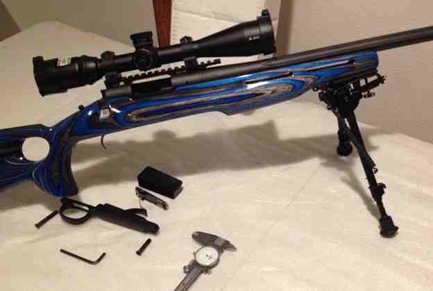

I've replaced the M-308 mount, which sat too high, with a set of WARNE Low, steel, scope rings.
These are very well built rings, which include recoil lugs, and are available at very reasonable costs.
I went ahead and mounted, leveled and bore-sighted the scope. Here are a couple of pictures that I took with my iPhone.

Yesterday I picked up a Harris SLM bipod and fitted to the current stock.

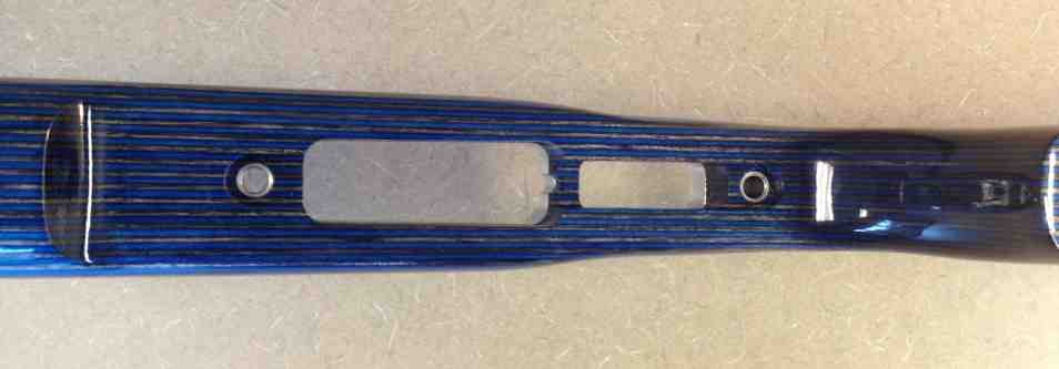

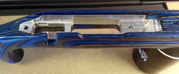

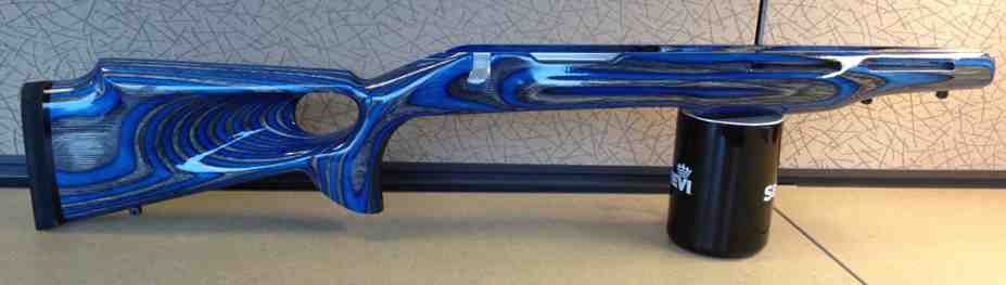

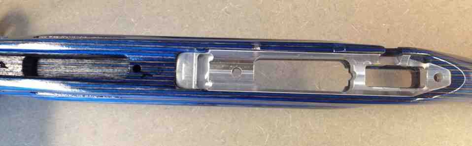

The Revolution "Apache" stock arrived today. Here are some close-up pictures of the stock and the aluminum bedding system.
Overall, the finish looks amazing. I'll get the action installed tonight and follow-up with some more pictures and a review on the fit.

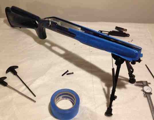

The new stock is cut for a sporter barrel contour. As anticipated, its going to need some in-letting. Time to break out a dowel with sandpaper...
Or, I could have my gunsmith install a thicker recoil lug so as to rotate the barrel so that the tactical fluting rests over the wood.
Nah, let the sanding and shaping begin!

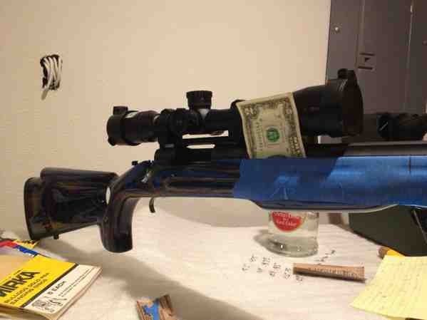

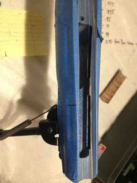

The inletting is almost done. It's free floated from the recoil lug all the way up to just about 3/8" from the end of the beaver tail. I'll finish it up the sanding tomorrow and then apply a quick clear coat to seal up the wood.
Inletting is complete, though I think I may skim bed the action before I do the final clear coat. The barrel is completely free-floated.
Deep well sockets make great sanding blocks as they have uniform dimensions, and come in many sizes for shaping the wood to match the barrel contours. I also used a toilet plunger handle to get a start. Working with wood is such a treat.
Anyone know the significance of the two dollar bill?

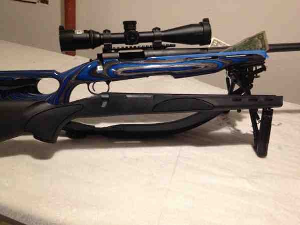

Here are a few pictures of the bolt in the action and factory stock.
I did a little inletting in the bolt cycle path and am now applying the final clear coating.
The bolt lever just clears the scope and open the cover on the first cycle.

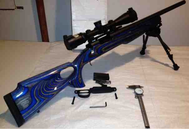

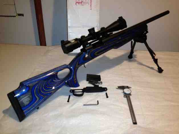

Here's the action in the new stock. I'll be heading to Colorado next week and will get an opportunity to break this in. So excited...
Full aluminum bedded chassis...
