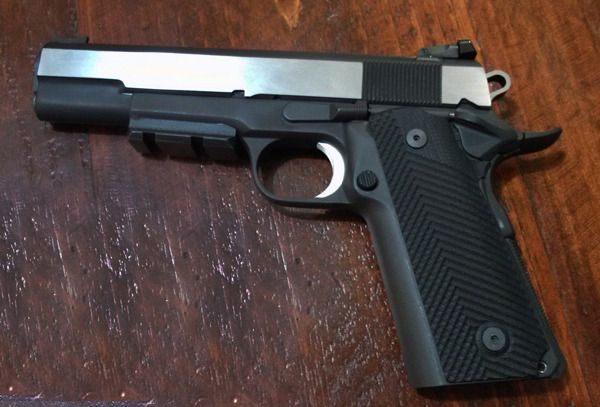

I was born and raised in Hungary, and this RIA my first built 1911.The reason I mentioned Hungary, because the engraving will be an ancient Hungarian.
It has a TCM 22, 9mm, and 7.62X25 barrels.
-Gun Craft Para Trigger,EGW's older/discontinued "Silver Line Ignition Kits"
-Commander style hammer, hard sear, long disconnector, and Colt sear spring
-Dawson Precision RIA .100" wide fiber optic front sight
-7.62X25 barrel
-VZ Grips' G10 laminate stock
-milled down the original engraving
-Rail welded, and screwed down for laser
-I am waiting for an Ancient Hungarian Runic Writing engraving, and
-the FDE Cerakote . I will post more photo when it will done.

Have you had a chance to run it much in 7.62x25? Maybe its the rock I live under, but I have never heard of running a 1911 in that round. Really neat little round, interested in hearing how the 1911 likes the bottlenecked round.
