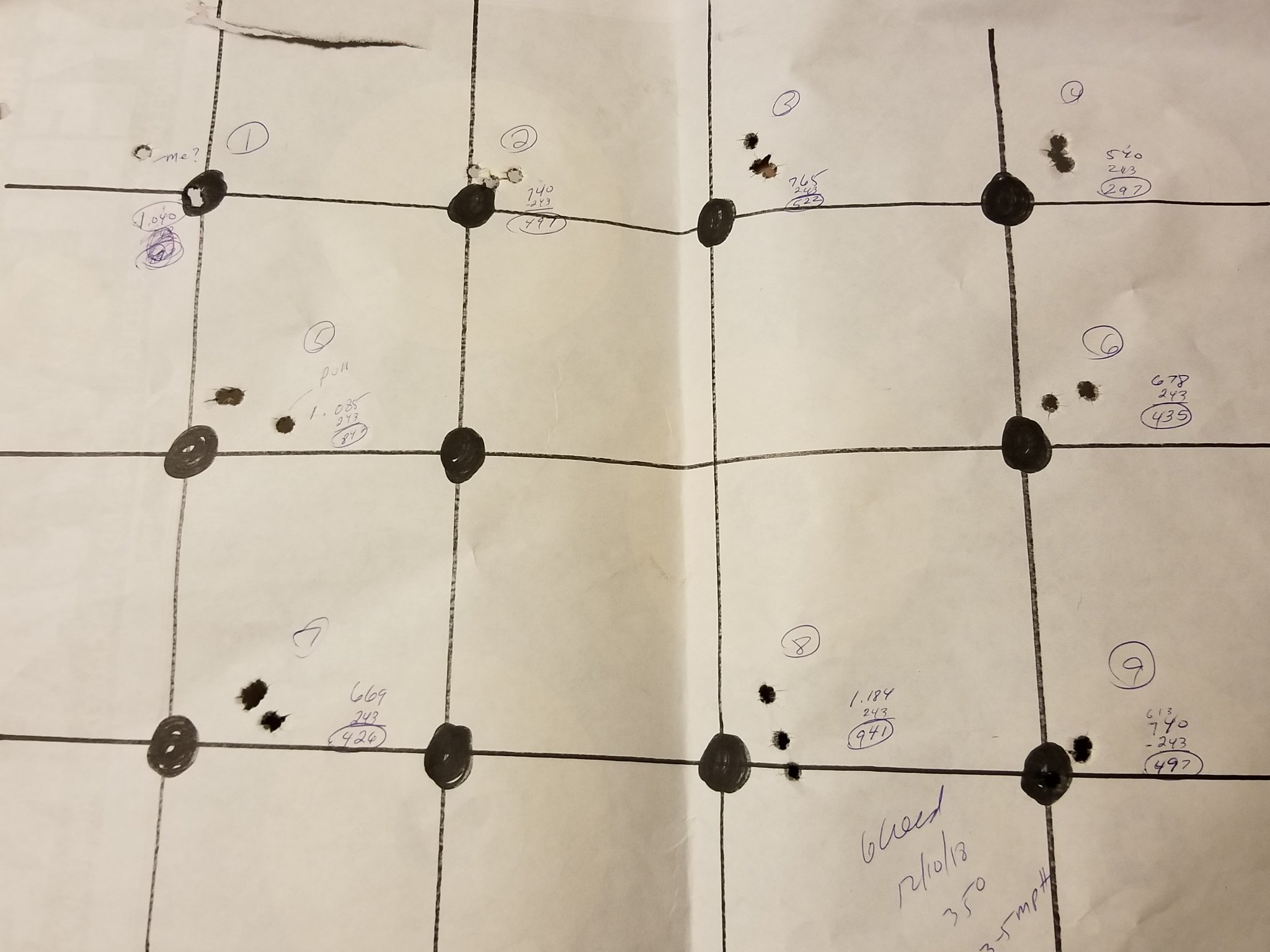

Just picked up my first Ruger RPR in 6mm Creedmoor because i found a great deal on this one. My original intention was to rebarrel to 6.5 cm because I didn't have any loading gear for 6creed yet. Setup is completely factory with a Leupold 8.5-25LRP, AAC SD 7.62. I bought 50 brass and gave it a try. All I can say is that I am impressed...
First target shot for load workup is above. Using Hornady 105 bthp and h4350. Showing a node at load #3 which was h4350 38.5 gr. Not looking for speed just sheer accuracy.

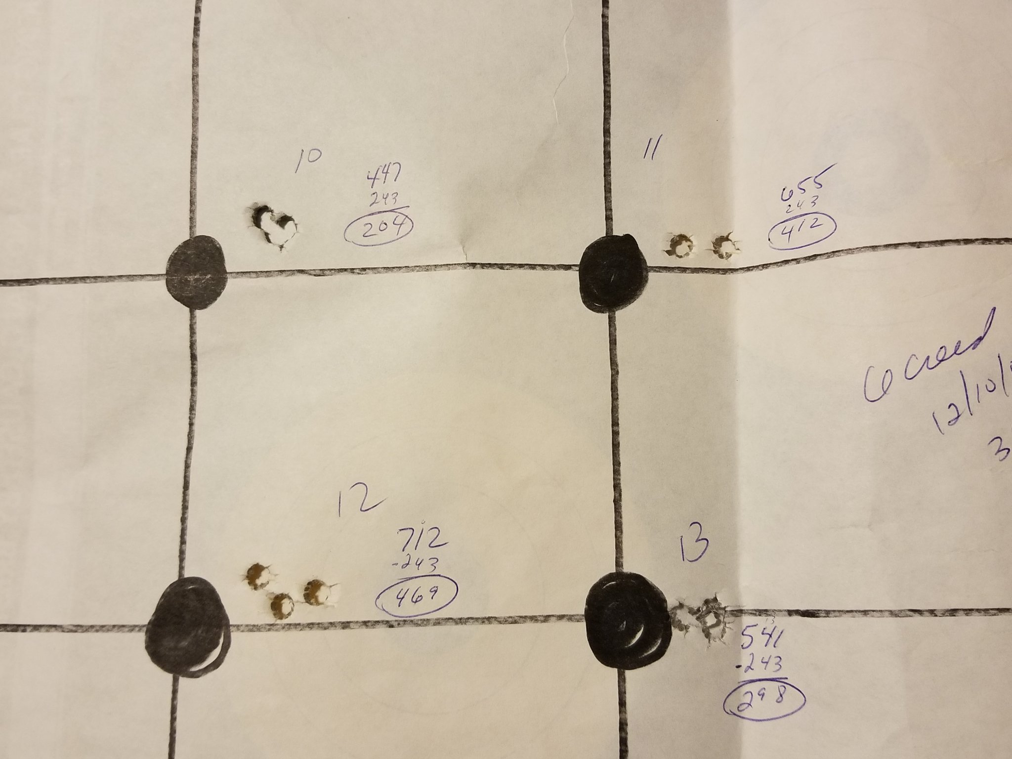

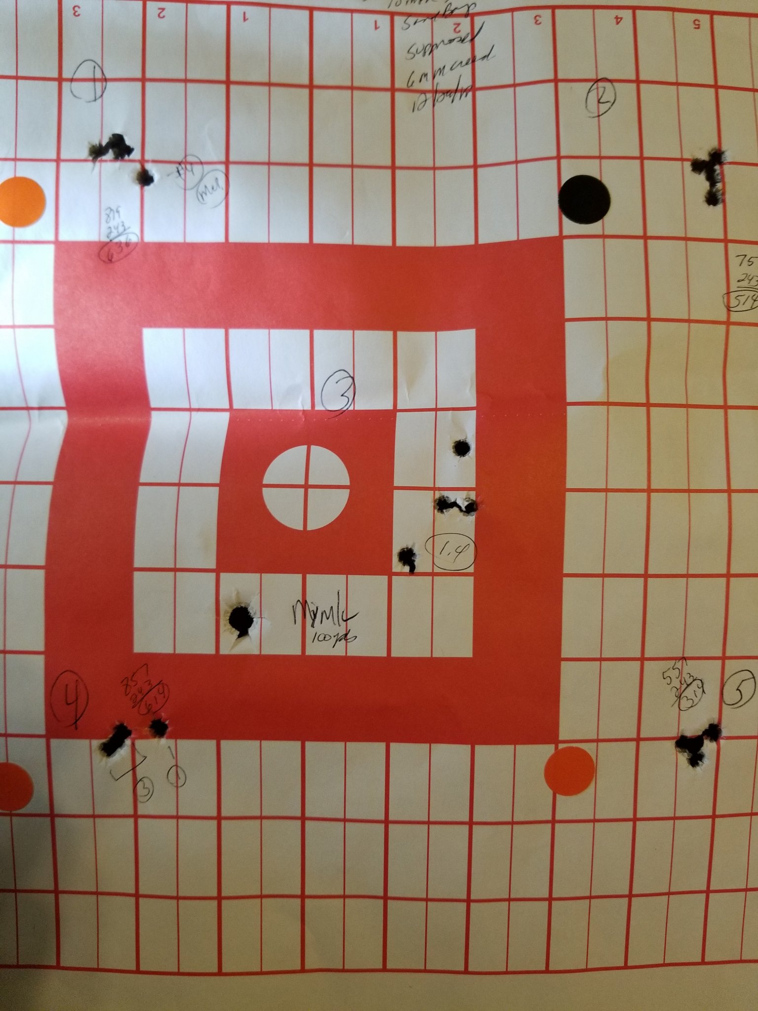

Below is the next set of targets out. Replaced scope with a Leupold 8.5-25 LRP. Again showing the node at 38.5 gr. The pic below that is with Sierra 107s and h4350. Found the magic juju with this combo. The groups are tight, little vertical and the node is wide. Shot this target 30 degrees aff sandbags. No chrony this day. Just too cold.
Can't wait to get it back out. Sticking with the Sierra's now. Bottom target is 39, 39.5, 40, and 40.5 great h4350, win primers, Hornady brass 1x at 2.790 coal.

That last target was with Sierra's. This is the target that shows great promise. Left to right h4350 39gr, 39.5gr, 40gr, and 40.5gr. Winchester large rifle primers, Hornady brass 1x fired trimmed to recommended length (can't recall right now) and 2.790 coal. Will definitely post updated info soon

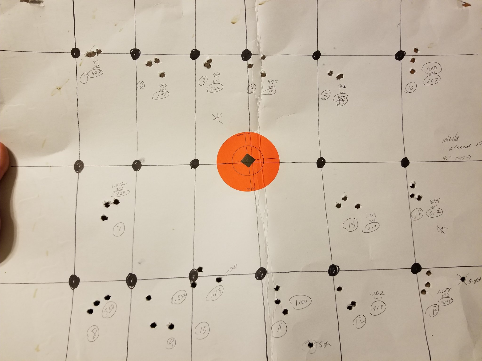

Nailing down a load. The Sierra's group better than the Hornady. The bottom two groups consist of H4350 with 39.0 and 40.5 respectively. .614" and .314" respectively. The lower left is a tight group and the one out of the group was my fourth shot I would call a choke. May go with this load to save barrel life. Again no chrony this day. No concerned with speed just accuracy. next step depth test with Sierra 107 and 39.0 gr h4350
Had an opportunity to shoot today. Reshot 2,4, 5 with results below. Looks like Sierra 107 with 40.5 gr h4350 is it. Yesterday's 4 shot group .314" and today .210". I don't think a depth test will improve much but may give it a go. Next up is a 6x5.

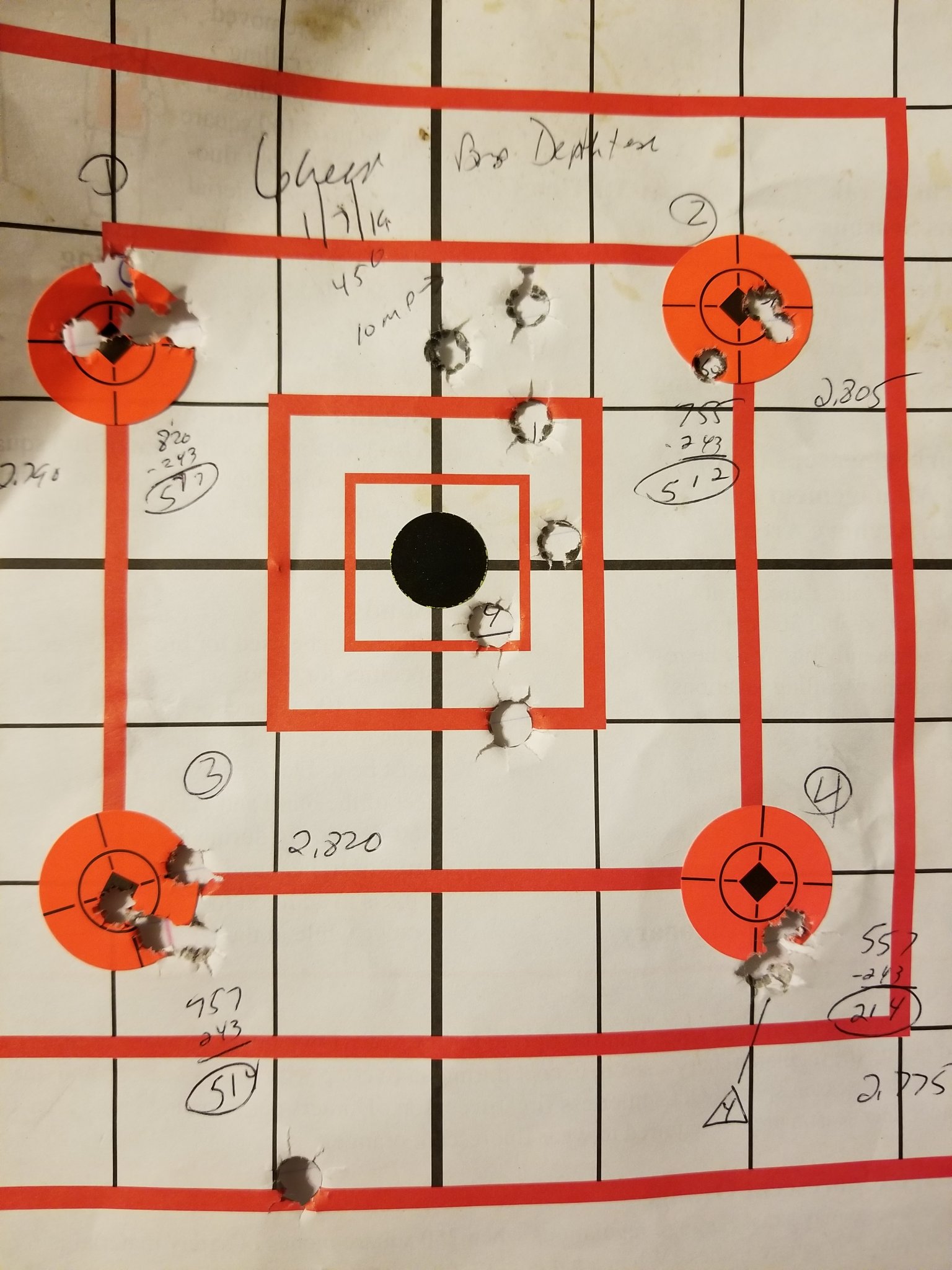

Working on my depth test. Each of these are 4 shot groups. Seems to prefer more freebore. Still need to get it out more but def shows more promise than I could've hoped for. Groups 1-4 are the RPR. The middle group are sighters for another gun.
Reactions: laserlite
2.820" is the longest I've tried. I didn't run into any indication that I was in the lands that day. Seems to be preferring a bit of travel as 2.775 shows promise.
