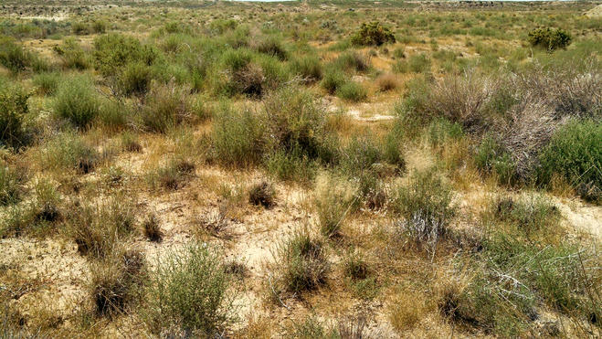

Lots of desert here at the Zia Range in Albuquerque.
This is a stock photo off the Zia website, but those innerds could be under any sagebrush.
I hope we can locate those baffles.....someday!

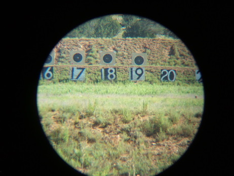

Psyops did look the day that it happened and walked out to the 762 yard target. IT sounds like the baffles must not be inline with the target. A wider search will take some time.

I got out to Zia, the range where Psyops baffles lie (unless someone already found them and disposed of them). I was able to search for about 30 minutes during cease fires.
The first ~100 yards of his shot path are easy to search. It is flat dirt and dirt berms. This is what most of the rest of the 660 yards looks like.
Psyops, I , and several others have been searching. I focused today on the 100-250 yard distance in the area that the picture was taken. No luck so far.
