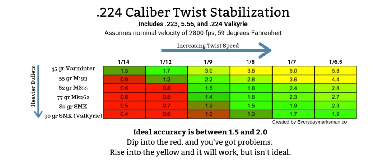

I have an M4 clone from PSA that I'm thinking of replacing the 16" 1/7 twist barrel with an 18-20" barrel but I seem to be hung up on keeping that 1/7 twist.
I see Wilson Combat barrels and others with 1/8 twist, but...
Not planning on shooting the light bullets out of this one. This one's for PRS-style gas gun matches with 69gr plus pills.
20.5" is the max for the Quantified Performance middle category. I'm not good enough to shoot open class. Heck! I'm not good enough to shoot the middle category, but ya gotta get better somehow.
So y'all think that a 1/8 twist is plenty good enough to stabilize 69gr to 75gr bullets?
M
Yes. The last 15 or so barrels I've had have been split pretty evenly between 7 and 8 twist, with a 7.7 in there too. I can't find any correlation between barrel twist and, well, anything really. The better barrels shoot better regardless of twist or bullet weight. The bad barrels don't. On top of that, all the 7 twists shoot QUALITY 55gr bullets great, and the 8's have never had a problem with 75-77gr bullets.
Edit: just checked the twist on my shortest barrel I've bothered shooting at distance. It's a 13.7" with an 8 twist that only pushes 77's to 2475ish fps, and it shoots very well out to the 720 yards I've tried it at, 850' ASL FWIW.
All right. I'll stop stressing about the twist rate between 1/7 and 1/8.
